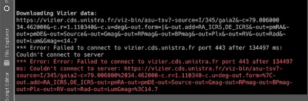

http://vizier.cds.unistra.fr/ is currently down, which means that PixInsight cannot solve.
I'll make sure pending AstroBin images solve automatically without you needing to do anything once Vizier is up again, which I hope is tomorrow (!)
Thanks for your patience!

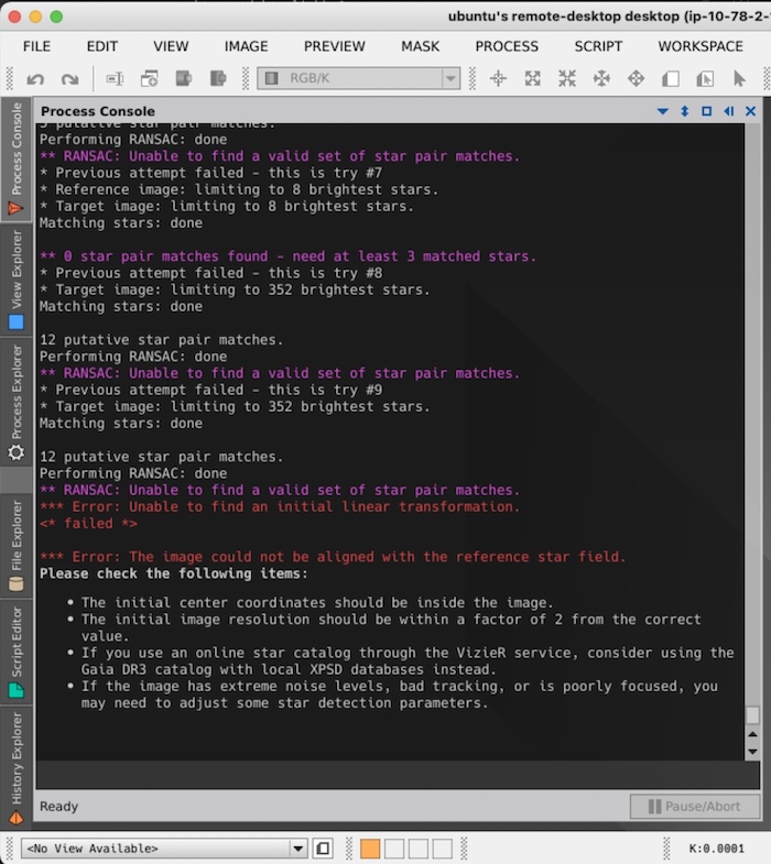

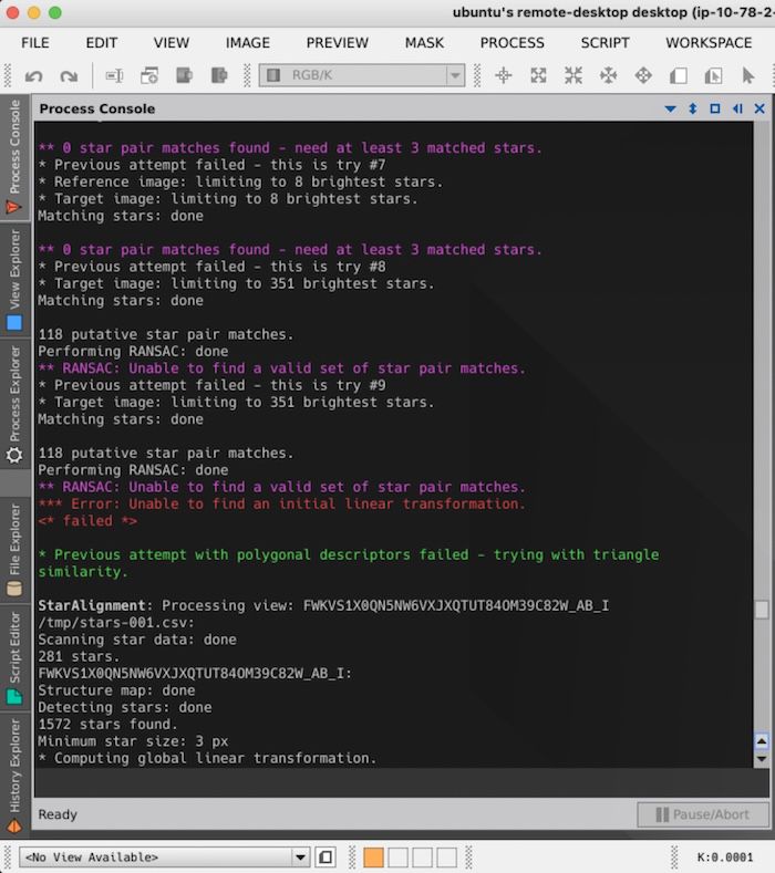

@Francesco Meschia  (and mentioning @Joachim Stingl who is having the same problem),
I don't really know what to do with this one, seems like PixInsight just doesn't like these particular images of yours (log will follow at the end of the message).
The only card I can try playing, which I can do this week, is sending a higher resolution version to PixInsight, in case subsampling makes it more likely to fail this way.
I'll keep you posted!
(Unfortunately I couldn't copy/paste from the remote session, so here's two screenshots of relevant parts of the log)

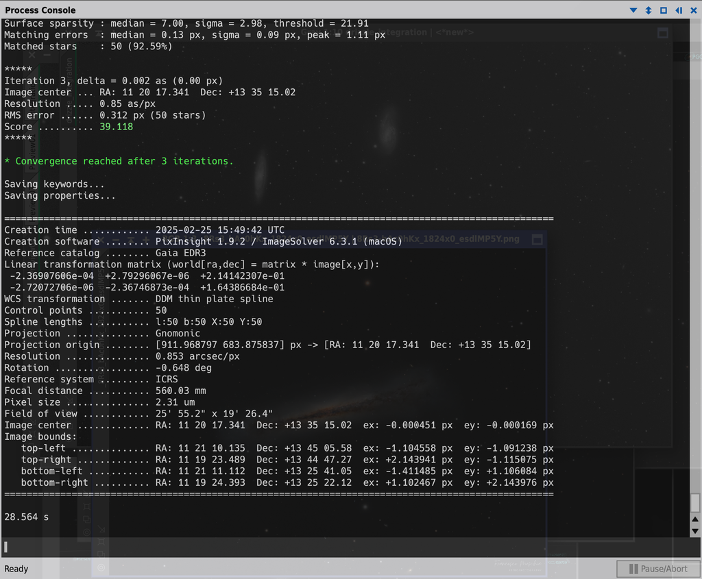

Can you see if this solves:
https://cdn.astrobin.com/thumbs/8Rs3-bAc0hKx_1824x0_esdlMP5Y.png
by seeding this information:
RA = 170.072000
Dec = 13.588000
Pixel scale = 0.853947
frankz 4.07
I just ran it, it solved just fine:
siovene
Then we reached the end of what I can do. We need to reach out to Juan Conejero to see if he can help. Btw what version of PI is that?
frankz 4.07
Thanks for trying, this is really a good mystery.
Good point about the versions. PI is 1.9.2 build 1633, and the version of ImageSolver is 6.3.1. Running on macOS.
Oh by the way: I don’t know if you can see it in the logs, but yesterday (or the day before yesterday depending on the time zone) I did get an advanced plate solution for a revision of this image: https://www.astrobin.com/j6gvmr/K/. Unfortunately I didn’t keep it because of issues with the content of the image itself, but it did solve...
