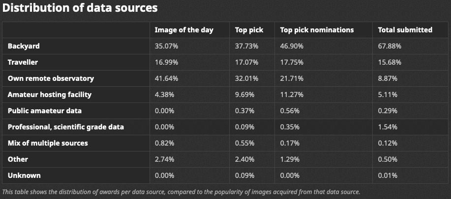

your statement is WRONG!
You show absolute numbers and you neglect the fact that far more images are submitted by "backyard" category (67.91% compared to only 8.86% of "own remote").
Here is the correct calculation (without fancy graph): (67.91 / 8.86 ) * (41.64 / 34.79) = 9.17
A correct statement:
*** It is 9.17 times more likely to receive IOTD when imaging from "own remote" compared to "backyard". ***

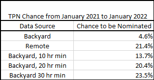

I can see where you are coming from, but just because an image is submitted it does not speak towards the quality of the underlying data. What I am trying to do is control for that.
I can take a picture of Orion, right now, with my Iphone, upload it to astrobin and submit it to the IotD, and it will count as as backyard image. Should we really be surprised that backyard images do not do well in comparison to remote images with this in mind?
I am trying to point out that backyard images buoyed by quality data have just as good of a chance to succeed as remote data. I am also saying that getting quality data from a backyard is readily achievable.
Your data is in absolutes, while I am trying to control for the underlying quality of the acquired data. In that respect I believe that is why my data paints a different picture. My method is by no means perfect, but I think it is better than dealing with absolutes.

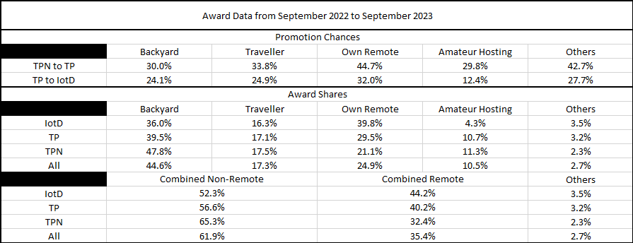

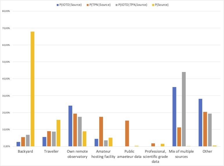

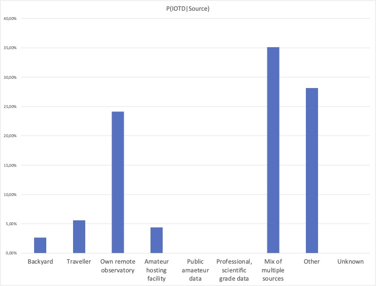

The computation from @JohnHen leads to the correct mathematical result. I've taken the IOTD statistics of today (Nov. 28th 2023):  Using Bayes statistics (details at the end of post), under the assumption that each image has the same prior probability of becoming IOTD, we get the following probability distribution of achieving IOTD given the source:  The numbers aren't fully resolved on this but the ratio of "own remote observatory" and "Backyard" is about 9 times. W.r.t. to the IOTD discussion, I have nothing to add to my previous posts in other threads. Björn About the statistics: P(IOTD | Source) = P(Source | IOTD) * P(IOTD) / P(Source) P(Source | IOTD) are the values found in the column "Image of the day". P(Source) are in column "Total submitted". The prior P(IOTD) is unknown but a constant and hence through normalisation of the probability distribution, we can compute P(IOTD | Source).

About the statistics: P(IOTD | Source) = P(Source | IOTD) * P(IOTD) / P(Source) P(Source | IOTD) are the values found in the column "Image of the day". P(Source) are in column "Total submitted". The prior P(IOTD) is unknown but a constant and hence through normalisation of the probability distribution, we can compute P(IOTD | Source). Bjoern, thanks for taking the time to put the correct numbers into a nice chart! CS, John

This does not paint the full picture. @SemiPro posted another analysis here on in a different thread, that showed what are the chances of an image advancing once it's made it to Top Pick Nomination. This criterion was used because making it to TPN equalizes the field a little bit, as it requires a minumum of technical excellency.
The data showed that after an image has made it to TPN, it's chances to proceed to higher award are almost the same between backyard and non-backyard. From memory, it was 70% vs 78%.
