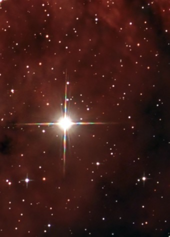

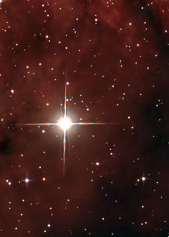

In the following two screenshots of your Sard, one from the file you uploaded and that AstroBin didn't touch (I can access it as an admin) and the other is the version displayed by AstroBin when looking at your image in full resolution.
Personally, I cannot see a difference. Both images are around 19 MB in size.
Screen Shot 2024-09-02 at 10.30.41.jpgScreen Shot 2024-09-02 at 10.30.50.jpg
If you refer to smaller version of your image, such as the one displayed on top of your technical card, AstroBin of course resizes that for deliverability reasons. But you wouldn't expect AstroBin to serve a full resolution image with a huge file size only to display it in a small space, which would be wasteful.

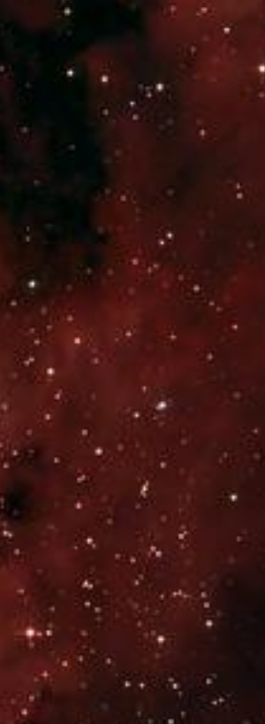

Thank you all for your advise.     That's surprising it did not show up when you examined the image.  I'll try saving images at 95% vs 100% quality, and save at PNG as well.  Here's a copy of a section of the image enlarged.  I'm Not sure how to even label these artifacts.   Thanks

Hi Judy,
it looks like you're viewing your image in the revision slideshow, which does not support full resolution display. This is being improved in the new image experience that's currently rolling out on the search page, and will later reach all images and galleries.
To view a revision in full resolution, click on the "link" icon on the top-left when you're viewing a revision in the slideshow viewer. That way you will access the revision's page proper, and you can click it to view it in full size.
Sorry if this is a bit confusing! There's a reason I'm cleaning up this part of the UI smile
