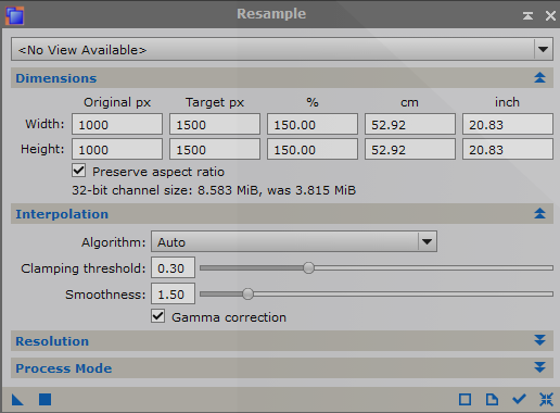

I thought it might be. Does anyone know how to change the resolution ie resample in Pixinsight?
Harry Karamitsos:
Process>Geometry>Resample
hkara 0.90
Thank you. I kept going to image\rescale which didn't do what I thought.
