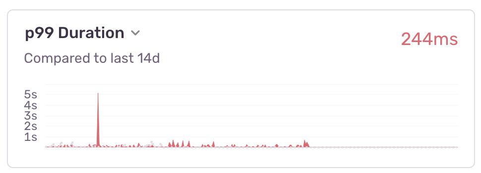

BTW it took 3 minutes to load this page after clicking the thread link from the Home Page.
Then this has nothing to do with the new UI. The forum is still unchanged, and has not been affected by any UI changes or infrastructural changes whatsoever, in a long time.
If it takes you 3 minutes to open a forum post on AstroBin, there must be something wrong going on with your network or your computer. Can you try a different device to isolate whether this is a computer or network problem? Is your computer up-to-date with software updates and has it been rebooted recently?
99% of forum pages open faster than 244ms on AstroBin:
