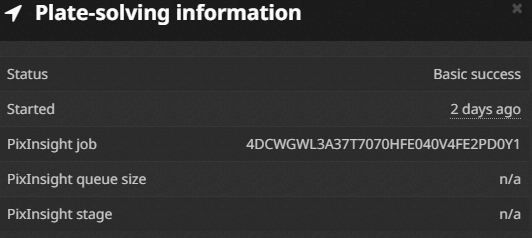

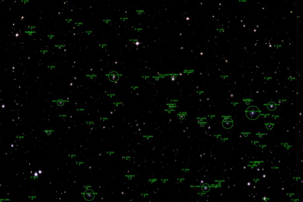

Apprx. 2 days ago I uploaded a retouched image of the Markarjan chain with a part of the Virgo cluster and other galaxies.
Standard plate-solving worked fine, but extended astrometry is active since 2 days.
Is it normal plate-solving with many deep sky objects taking THAT long?
I wanted to process this image:
https://www.astrobin.com/shwi18/B/
And tbh I´m not a pro with astrometry, but a simple beginner taking astrophotos with a simple DSLR and tele-lenses.

Still no result although I edited some of the settings and restarted again and again.
Basic astrometry working fine, extended not….
In the meantime I uploaded a few retouched versions of other images which worked fine.
Seems, Markarjan and Virgo don´t want to be astrometered via me… ;-)

I can see the same problem, after 10 days it still didn't finish.
https://www.astrobin.com/dy4yqx/
siovene
Hi @Joachim Stingl and @Vroobel,
I took a look and the job is running to completion for your images. However, for those that you mentioned, it's simply failing due to star detection not working out.
Please this FAQ entry here for an explanation:
https://welcome.astrobin.com/faq#failed-plate-solve
In the last paragraph it mentions the option to upload a sample frame that might help with the solution.
