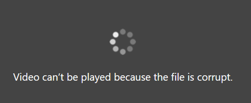

Your video however, doesn't play. When I right-click it and "Play video in new browser tab" I get the following message:
So maybe try different render parameters - your video is over 300MB which might be part of the problem.

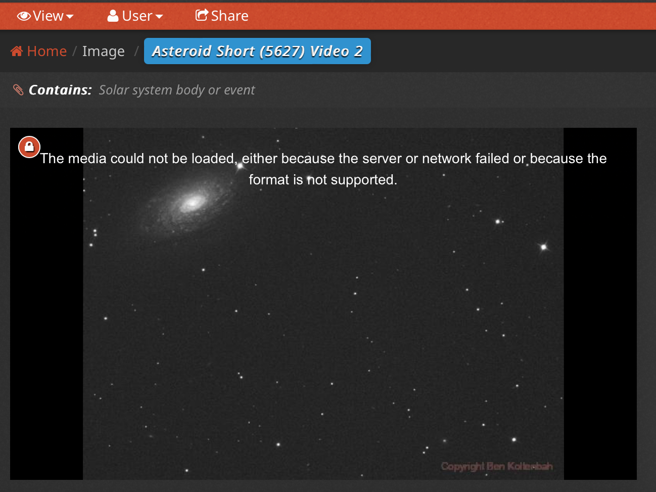

For what it’s worth, it does not play for me either however I’m on my iPad which pretty much always plays videos. Here is a screenshot of the error I’m getting.
BTW, Barts video loads and play immediately when I watch it.
