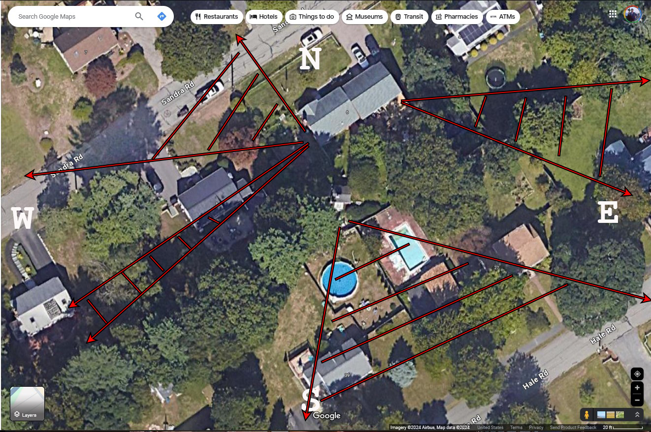

I downloaded the new update and I can tell you the 5 positions for polar alignment is huge for anyone like myself who has trees in their yard.  From my deck I can see the north and northwest and the zenith so could polar align (PA) there but in the south corner of the yard where I can see from the SE to S to SW there is a large pine tree that starts at the zenith and covers from the SW past W to the NW.  The Seestars normal PA would point the scope to the west of the zenith not much but right into the pine tree and it would just sit there and I couldn't do a PA.
    With the new update I decided even though it was cloudy out i would see what would happen when I tried it.  #3 was just like the normal PA and aimed into the middle of my tree and just sat there.
     So I tried number 4 to see if that would clear the tree, nope.  so 3 and 4 won't let me do a PA.
Next I tried #2  and it moved the scope lower in dec by about 20 degrees (a guess) and rotated to the SW and it cleared the tree so would do the PA, #1 went even lower in dec and would clear the pine but would in the 3rd position it would point to a neighbors tree.  So #2 would let me do a PA.
    Just for the heck of it I tried #5  and it went to the north of the zenith by quite a bit and would clear the pine but would hit a tree to the east.
the bottom line is that I will be able to do a PA with number 2 only.
The test was just to see what the Seestar did when I hit each position and now waiting for a clear night to see how it actually works but it looks like it will let me do a PA in my restricted space.
Since I didn't actually observe I don't know about anything else from the update.

Jeff Padell:
