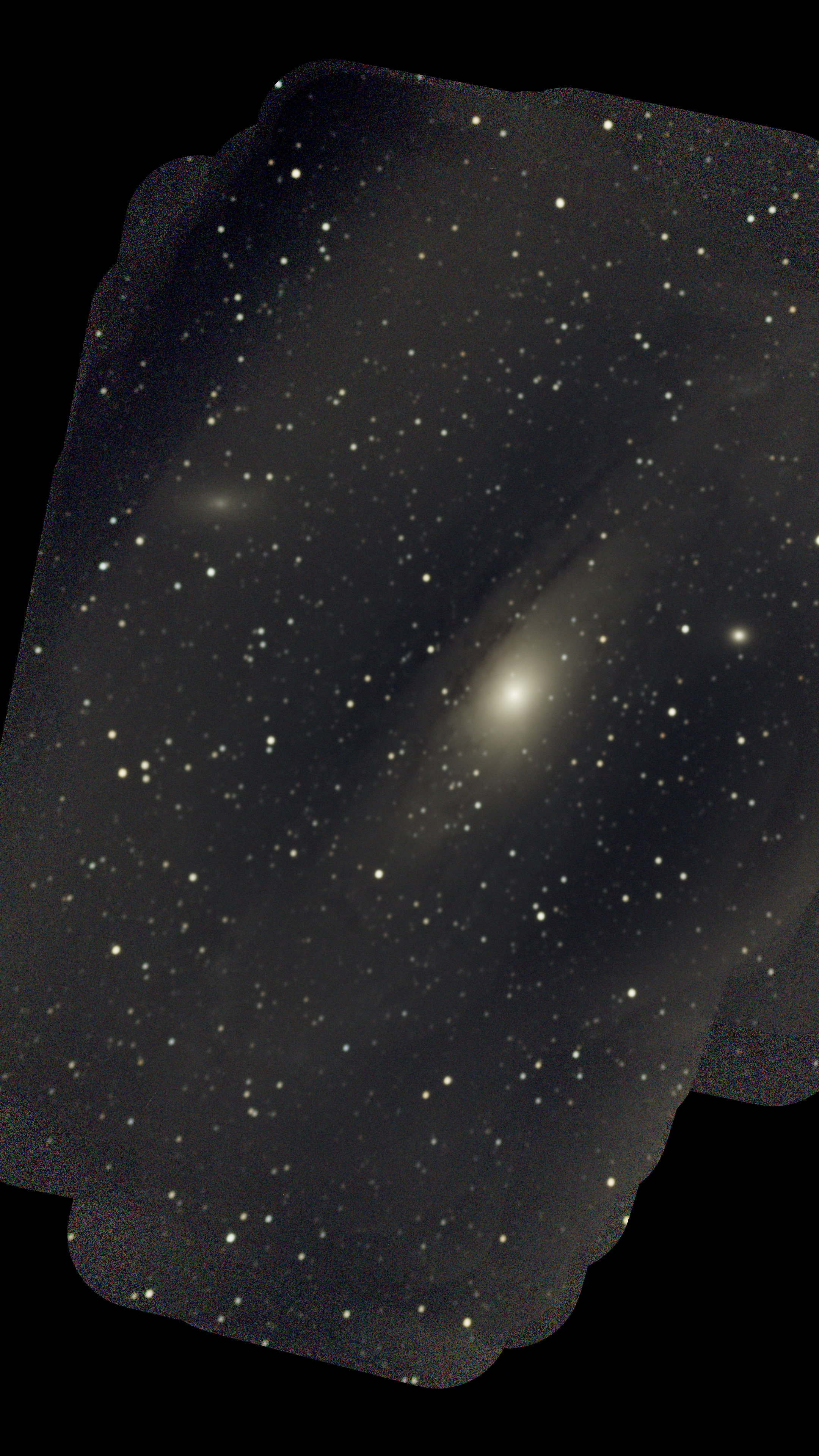

Unfortunately it is (as far as I see) not very detailed documented. The S50 scans the selected area with stacking of a few (ca. 1 min.) pictures, then it moves to the next position (witch a lot of overlapping) At the end you get pictures like this: ![1731621206279[1].jpg](https://cdn.astrobin.com/ckeditor-thumbs/148070/2024/305c1e7a-af8d-4b9d-9bfd-c52fc30e9d39.jpg) as you can see, M31 is not in the center. But in the frameing window it was. The framing windows is cut to the smartphone-screen. You see also, that the non overlapping areas lack in resolution (off course). The pitty is, that the fit-files are not stackable in Siril. Or has someone found a way to stack these framed fit-files? Btw: the name of "Mosaic" is in S50 is "framing" (found in Stargazing => StarMap => Framing (green rectangle on the right side) ) Andreas
Andreas Heertsch: Unfortunately it is (as far as I see) not very detailed documented. The S50 scans the selected area with stacking of a few (ca. 1 min.) pictures, then it moves to the next position (witch a lot of overlapping) At the end you get pictures like this:
as you can see, M31 is not in the center. But in the frameing window it was. The framing windows is cut to the smartphone-screen. You see also, that the non overlapping areas lack in resolution (off course). The pitty is, that the fit-files are not stackable in Siril. Or has someone found a way to stack these framed fit-files? Btw: the name of "Mosaic" is in S50 is "framing" (found in Stargazing => StarMap => Framing (green rectangle on the right side) ) Andreas Well, that sucks. If it cannot be stacked. Unless one of the popular astrophotography channels has made a video about it, for example, Deep Space Astro, aka Rich. Although I saw a video in which someone managed to stack these frames, only in Pixinsight did not watch it yet, but I saw that video. But unfortunately for me, I'm so new to that software yet. So I can only use Siril.
Szijártó Áron: Well, that sucks. If it cannot be stacked. If ZWO would mark all stacked fit's connected to the same view in their names eg. with a ascending #, it would be possible to stack every view by Siril and combine theses stacked views with Microsoft ICE. But ZWO did not.
