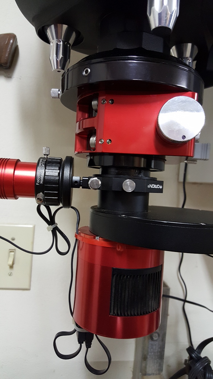

I can attest to the difficulty using this setup.  The only way you're ever going to achieve the proper back focus is by using the Orion Thin OAG.  I'm assuming that you're going to use the Celestron .7 reducer, correct?

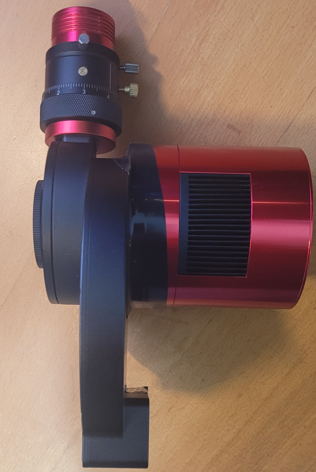

Here is a picture of my setup.  As I look at it the ZWO OAG should fit fine as you say.

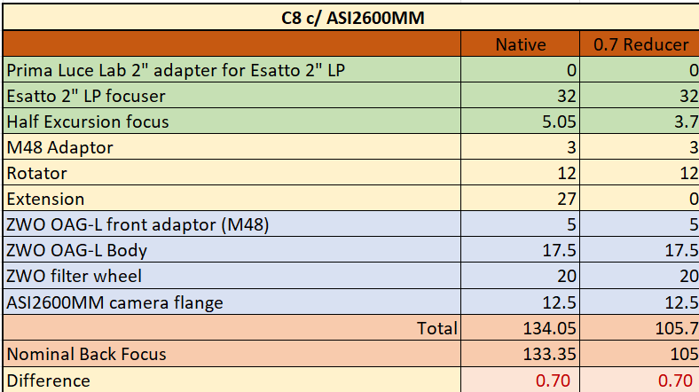

I have the EdeHD 8 as well.  I posted the following elsewhere recently which addresses your key question.  You'll see I have a rotator in the image train too.
Note that the ZWO OAG-L has the same size prism as the Celestron - I never have any trouble finding guide stars.
Here goes...
I had the Celestron OAG, which was great but too thick;  I changed to the ZWO OAG-L for use on my refractor which has a much shorter back-focus.  It stays attached to my filter wheel (36mm) and camera (ASI2600MM) assembly.  The whole lot just moves from one scope to another.  See photo below.
I've incoporated a Prima Luce Lab Esatto focuser into my image train so that I don't have to fiddle with the mirror once it's in focus.  Because it's behind the EdgeHD internal lens elements, technically I am moving the length of the image train forward and aft of ideal backfocus, but my calculations suggest that it is less than 0.1mm focus range (although I may be wrong here) which is likely immaterial.  Once I have initial focus as close as I can get with the mirror knob (using a Bahtinov mask), I'll then start using the EAF for autofocus; an initial run and then each time I change filters.
Here are my image trains for EdgeHD 8 at native FL and with 0.7 Reducer.  The 'half excursion focus' (language my supplier used, which is confusing but I kept it) is simply how far back I set the Esatto focuser as my starting point to achieve nominal backfocus.  Also, the Difference in actual vs nominal (0.7mm) accommodates approx 1/3 the thickness of the filters (2mm) which is the generally recommended backfocus adjustment for filters.
And the OAG-L with 36mm EFW and ASI2600MM (no tilt plate).  The black tape on the EFW/Camera joint and on the base of the EFW is to prevent light ingress during the taking of flats in the mornings.  The guide camera, once focused, never needs to be touched again.
I hope that helps a bit.
Cheers.
Paul

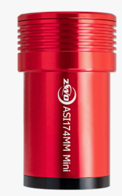

I use a very similar arrangement to what Paul describes.  I use the ASI 174mm as my guide camera.  To get guide camera focus the sensor on the guide camera needs to be the same distance from the OAG pick off mirror as the sensor on the main camera.  My guide camera is almost inserted all the way to the helical focuser.  If you are less than 55mm from the pick off mirror to your imaging sensor, you might need to add spacers between the OAG and you imaging camera to get the correct spacing.
Paulinho 5.01
Hi, Christian.
Like Keith, I have the ASI174MM mini as my guide camera.  It is inserted all the way in and without the need for a spacer (as per photo above).  The helical focuser is at position 4.2 (out of 6) on mine; plenty of room to adjust in either direction.

sadly that is not what I experienced. I was trying to find some info about the position of the sensor in different ZWO guide cameras but can't find anything with a quick search. We are talking of about 4mm difference here, which I find huge. Maybe I will try another cam as well. As previously mentioned, this is no issue when using the QHY 294M, because the backfocus distance is larger. Yesterday, I already put all the mechanical parts for the new scope together and installed everything. So I will try another guide cam later on.

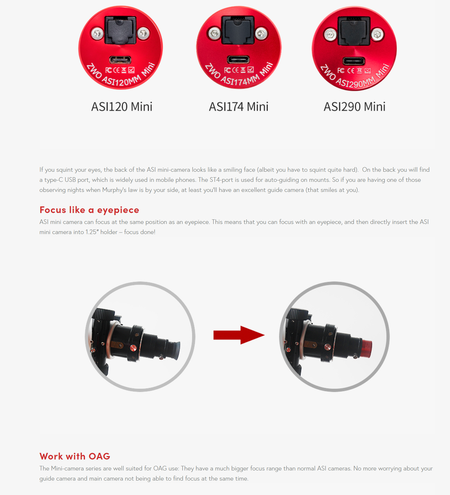

Paulinho 5.01
Hi, Christian.

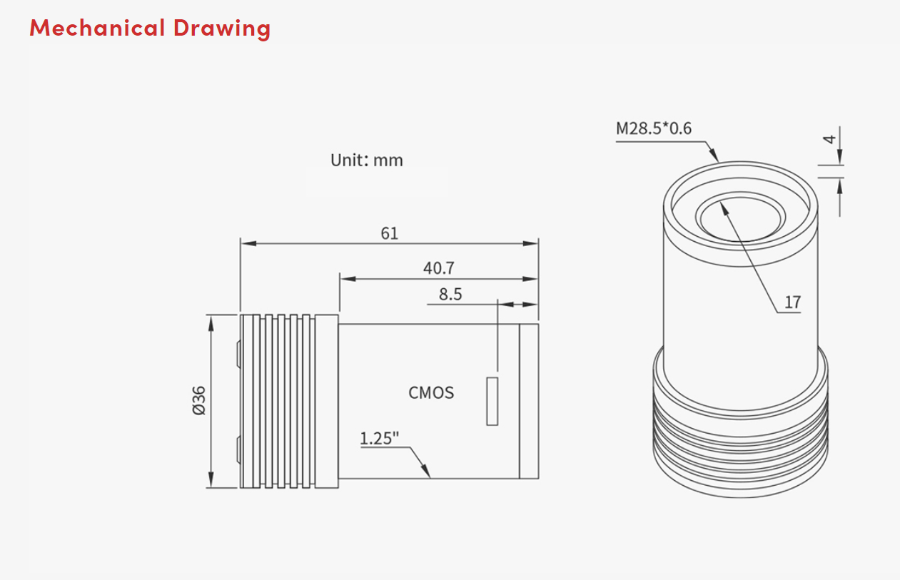

I found the following on the ZWO ASI website, here: https://www.zwoastro.com/product/mini-cameras/
It seems they all have the same distance to the sensor.  The drawing below indicates 8.5mm.  Maybe QHY is different, but as Keith and I suggested above, we have no problem focusing the ASI174MM (which by the way is great as a guide camera).
Naturally, this will change if you have the extender screwed on.  I use it with just the threaded cover, as per the drawing and photo at the bottom of this post.
Of course, one needs to have the imaging camera precicely focused before setting focus for the OAG camera.  Then once set, it is set and forget
Cheers.
Paul

If you have 6.5mm+20mm÷OAG, then you will be too short to get your guide camera in focus.  This needs to be about 55mm total for the guide camera to come to focus.

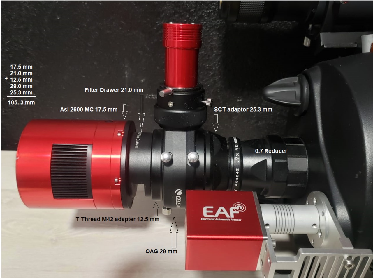

Leonardo-Ruiz 4.01
I show you an image of my configuration with the ASI 2600MC.
The guidance camera is very important. Initially I had an ASI120mm but it has a very small chip size (1/3") and I could barely find stars to guide.
I changed it for the ASI 174 mm (1/1.2") with a larger chip and I have no problems.

For my oag, either zwo oag or askar oag just work with 174mm-mini, with no vignetting on 2600 sensor. For me, it looks like guide camera is more important. Previously my 462mc failed although it's more sensitive, due to it's small pixel size.
