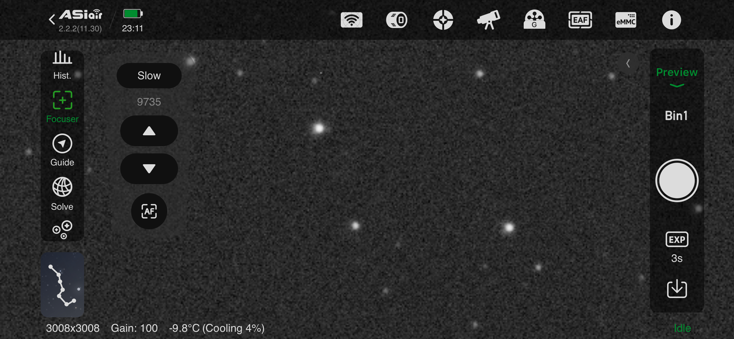

I asked this on the cloudy nights forum, but people are clueless. I never had an issue with autofocus for 3 years, but now suddenly I do. Here is the problem. This new scope - the SVBONY SV555 when it's out of focus it looks like a small central dot and a large halo around it. The size of the halo depend how far I am out of focus. This is when I turned the focus too far in from the actual real focus. If you ever used a DSLR camera with lens, you know what I'm talking about. People with camera lens understands what I'm talking about? Asiair picks up on that central dot as "focused". It doesn't matter how big the halo around it, it uses the central dot for measurement, it doesn't see the large halo around. Here is the real focus when I do it manually. Is there any technique to get around this issue or should I just go back to mini PC and NINA instead of Asiair?  |
I would drop your exposure down, I expect 3s is too long and the halo is being read as star brightness. Try 1s. If that fails, try reducing the gain as well.

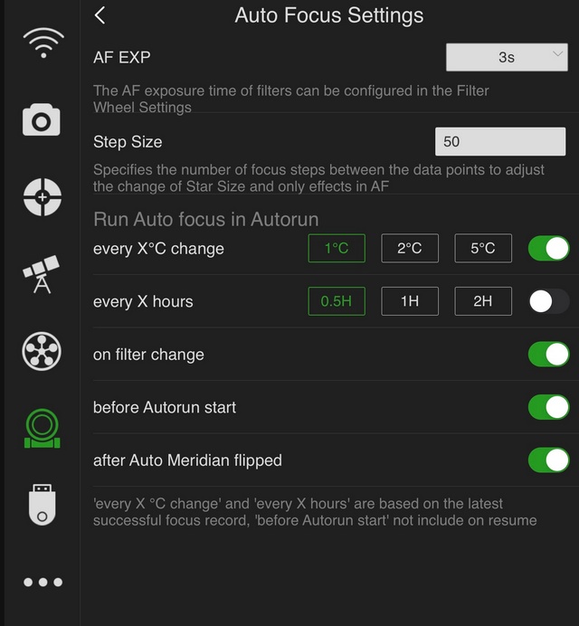

You say that this started with the new scope. I had no problem with my scopes focusing with the asiair and eaf, but when I switched to a camera lens for wide field it would not focus. I lowered my step count from 70 to 30 and that solved the problem.
Doug Crowe: You say that this started with the new scope. I had no problem with my scopes focusing with the asiair and eaf, but when I switched to a camera lens for wide field it would not focus. I lowered my step count from 70 to 30 and that solved the problem. This sounds like a good idea! I only tried increasing the step size, but that didn't work , I guess I should try to decrease it. For those people saying that my grub screws loose, I just put this assembly together literally before trying it out. All components are brand new. The only difference to my other scopes that the SV555 scope has a helical focuser and the EAF is belt driven, from an EAF bracket under the scope.  I never used a system like this before, but I do know I made sure that everything was tight and the focuser would move the telescope helical focuser around.

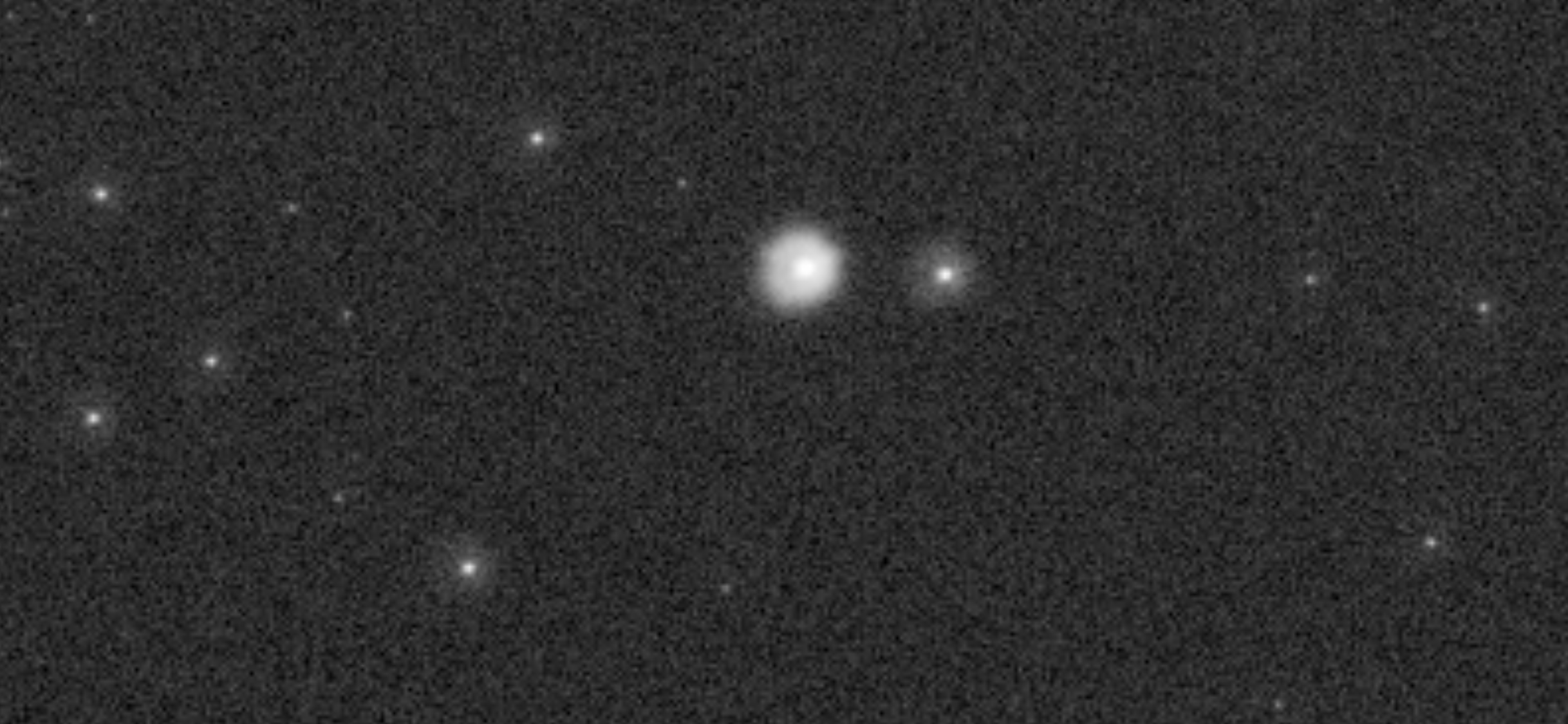

Thinking about it, when stars are out of focus in any of my scopes they are big, circular orbs of relatively uniform brightness. I have never seen a halo around a central disk like you have shown. My guess, based on this, is that the out of focus star shape is a function of the scope and the air doesn't know how to deal with it. I wonder if that new Askar55 does the same thing. Maybe try picking a smaller star to focus on by clicking on it?
Thinking about it, when stars are out of focus in any of my scopes they are big, circular orbs of relatively uniform brightness. I have never seen a halo around a central disk like you have shown. My guess, based on this, is that the out of focus star shape is a function of the scope and the air doesn't know how to deal with it. I wonder if that new Askar55 does the same thing. Maybe try picking a smaller star to focus on by clicking on it? ...Or shortening your autofocus exposure length if you have an extremely bright star in the frame perhaps?
Thinking about it, when stars are out of focus in any of my scopes they are big, circular orbs of relatively uniform brightness. I have never seen a halo around a central disk like you have shown. My guess, based on this, is that the out of focus star shape is a function of the scope and the air doesn't know how to deal with it. I wonder if that new Askar55 does the same thing. Maybe try picking a smaller star to focus on by clicking on it? I'm not sure, but since I was using a 533mmpro camera with RGB HaO filters (5 filter wheel) and I know for sure that those filters (Optolong filters) work good on all my other telescopes and with Asiair. So the camera+filters is definitely a tried and working combo, so it comes down to the lens itself. This is my first experience with a helical - Petzval telescope and I'm getting suggestions from many people - one recommending to drop the step size and drop the exposure time, others saying the opposite. I also want to try out using an OSC camera and see what happens. Anyway, good thing that this is my secondary setup, so I actually had my main imaging rig running while I was tinkering with this new rig. Also I tried to blame the atmospheric conditions, but my other rig with the OSC camera and RC scope shown no sign of star halos or high clouds running and imaging at the same time when this was running.

It sounds like the ASIAir software is selecting the centroid (similar to autoguiding) instead of determining the half flux diameter (HFD) of the stars. 🤔 Is this all that's available for adjustable settings?  Edit: If it's stuck using the centroid, I would definitely lower the step size so it's not skipping past the actual focus while searching.
I had similar problems when I bought a new scope - my ASIair/ZWO EAF, which had never failed before, would fail to find the focus point. I fixed it by adjusting the autofocus coarse step size using trial and error, concentrating on the shape of the AF curve. Make sure that curve is a smooth U shape. If the coarse step size is too small, the samples will just go up and down randomly due to seeing variations but the ASIair will calculate a fit curve anyway, and give you an erroneous result. If too large, the ASIair cannot accurately calculate the correct fit curve resulting in a significant error. I hope this helps!

I think that what you're seeing is the diffraction near focus. Have a look at this article. https://www.telescope-optics.net/diffraction_pattern_and_aberrations.htmFigure 94 shows the issue. The longitudinal cross-section shows the star profile when focus is changed. The centre of the figure is at best focus. At this point, the star profile is somewhat wider than the central part of the defocused star image. This is because light goes into the side lobes (a ring in the cross section star profile). The overall star profile is of course wider when defocused. In essence, this is a software issue, or rather, a flaw in the implementation of how the star profile is to be interpreted. The reason why it doesn't show up in all imaging systems has to do with additional aberrations in the optics, and probably imaging conditions. Wim
Wim van Berlo: I think that what you're seeing is the diffraction near focus. Have a look at this article. https://www.telescope-optics.net/diffraction_pattern_and_aberrations.htm Figure 94 shows the issue. The longitudinal cross-section shows the star profile when focus is changed. The centre of the figure is at best focus. At this point, the star profile is somewhat wider than the central part of the defocused star image. This is because light goes into the side lobes (a ring in the cross section star profile). The overall star profile is of course wider when defocused. In essence, this is a software issue, or rather, a flaw in the implementation of how the star profile is to be interpreted. The reason why it doesn't show up in all imaging systems has to do with additional aberrations in the optics, and probably imaging conditions.

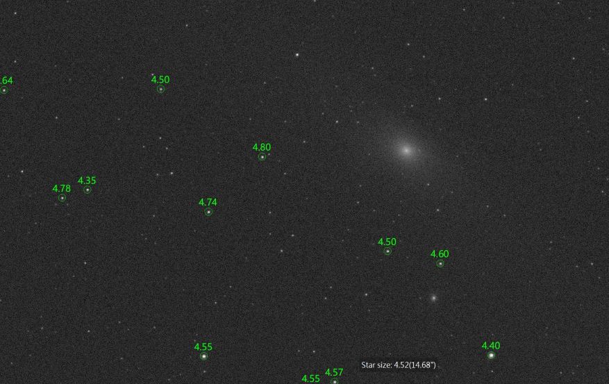

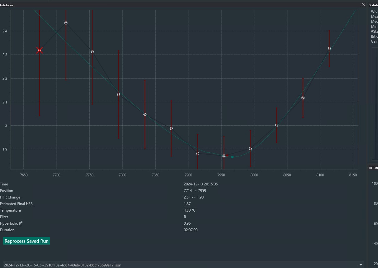

I tried using NINA and hocus focus. To me, this is start to look like a scope problem, not a focuser or Asiair problem. I'm not even sure what's up, to me the stars appears to be bloating at focus point anyway.   Anyone interested in a test fits file with the best focus via NINA then see the attachment and let me know what you think: https://drive.google.com/file/d/1xwoPPsQloW4IjU1YtB9AOQIevnmOf09T/view?usp=sharing |
