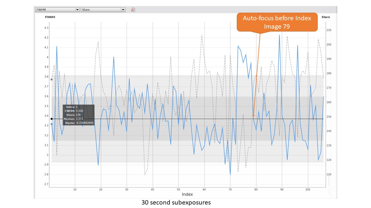

I tested a configuration yesterday using:
  • Explore Scientific ED127
  • ZWO EAF (the newest version that gets power from the USB connection)
  • Canon T2i
  • ASIAir Plus
Everything worked exactly the same as if I was using my ZWO ASI294MC Pro camera. I used the autofocus routine to achieve focus before starting any capture, and configured the ASIAir Plus to do an autofocus after every hour. I captured over an hour of M34, waiting until the 1-hr autofocus had been completed before stopping the capture. I had some cloud come over, and the wind was starting to pick up, so I rejected any frames with excessive eccentricity or really low PSF signal strength. In the attached SubframeSelector graph, so that you see any potential focusing outliers,  I did not reject anything based on FWHM, which I usually do to eliminate poorly focused subs. I inspected all the images with FWHM greater than 3.8 and none of them was bad enough to warrant rejection.M34 Capture Nov 2nd.jpg

Thanks so much for running your test session, @Chris Ashford! Those look like great stars, and the graph was really interesting. I guess I was just concerned about the software, since DSLRs don’t take FITS files natively, AFAIK. But from everyone’s responses, it looks like it should still work fine.
