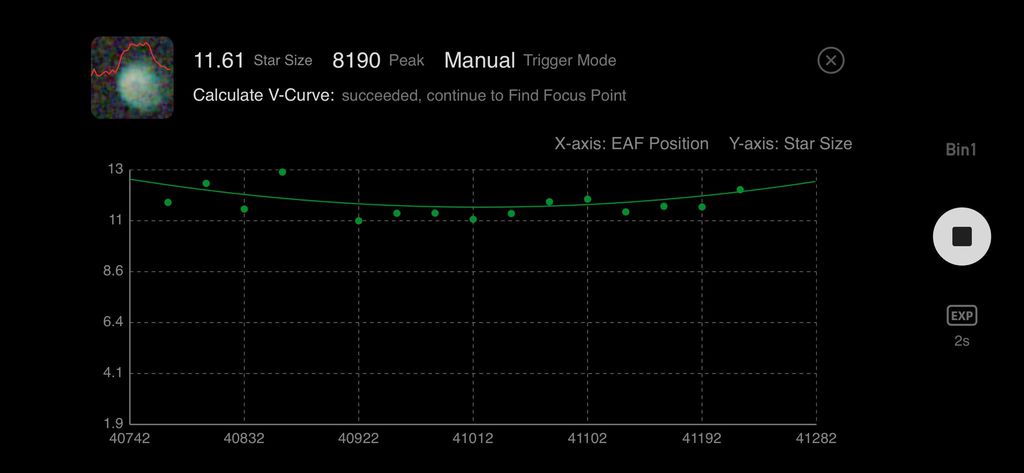

Hello everybody, I recently bought the ZWO EAF and a support to use it on my canon 70-200 f/2.8 L. I have problems in reaching the perfect focus. First of all I manually set it, then I run the focus feature on my Asiair Plus but I never get a V-shaped curve nor a perfect focus point.   and this is the result  while I would like to reach this result instead  can someone please help me? Maybe there’s someone that use it with my same Canon lens or with Samyang/Rokinon. Thank you in advance!
I would increase the step size (considerably).
Yes, increase step size. The EAF takes 5,760 steps for one rotation and your graph is only about 1,500 steps. Increase until you start getting a good U curve which will make the autofocus routine appropriately accurate.
Sorry, it just hit me you're using a terrestrial lens. You may not be able to use an autofocus routine with such a lens. The autofocus routine has to be able to get sufficiently out of focus on both sides of the focus point for it to plot a good curve. Some lenses have very little, if any, focus travel left past its infinity focus point. If that's the case then the autofocus routine won't be able to get enough outside focus to do its job. When you focus manually, check to see how much you can turn the focus ring beyond infinity. It's also possible you may not realize that the EAF motor is stalling if the lens has hit its stop point when it starts the autofocus routine.
