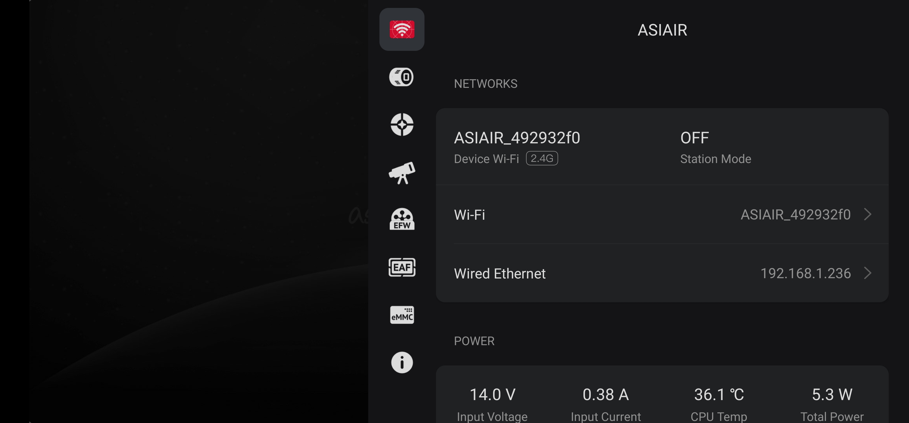

You wrote: "There was no setting up, I just plug in the cable and it works."  Is there something that says "Connected" or some other indication that you were on  Ethernet?  Did your ASIAir_XXXX network indication grey out?  When I plug in the Ethernet cable, it is obvious that the ASIAIR Plus is still running on wifi only. And in the Network page of the  Settings menu, my ASIAIR_XXXX indication is still lit up the same as when the Ethernet cable is not plugged in.

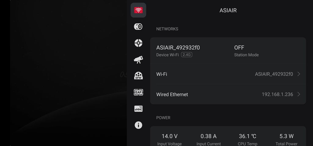

1.     Once I've completed polar alignment,  I go inside and connect an ethernet cable (which is connected to my router) to my tablet using the USB C to ethernet charge adapter.
2.     I use the Samsung Galaxy Tab A8.  I don't know how similar it is to yours....I hope this helps. If there is no way you can tell whether or not the wired ethernet is connected from the initial screen,  go into:
Settings
Connections
More connection settings
Once you are on the More connection settings screen, insert your ethernet cable...At this point the word Ethernet should change from a fine font to a bold font.
Terrance
John_Peper 0.00
Here is my question:  How can I make the AAP use the ethernet connection?  How can I tell if it is?  Where can I look in my tablet to tell if the ethernet is working?   For example, what should I see in the tablet's networks setup page if the ethernet is working?
Thanks, in advance, for your help.
Where it says Wired Ethernet, it should also show an IP address assigned by your router. Remember this IP address, you may need to use the "connect by IP" to find your Asiair on your network. You should also turn off Station Mode (do this while connected to the Asiair Hotspot). When outside setting up, use the Asiair Hotspot. When you move inside switch to your home wifi network.Screenshot_20230512_145030_ASIAIR.jpg
Larry

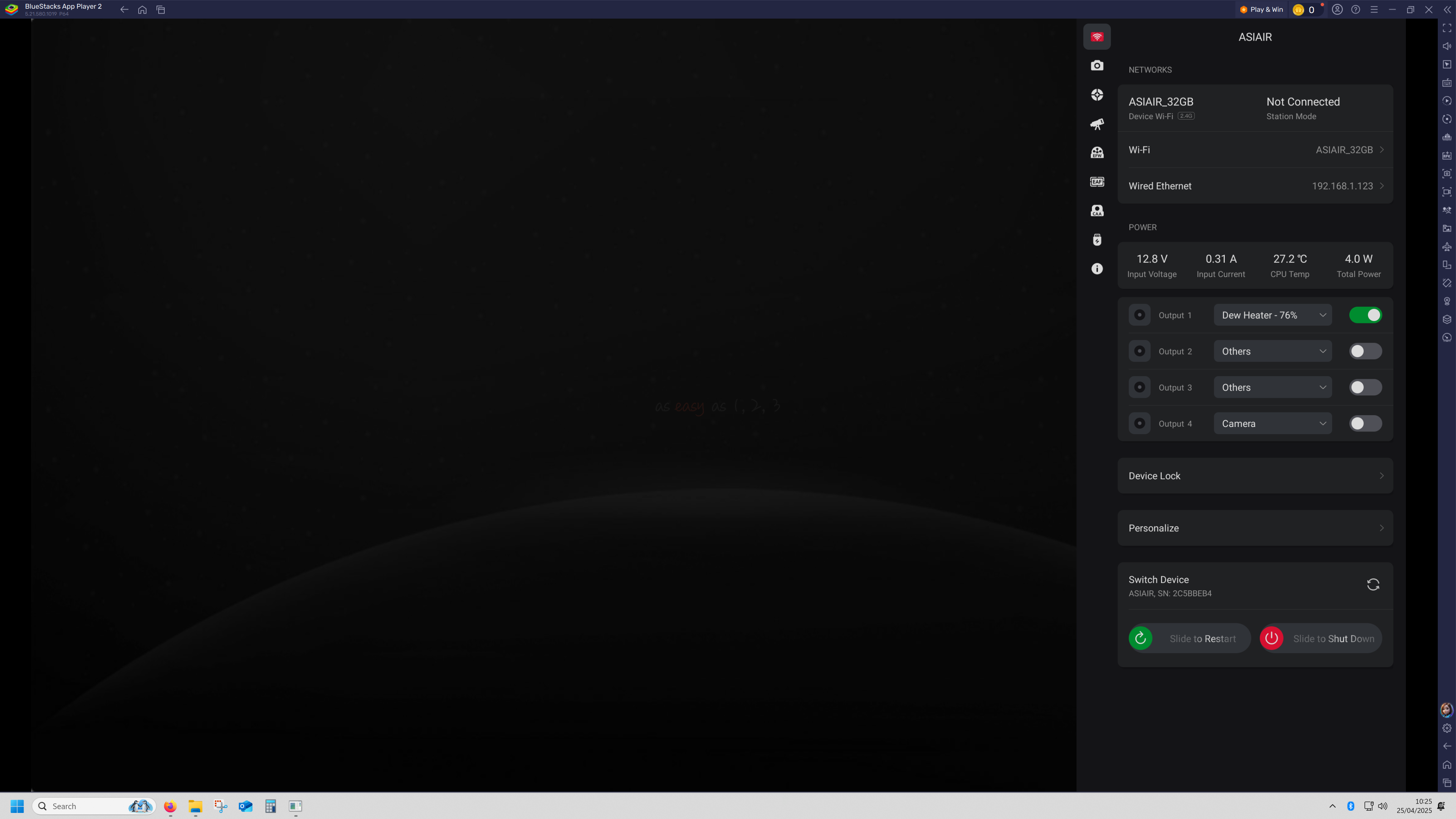

Hi Larry, this is a screen shot of what I see on my pc
Regards
Richard
