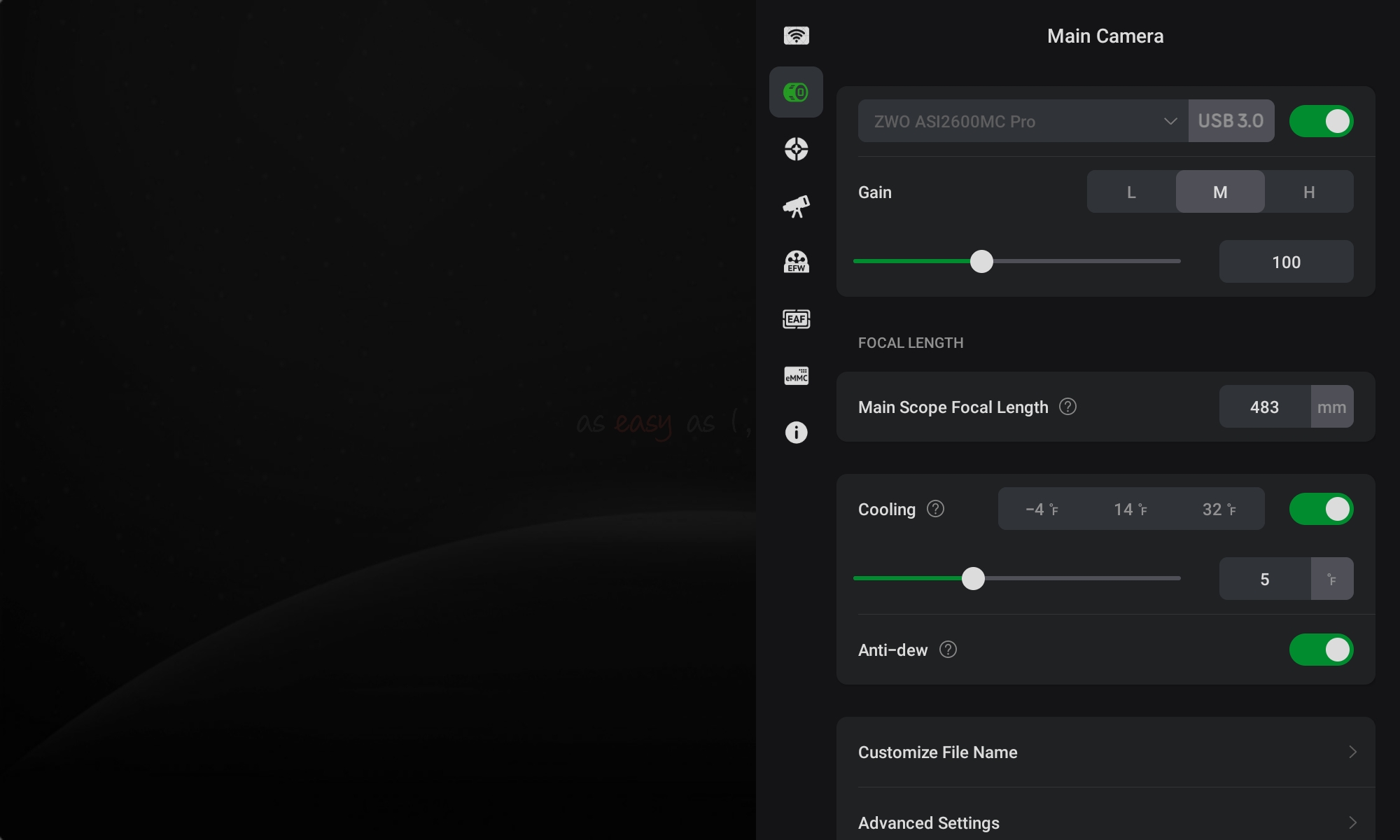

Please send some photos of the focal length that you have introduced in Asi air, both the main camera and the guiding one. Your data doesn't add up. If you have an 80mm f/6, the focal length is 480 mm. If you enter a lower value, the RMS that air shows is not correct.

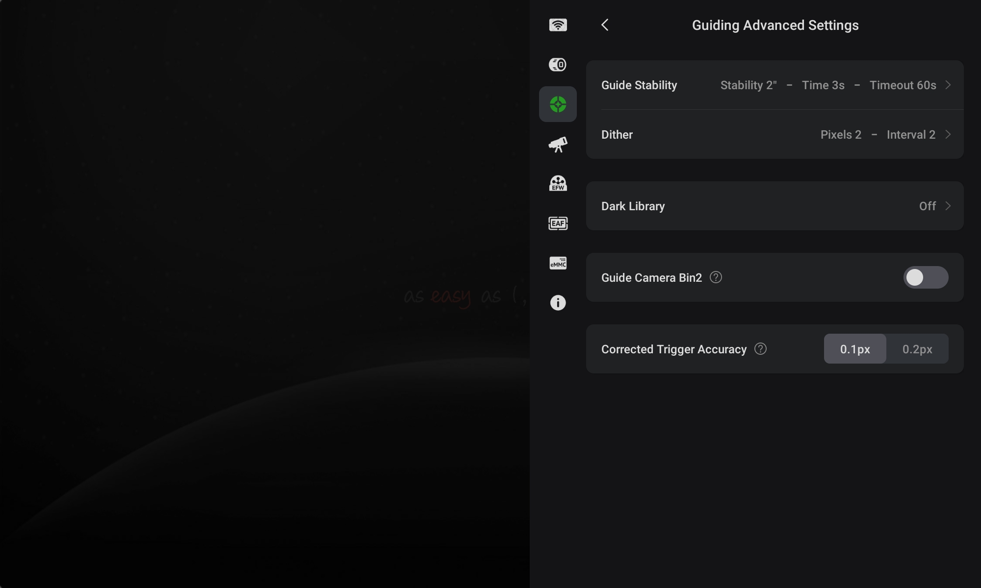

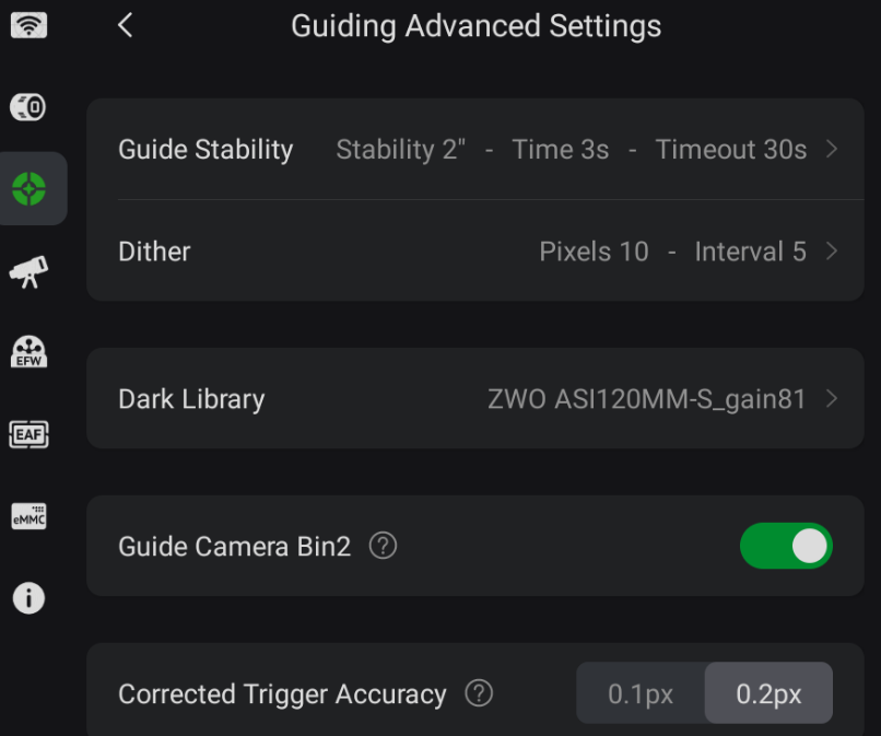

Send the guiding configuration, in guiding advanced settings.

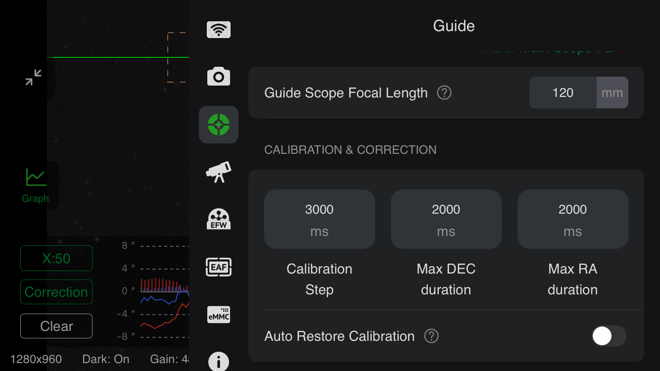

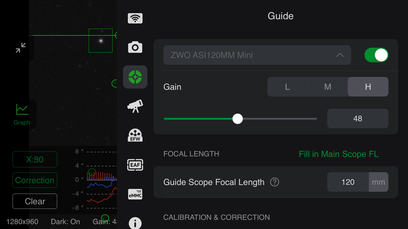

@Leonardo Ruiz here are the screenshots. The focal lengths haven't changed from before (when there were no issues), so there shouldn't be any issues there.
Please don't take my listed RMS as gospel (I think those were the numbers but I don't have the exact # in front of me).
The only thing I've changed from these screenshots is the calibration step. I've played with it around 1500-2500 to troubleshoot but didn't notice any major difference.

Why is your guide scope focal length at 160mm and not 120mm?
chroniclesofthecosmos 1.51
Dan Kearl:
That's the focal length

Derek Your focal values ​​are fine, so we will review each parameter to achieve correct guidance.
To start, I advise you to activate Dark Library in advanced Guiding settings. Basically it makes some darks and achieves greater contrast in the guidance image, which improves precision. In the same way, it activates Guide cam Bin2, thereby making larger pixels that are better detected. They are not essential parameters but they can help. When you have a good guide, activate and deactivate to see what works best for you.
You mentioned that in polar alignment you got values ​​less than 30", that is perfect. However, I advise you to focus as best as you can so that Asi air can read with greater precision. I use an EAF for greater precision. Another thing is the time of exposure in Polar alignment, if it is too low it will not detect the stars well, if it is excessive it will saturate them and you will not be able to distinguish the centroid of the pixel. I use 3" seconds for LRGB and 10" for Narrow band.
