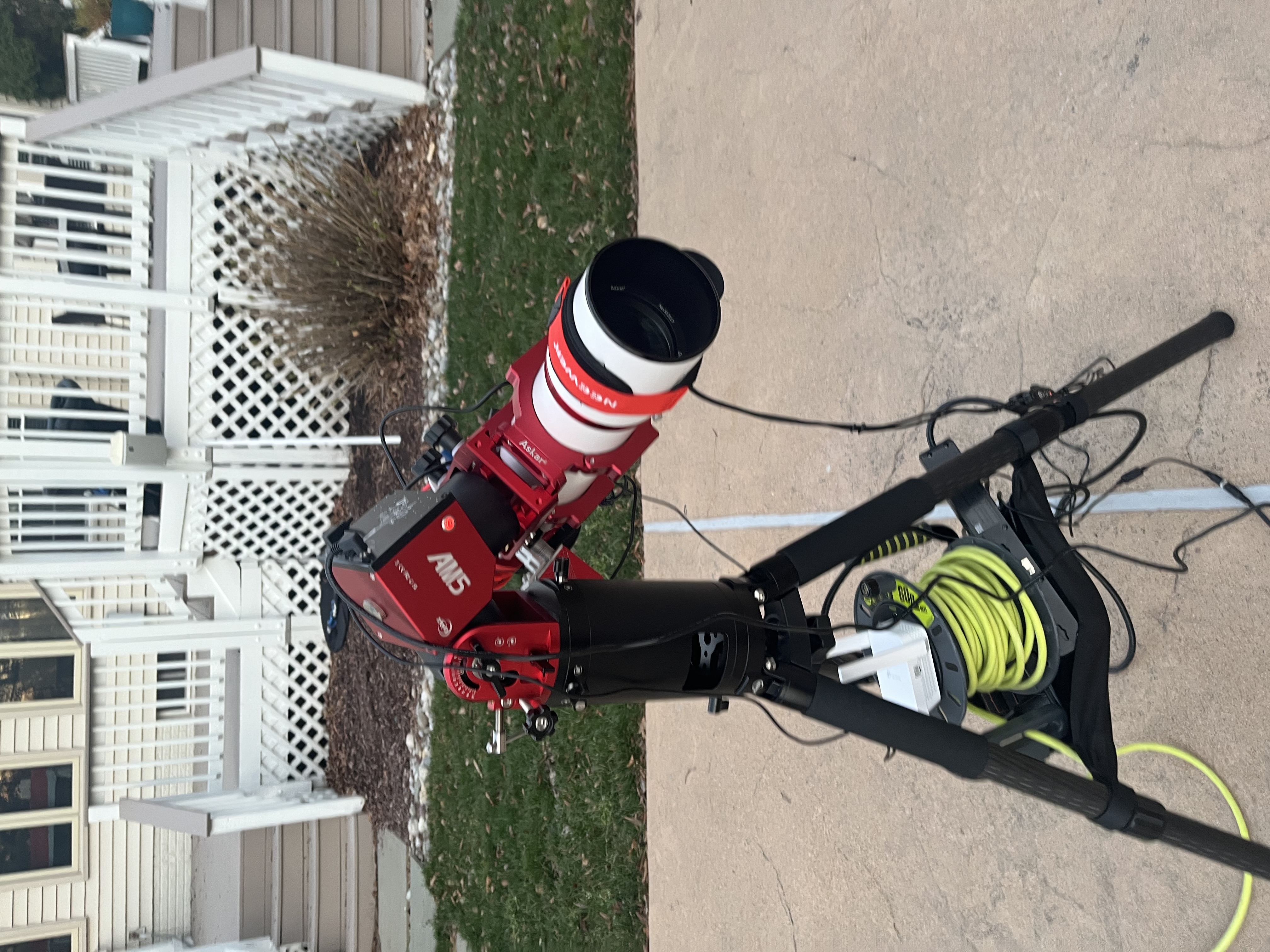

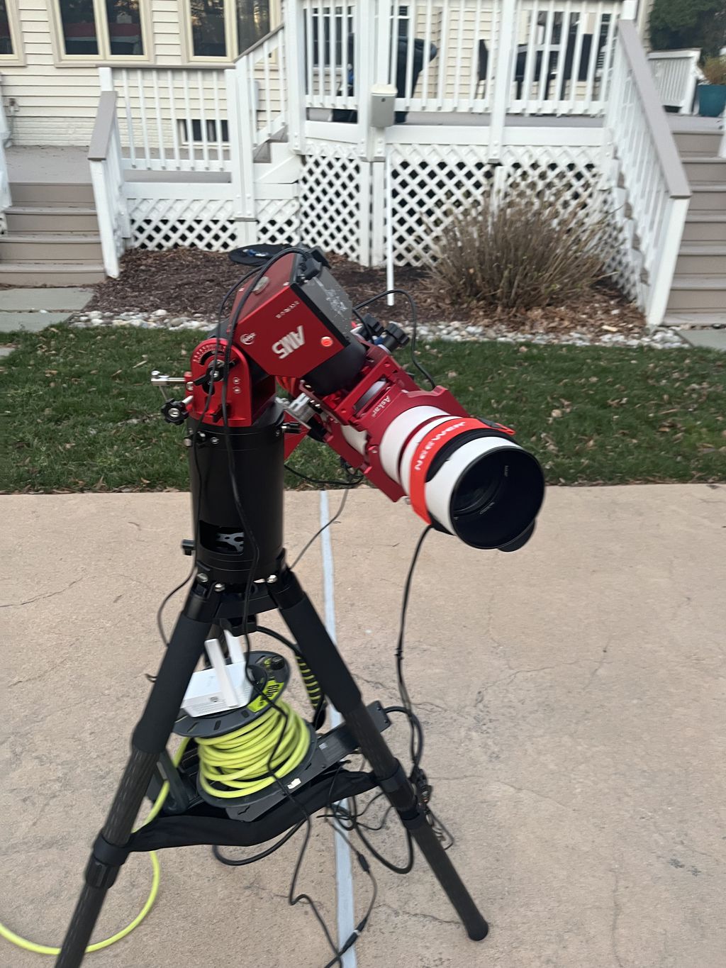

Curious if anyone is seeing a consistent error with their MF?
I used mine fine throughout the bulk of 2024...often in plan mode performing 2 MFs per night on two different targets...no issues.
W/in the past two months, it hasn't completed a MF once.  Twice now I've woken up to find the mount looking like the pictures below.  Cable snags are not an issue...those cables have plenty of play and I've checked, are not snagging
Included the log as well in case anyone has the same issue...shows multiple fails to solve the rest of the night.

I'm beginning to believe this is caused by belt slippage.  I contacted ZWO and performed their recommended belt tightening procedure.  I tested the Meridian flip indoors (obviously didn't plate solve) but it flipped multiple times…multiple different targets w/o issue or grinding.
I'm going to try it again on the next clear night and likely use heavy duty mode and possibly a small counterweight.  While not required…my FRA 500 with associated AP gear isn't necessarily light (still under AM5 limits though)…and a little counterweight can't hurt (in my mind) in trying to relieve stress on the gears etc.  Heck who knows…might improve guiding as well.

So…after trying it last night in Heavy Duty mode and with a counterweight, I had zero errors, a perfect Meridian flip and immediate solve after (used Autorun mode).
I'm getting more convinced this was a belt slippage issue.  I had very few subs lost throughout the whole night as well (usually lose a few to oblong stars etc).
Think the counterweight is key.  I know its not needed etc…but it definitely helped in my situation.
