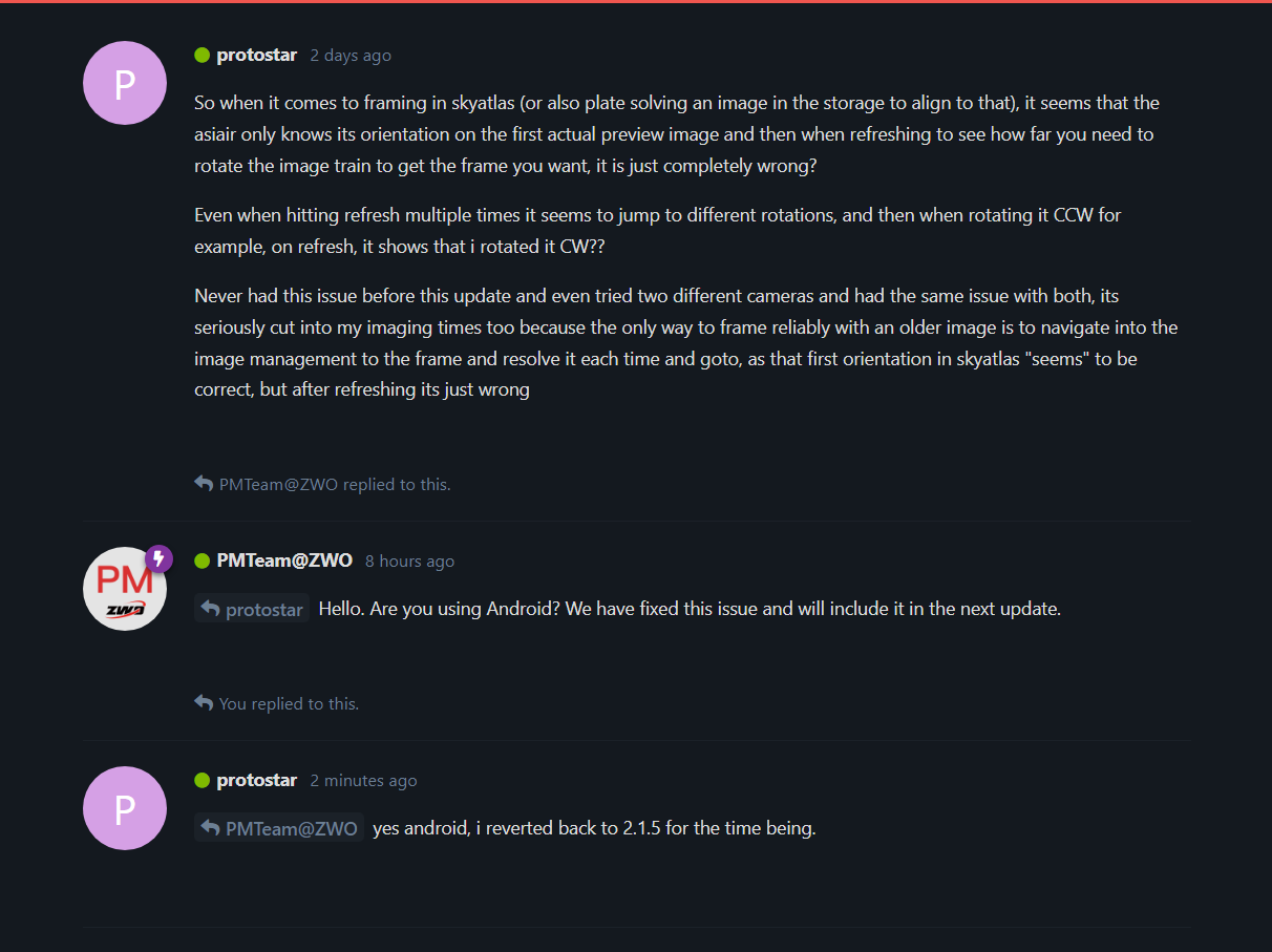

So when it comes to framing in skyatlas (or also plate solving an image in the storage to align to that), it seems that the asiair only knows its orientation on the first actual preview image and then when refreshing to see how far you need to rotate the image train to get the frame you want, it is just completely wrong?
Even when hitting refresh multiple times it seems to jump to different rotations, and then when rotating it CCW for example, on refresh, it shows that i rotated it CW??
Never had this issue before this update and even tried two different cameras and had the same issue with both, its seriously cut into my imaging times too because the only way to frame reliably with an older image is to navigate into the image management to the frame and resolve it each time and goto, as that first orientation in skyatlas "seems" to be correct, but after refreshing its just wrong

Update from ZWO, they supposedly have "fixed this" and will deploy it in the next update

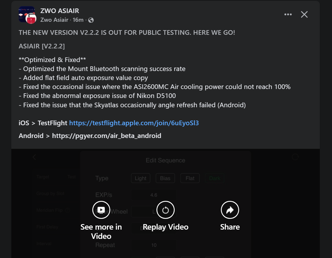

Update: they seem to have released the update now
https://www.pgyer.com/air_beta_android
https://testflight.apple.com/join/6uEyoSl3

tested the new update, framing seems to be fixed in it
