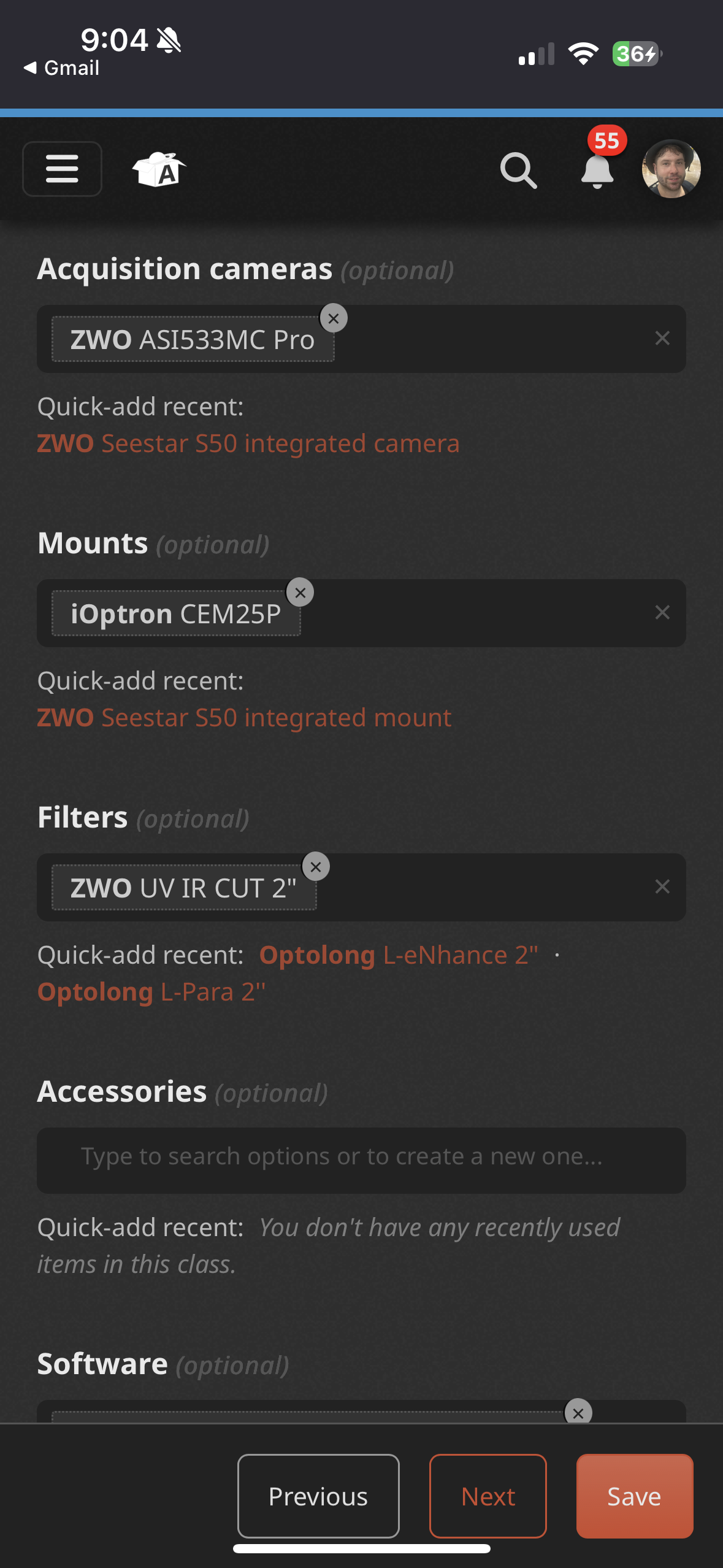

You should be able to click into the field that says “Filter” and start typing your filter used. Most filters will show up. Here’s how it looks on mobile but on Desktop it’s pretty much the sameIMG_5323.png

Does this come up after you connected your mount? I was trying to enter the filter before I connected the mount ! (CEM25EC)
DishItDash 0.00
You know what? I misinterpreted your question. I thought you were referring to adding it on Astrobin. I actually don’t know how to do it in the ASIAir either, but my workaround is:
Click the camera tab > Scroll to bottom > Click on “custom file name” > type in name of the filter somewhere in the name field.
It won’t save the filter in the metadata (so stacking software may not recognize a filter being used) but you can read the filter name in the FITS file name, and stack or process as needed.
hopefully that answers your question better!
