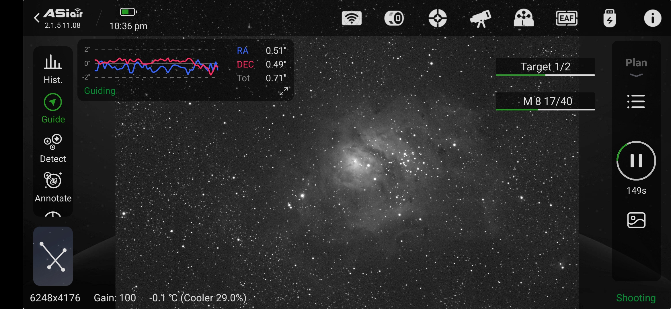

For 15 years, I have been using a great number of mounts and complicated softwares¨, that seemed designed for engineers, and wasted whole nights trying to get things right - slewing, plate-solving, guiding, focusing, etc.
Then I switched - reluctantly, because it looked too different and too simple ! - to the Asiair system. And it appeared nearly miraculous ! Pointing is always perfect, autoguiding starts in less that 10 seconds, the electronic focuser calculates focus for each filter, polar aligment is fast and accurate, etc.
What's more, those lightweight mounts (AM5 and AM3) are very versatile, even with rather heavy telescopes in heavy duty mode, like a 200/1000 newtonian.
I also use ASI Studio for calibrating and stacking my frames, and it works really well.
So all my time is dedicated to imaging, at home and remotely in Spain !
