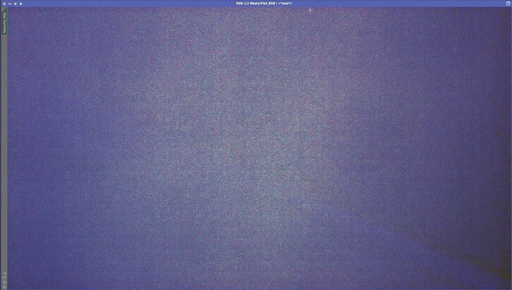

andrea tasselli: Are the diagonal bands visible in either bias, dark or flat? If so they can be corrected. If not then the bands are due to something else, most likely in the optics ahead of the sensor. Besides, if you bought it recently you might still be able to return and get a full refund. Are visible in the Flats, but when I apply them to the process in WBPP, the Flats doesn't remove the lines ( they appear as a blue shadow ). It's nothing related to the the optics, as the Flat image ( only B channel, the R and G are not affected ) included here was made just with the camera and the flat panel ( no telescope involved in this case ). Of course, the Flats used in the image process were made with the telescope. And yes, that's suppose to be the case, but they say that this is something related to Sony, not to them, so they haven't offered the option for an exchange or refund.

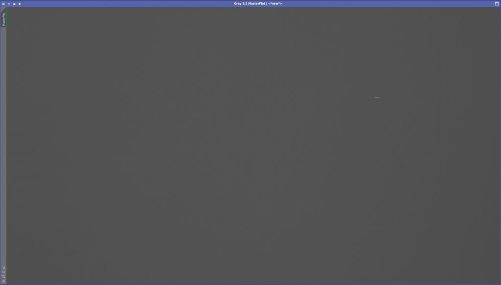

andrea tasselli: So, with the telescope attached, are the bands visbile in the master flat? Can you show them? And not the debayered ones, the original raw master flat (assuming the bias/dark isn't affected). If so, then a properly applied and created master flat would remove them (otherwise what would be the purpose of the flat?). And by "properly" I mean avoiding WBPP entirely. I haven't used any other method than WBPP for a long time, so I have to remember the older process to generate a Master Flat. Never have had any issue with it, so what for?. Anyway, in raw flat images without debayering ( or darks, bias ), nothing can be seeing ( only "flat" grey images ). Only when I apply the debayering, the lines appears in the blue channel. This happens both if I make the flats using the telescope or shooting directly to the flat panel. So it's nothing related to the optic train. I will generate a Master Flat using ImageCalibration and post it later. Edited: MasterFlat using ImageCalibration+ImageIntegration: looks exactly the same than the one generated by WBPP. Flat grey without debayering; Lines visible after debayering.   |

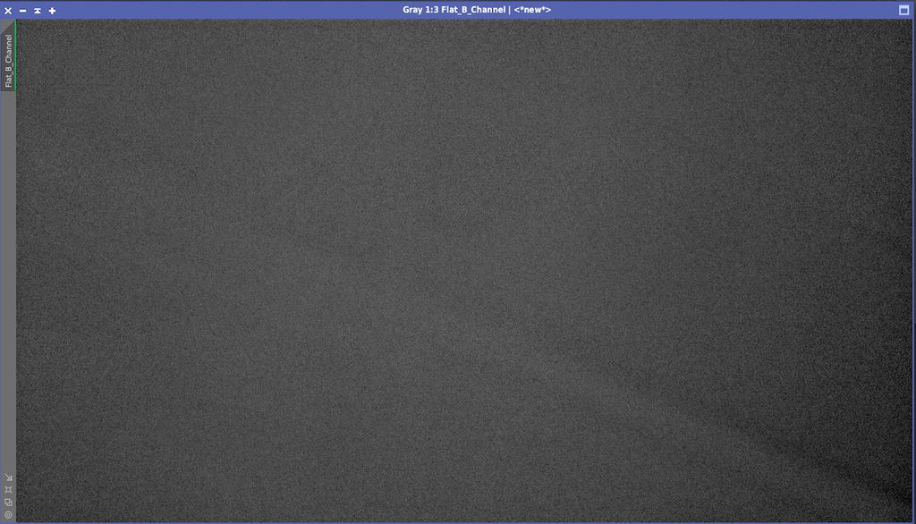

Edited: MasterFlat using ImageCalibration+ImageIntegration: looks exactly the same than the one generated by WBPP. Flat grey without debayering; Lines visible after debayering. You have to extract the B channel from the master raw flat. This will contain only the B pixels and not the blank ones and will show whether you have the issue as well or is related to something else. I guess is called CFASplit or something similar.
And then, obviously, if it is there alright then the question is in what way the calibration doesn't address this issue. So you'll have to revise your calibration steps one by one. Same gain, offset in all those steps and check the linearity of the sensor across the board (well, gain values) as there might be jumps with this lower class of sensors.

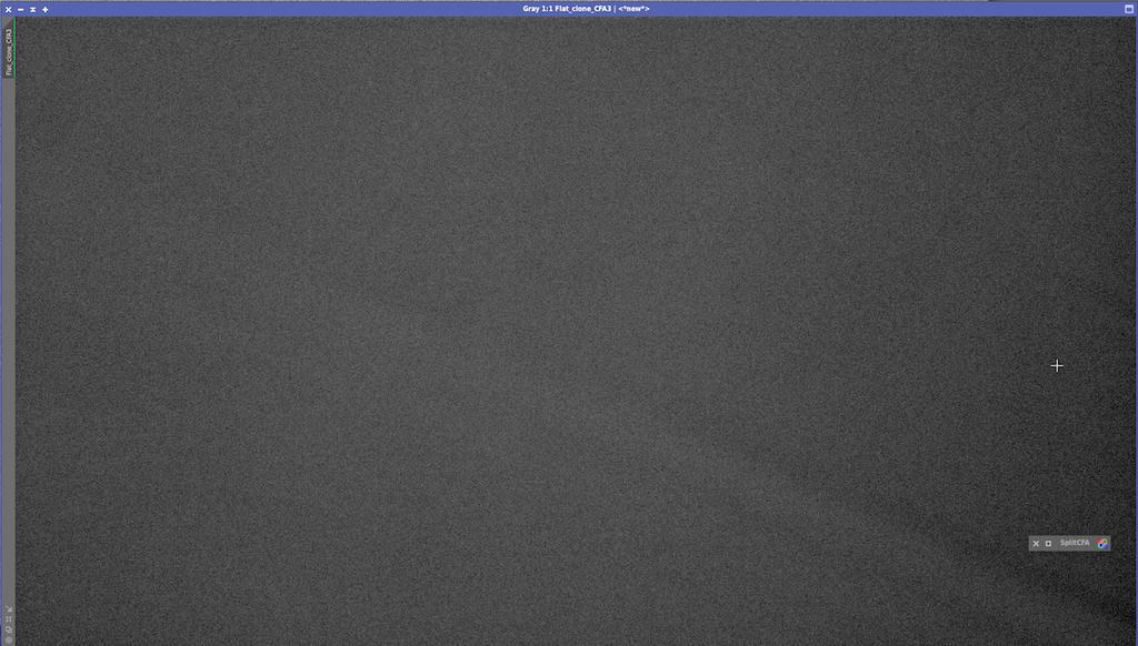

You have to extract the B channel from the master raw flat. This will contain only the B pixels and not the blank ones and will show whether you have the issue as well or is related to something else. I guess is called CFASplit or something similar. Thank you for the clue. I have made a CFASplit and this is what the B channel shows: the lines. I have already tried with different Gains ( the ASIAir doesn't allow to select a different offset ) and the result is just the same. I have been chatting with a couple of Uranus-C cameras owners ( same sensor IMX585 ) and they don't have this issue. So Sony is not the problem, but ZWO. They only allow me to return the camera if the technical support considers that this is due to the making process, but their answer have been: "Sony don't guarantee uniformity of channel", so it's easier to blame others than to take action and exchange the device. I will try to deal with this somehow ( may be creating a synthetic Flat ) until I sell the camera and buy it from a different vendor ( as I see that PlayerOne is more serious than ZWO, I will buy one from them and move away from the ASIAir ). I have had to deal with ZWO's technical support arbitrariness in the past ( the fan vibration or the oil leak in the 2600 ) and I'm done with their behavior.  |

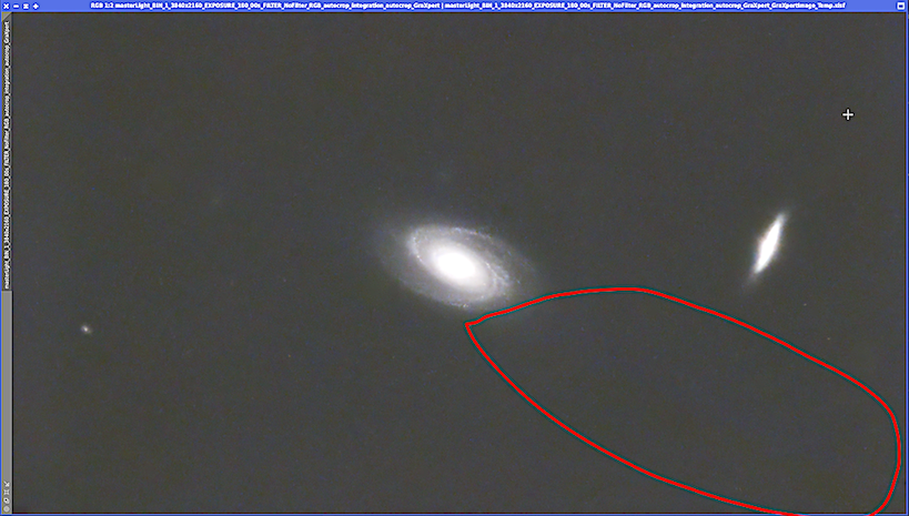

andrea tasselli: While I do approve of moving out of ZWO ecosystem I still think you should be able to calibrate that effect away. I have tried different approach today and I always get the same result: blue/yellow line crossing from bottom left to top right. I have tried with ImageCalibration, applying different PixelMath operations, following a tutorial to make a synthetic flat, trying to make new flats... Nothing works here. I can't see any real alternative, because I haven't seen something like this out there ( although I will keep searching ). The only way I get those lines out is painting them with CloneStamp or with Photoshop. The obvious problem is when I remove something that really exist in the image... A complete mess!!
