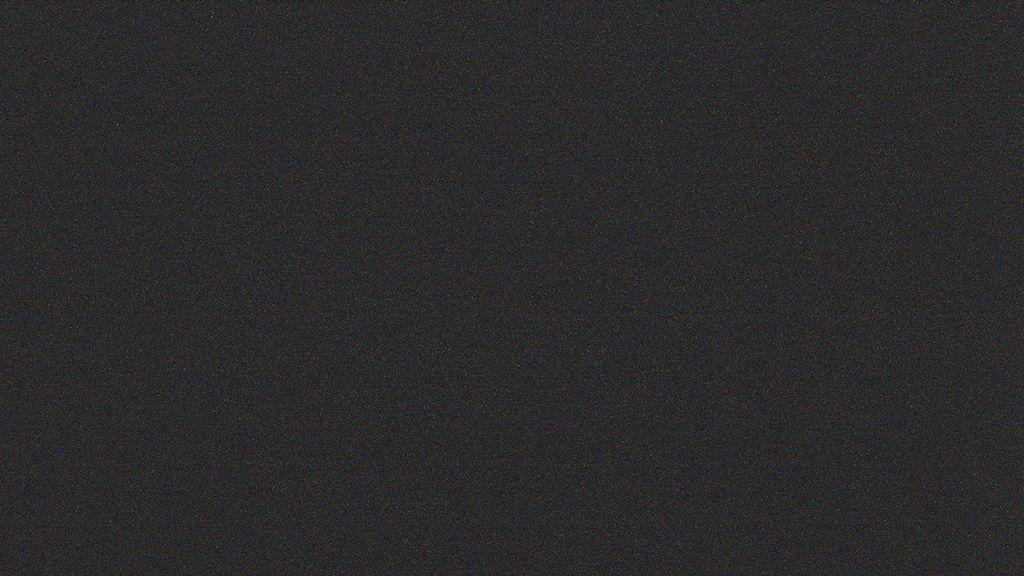

Hello,
I've just bought a ZWO ASI585MC Pro, my first cooled astrocam. Didn't get the chance to test it outside yet due to cloudy weather (of course) but I made some dark and bias frames, checked the cooling works, etc., and I've noticed this weird diagonal banding. Only visible in the dark frames, no sign of it in the bias frames. Also, it seems to be less visible at lower temperatures and pretty much disappears when the camera goes below 0C. I couldn't detect it at -10C at all.
Given this is a new camera, should I worry about this and try to return it? Or just shoot as is with it cooled?
Any guesses what could be causing this? I've tried moving cables around (thinking it could be some sort of interference), different USB ports and different computers. Same result, seems like something in the camera is causing it. The bands appear to consist of noise only, but I can't say for sure, and are exposure length dependent - banding is more pronounced the longer the exposure is.

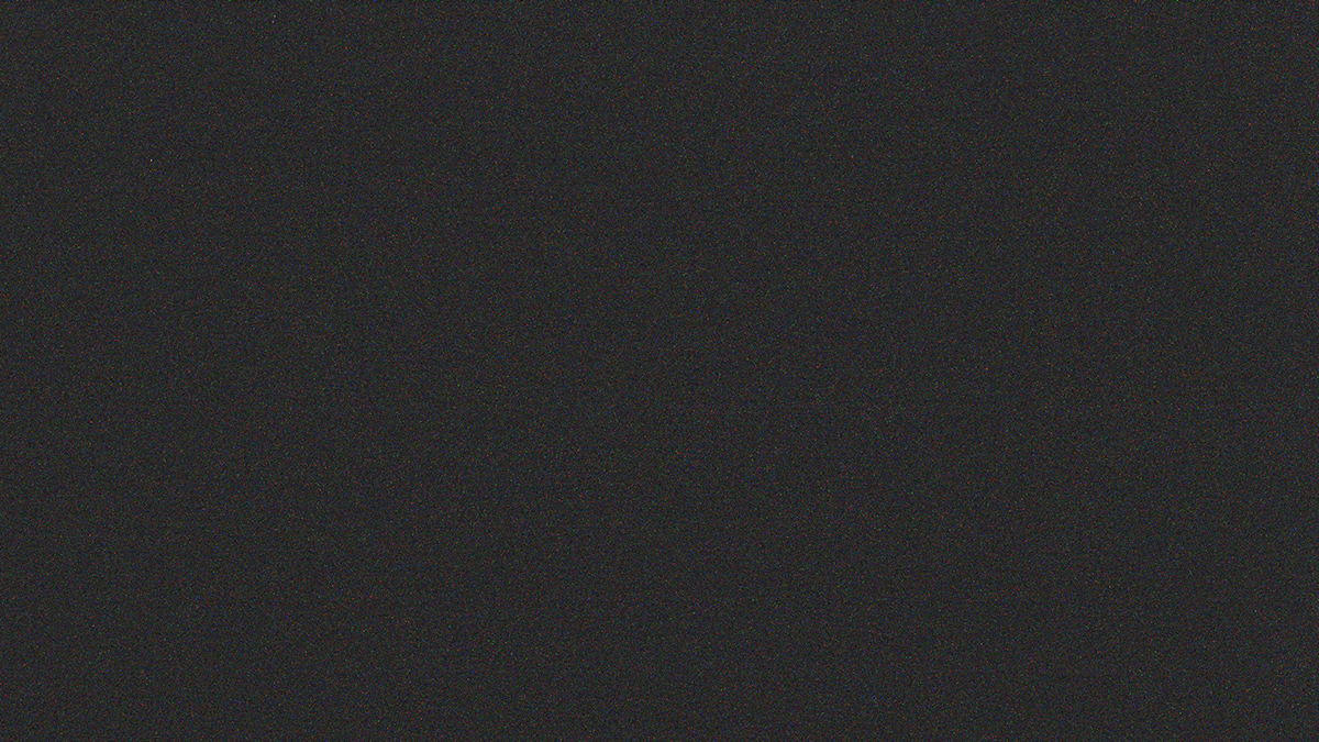

Here are the dark frames, you can clearly see the bands taken at room temperature and no sign of them at -10C.
Room temp, 252 gain, 120 seconds
Cooled to -10C, 252 gain, 120 seconds
