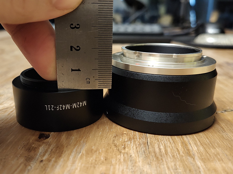

I tried to copy the idea and then got in contact with an old friend from school, which happens to be a mechanical engineer and has some amazing tools at home, including a beautiful lathe. "We" lathed a Delrin adapter, improving the design from ThinkableCreations... while also completely missing the required back-focus distance :
The adapter shows as that tiny white ring in between the filter drawer and the back of the "severed" lens.

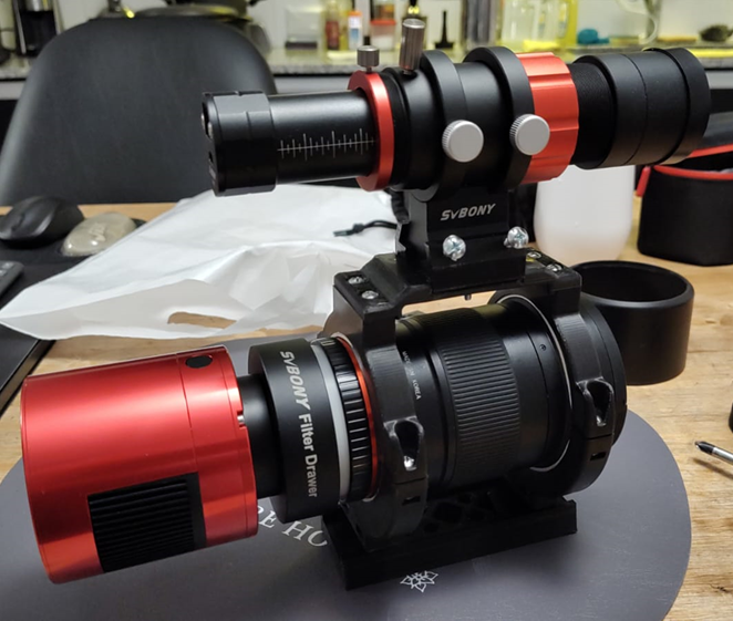

The idea was to include a 21mm filter drawer, matching one of the solutions proposed by ThinkableCreations. All the mounting hardware was 3D printed from designs I found in Thingiverse, mixing and poorly matching 3 different pieces.
Last Saturday was the first night under the stars, and then the big back-focus problems showed their ugly face. Summarizing: I was getting infinity focus waaaay before the end of the focus travel. Since I didn't knew what was wrong and the skies were very clear, I still completed a first round of shooting, using the Svbony SV220 2" dual narrowband filter and the lens fully opened at F/2. I was blown away by the amount of data captured by the 585MC Pro...

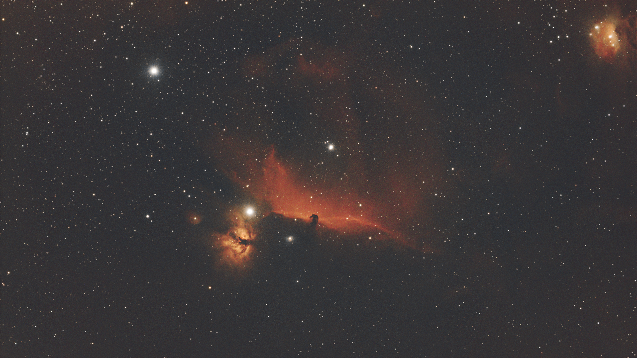

This is a quick PI edit of a single 3-minute exposure at gain 252 and -10° C, not calibrated:
(1:3 scale).

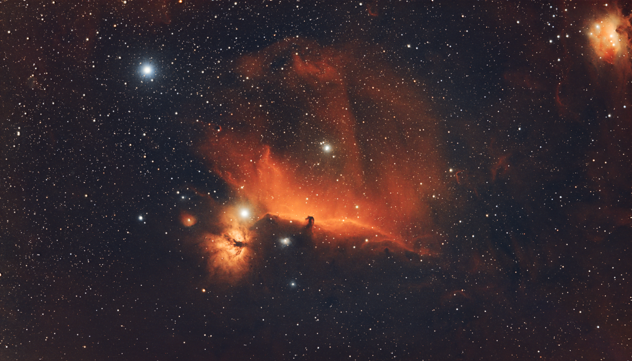

BX did an outstanding job correcting the awful stars I was getting on almost half of the frame. I would have never believed that I could get that amount of data in 3 minutes from my Bortle 7-8 backyard. I'm also not supposed to be using the SV220 filter at F/2... who cares.
Here a 2-hour (40x3min) integration:

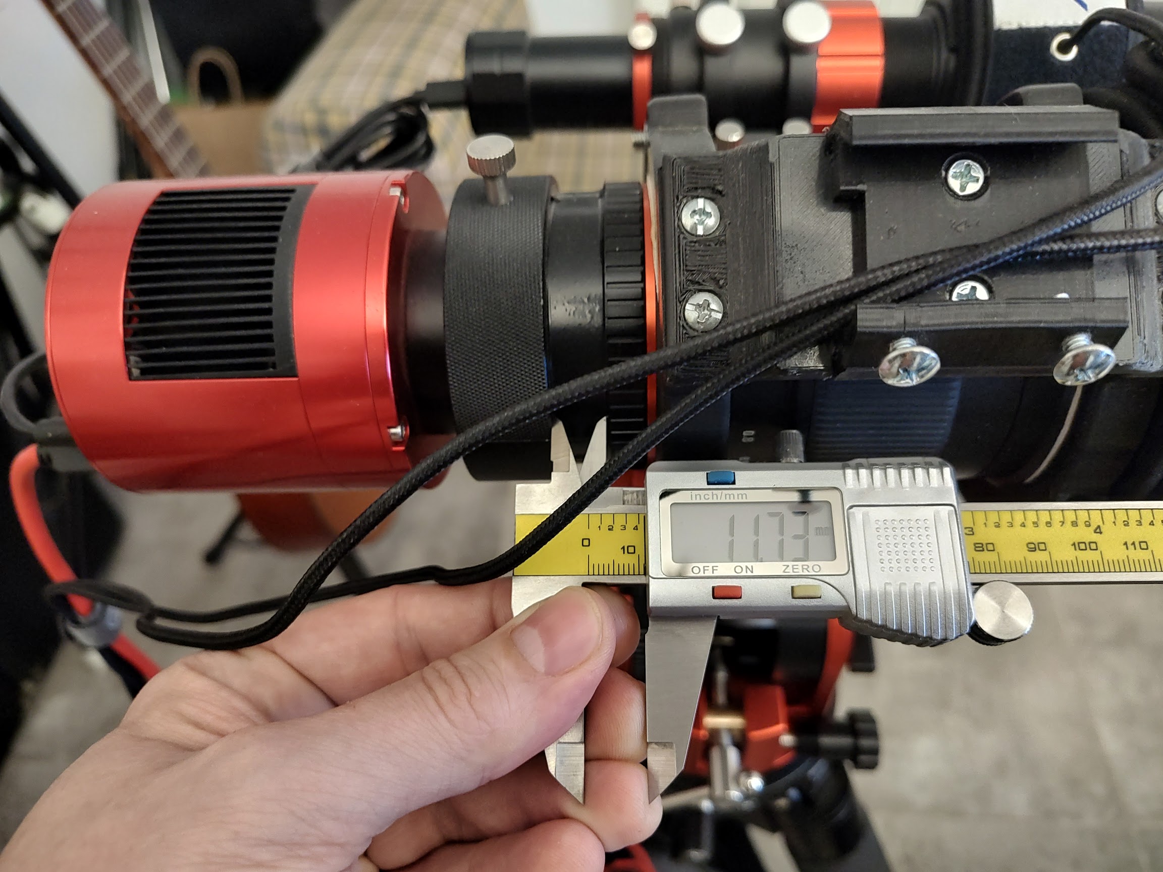

Today, after a lot of thinking and reading, mostly about back-focus and flange focal distance, I set up the rig for a few tests. I was able to validate that I'm missing back-focus, somewhere between 5mm and 16.5mm. A digital caliper is in the way and a well-measured version of this picture will provide me the correct answer:
Luckily, I still have Delrin leftovers for two new pieces. It's now time to get back into lathing... hopefully with the right numbers this time.
