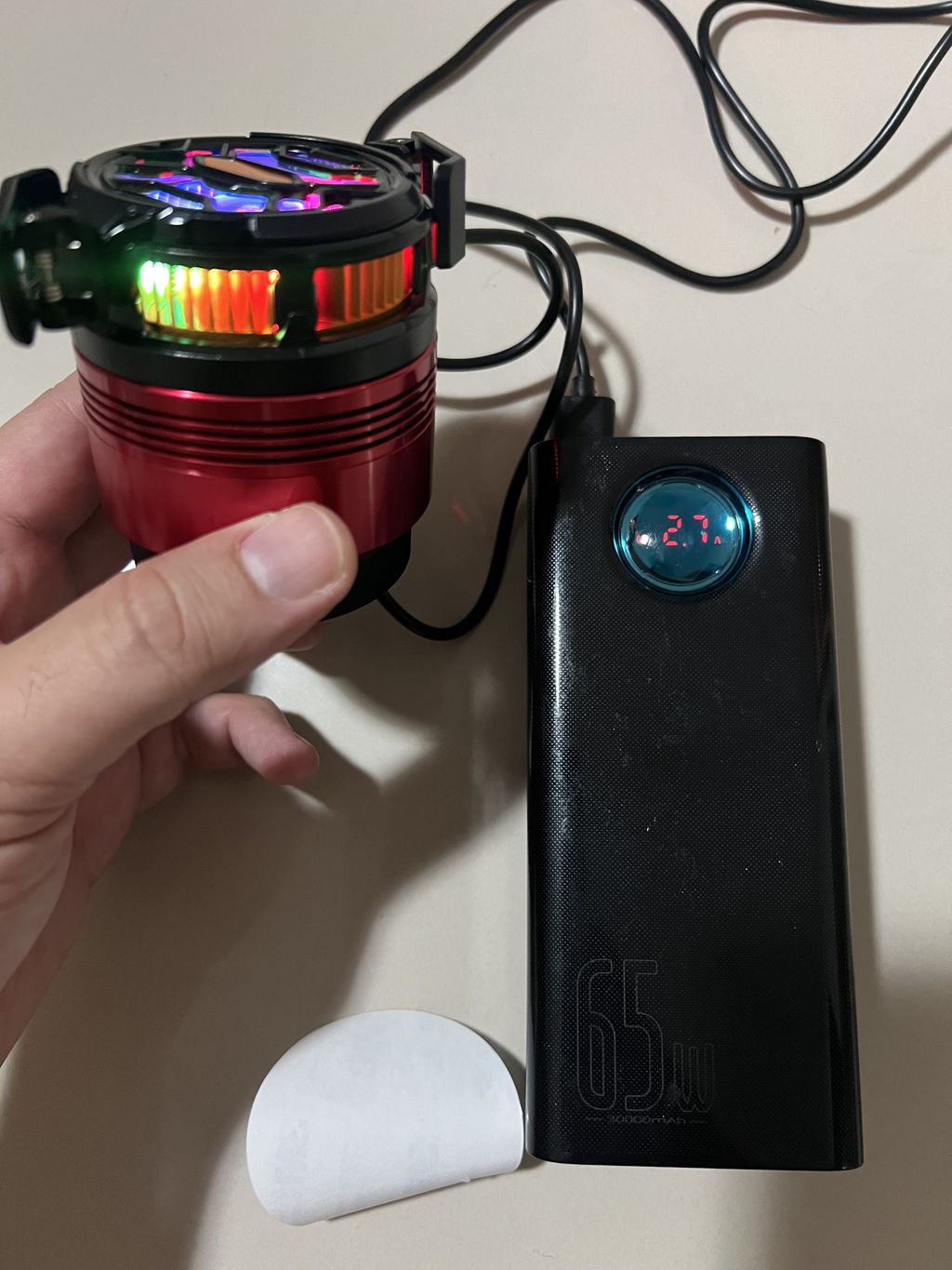

Guess I'm just gonna stir the pot by posting this but I've discovered the 585MC does actually have amp glow.   It gets particularly bad once the sensor reaches 30C.    It does calibrate out however with darks.
The 585MC Pro does still exhibit slight traces of it, but it hasn't bothered me enough to shoot darks.
I have and use both version of the camera.  If you have specific questions, let me know.    Short answer is the cooled is superior, however if you live in a cold climate, you could easily get away with the uncooled.

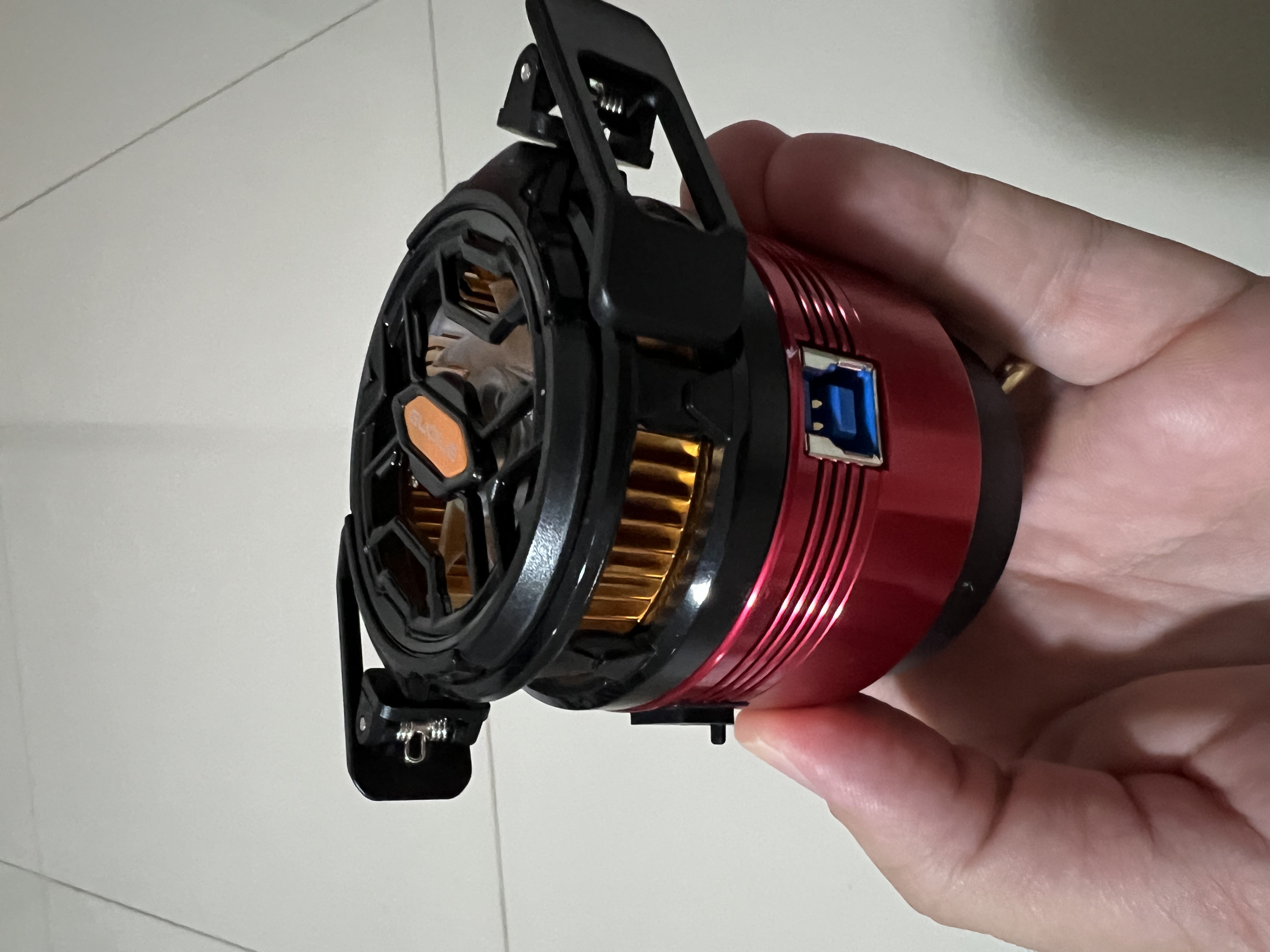

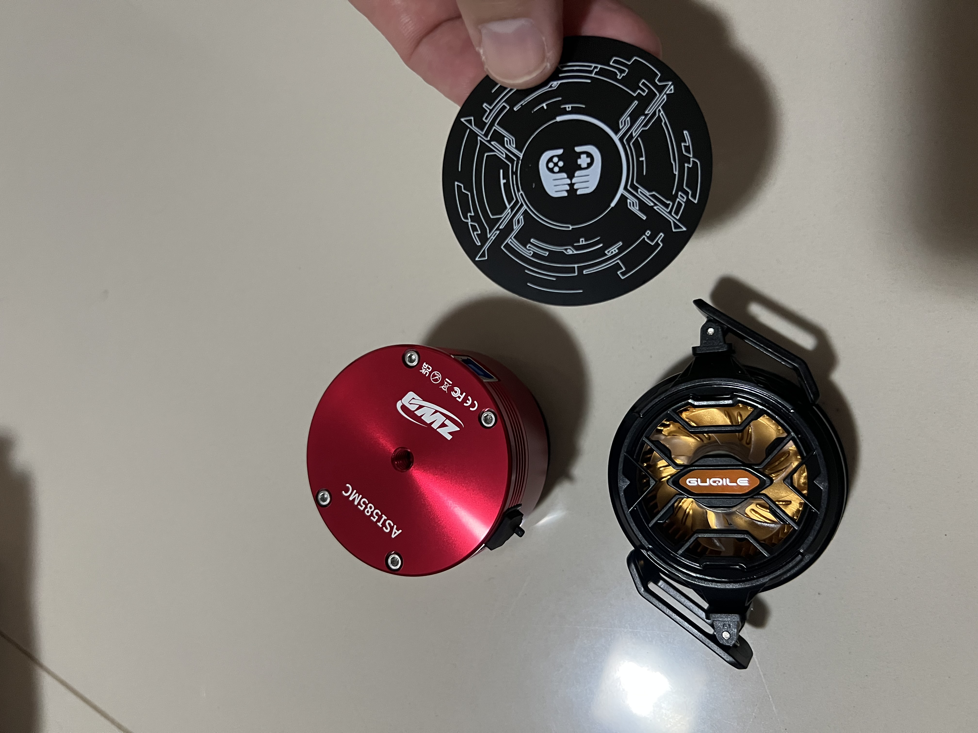

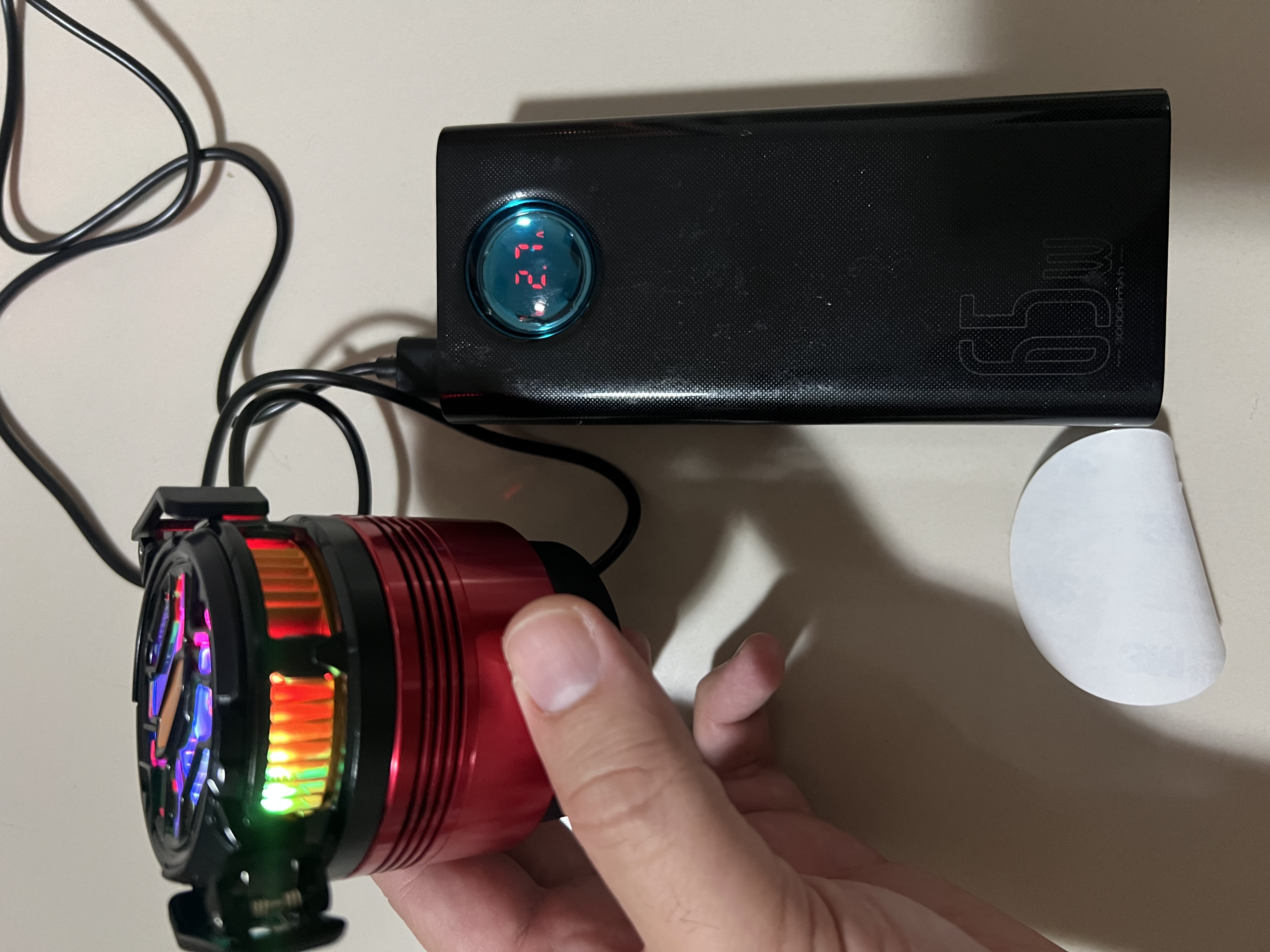

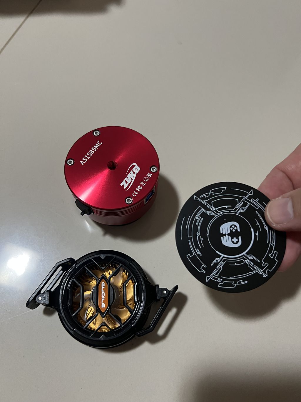

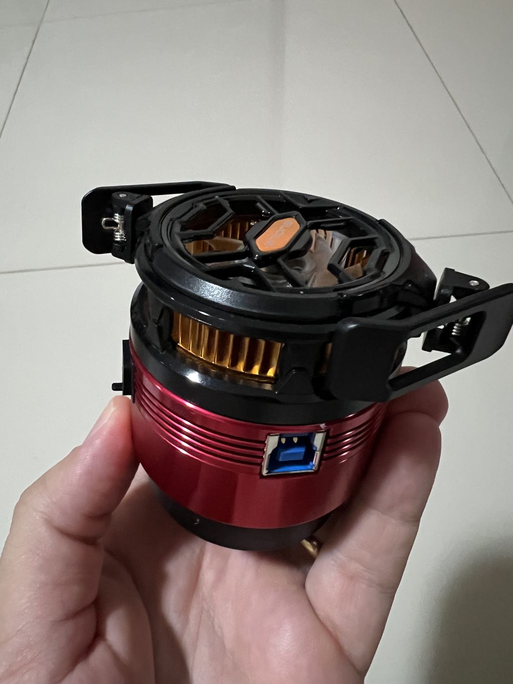

I also have a non-cooled 585MC and am trying to answer your question by myself by using some cheap phone coolers to compare the data. I don't have enough of it to draw a conclusion but I have a feeling that going down (in my case) from 32 to 18 C with the small cooler and 8 C with a larger one is making a noticeable difference. I'm waiting for the rain season to end so I can gather more data.
