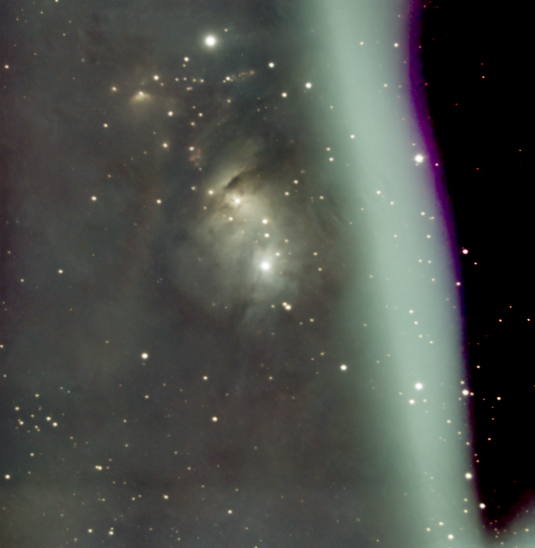

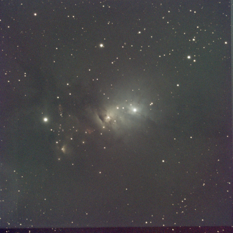

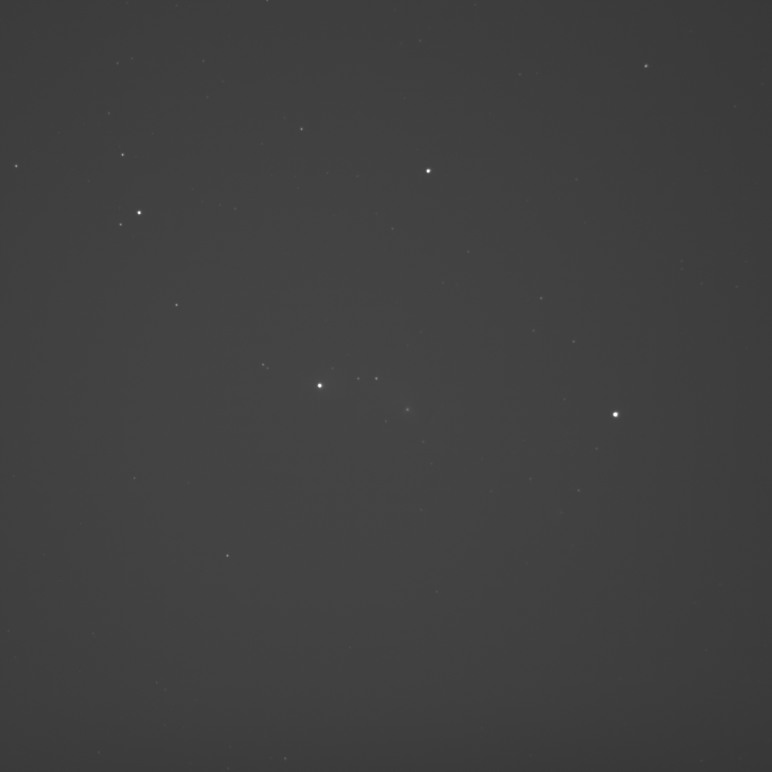

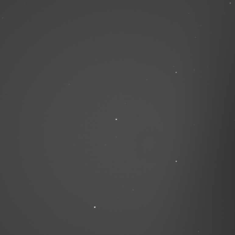

My Third attempt -No filter -frame 180" gain 100--- single and stacked image --all were taken before flip ( having issues with asiair and not flipping  causing the framing to be off, like you stated Alex)
single exposure:
180" total time 5 hours    Siril /graxpert -background extraction and noise reduction only-
my 4th attempt will be to resolve the right side -?

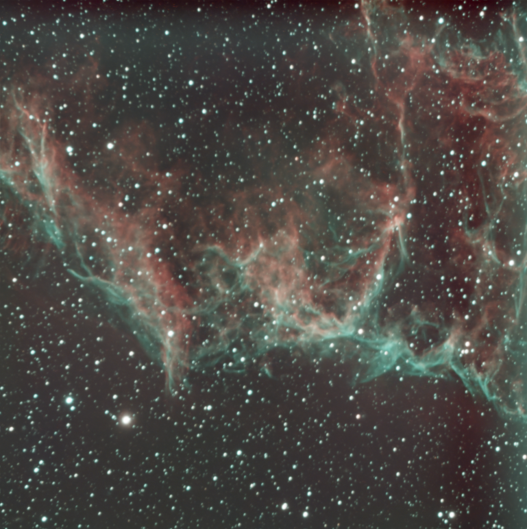

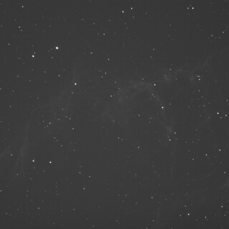

Tested the camera on Eastern veil:  300"--Cameral looks to be ok
stacked 300" 4 hours -Siril/Graxpert-background and Noise reduction only

As I undertand, you are NOT using flat frames for calibration, right?
You definitively should!
Tom2023+ 0.00
I’m using flats
Tom H:
I’m using flats
Then they are not really working, do they? Let's cut the chase, so can you post (Google drive and similar) a set of lights, the master bias and the master dark (and let's hope they are proper ones!) so that the comunity can have a go? At any rate, to answer your original query, no, the camera isn't malfunctioning. It is the calibration procedure that isn't working.

Sure? In your screenshot from Siril the checkbox is NOT checked!
Aloyz 0.90
Probably already stated but to reitrate: Graxpert and other gradient removal tools work best on cropped images. These AI tools can hallucinate if image contains stacking artifacts. Best to crop a bit more than not enough. I would consider evaluating the image and crop when STF (visual stretch) heavily exaggerated prior to gradient removal.
Best of luck and keep up great work!

Andrea, Do I need to check box's if using Sirll -OSC_Preprocessing script.  Siril does not mention to do that when running script .
Still trying to figure out how to share files on site with Google Drive
If the script runs without errors then you have all the necessary calibration files and they are applied. You don't have to worry about those check boxes unless you are running a manual process, not a script. I second the idea to post all your lights and calibration files so we can have a good hard look at your data. Something is really messed up and I'm sure more experienced eyes will find the problem right away.

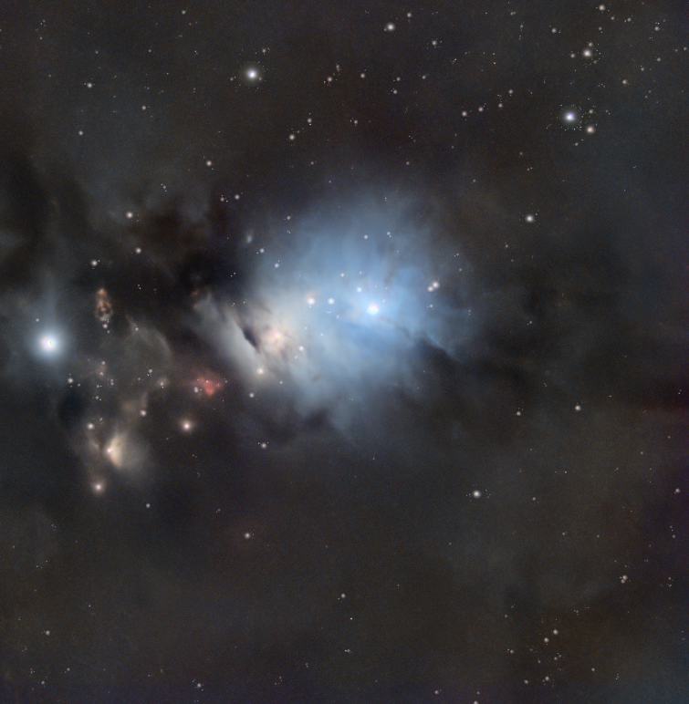

Update
I took your advice and just started from scratch( new flats darks biases)  and it seemed to work--going to add another 18 hours- goal is to get 24 hrs.
300"
single exposure No filter
Stacked  in siril with script
Siril- Graxpert -deepsky tools
Good job, except you have to crop it to remove all no-overlap areas so the Graxpert works at  best.
Nice, you're really getting somewhere with this…
