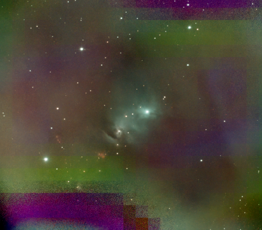

started getting pictures like this from my ZWO 533mc image was background extraction and Noise reduction in Graxpert and then opened up in Siril -Auto stretch view  |
No, I do not think, that the camera has a problem.
We would need to see the original picture without background extraction.
I guess, that your signal is pretty low and the Siril autostretch simply blows up all (normal) residual artifacts from background extraction. Is it a stack?
Without more information about the picture … difficult to say.

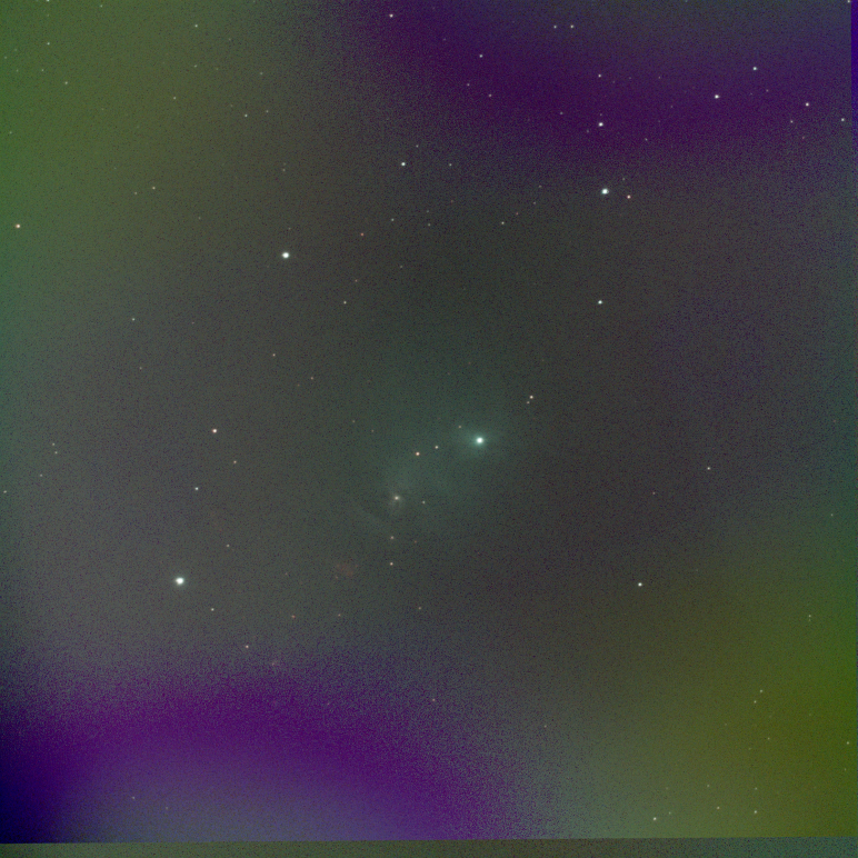

Original picture without background extraction  |
We mean an orginal single image, not a stack.

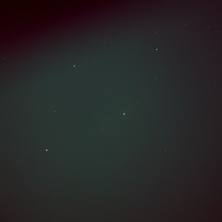

 asi air plus single image -jpeg Andrea calibration pipeline in Siril?

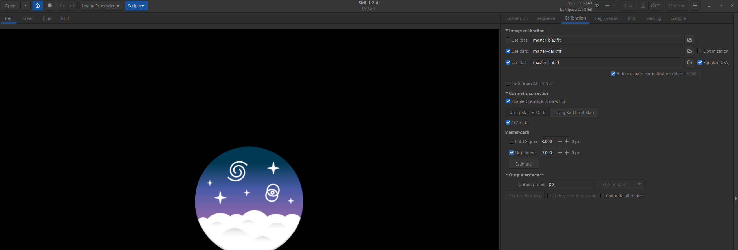

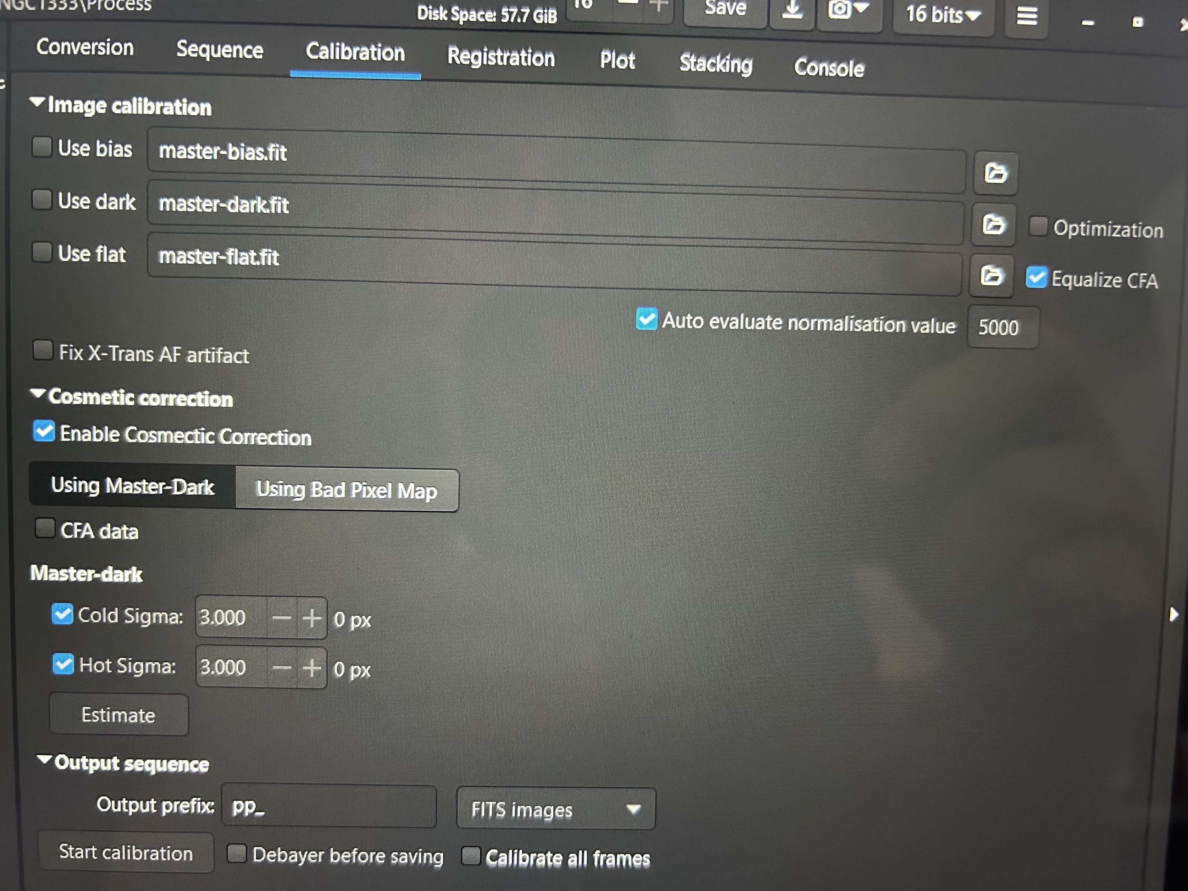

Siril settings The Andrea will try without L-enhance filter  |
If that are your calibration settings I don't think you are calibrating anything, see below:  You need to enable the options (and do it the right way) in order for Siril to actually do something. Are you using a script by any chance (like OSC_Preprocessing)?
I am using the OS C Preprocessing
I have had no issues with prior image processing-I thought these were already set by SIRIL-default settings.

The issue is that your frames are not lined up correctly, so when they were stacked, the usable area (area of intersection of all the subframes) is actually quite small, and all the dark area in the upper right and bottom left are areas of little to no subframe intersection, thus, little to no signal there, vs. the very center of the image where there plenty of signal.
This level of misalignment in your subframes indicates to me that either: 1. Your dither settings are FAR too agressive, causing the images to walk away from the center of the desired target. 2. Your polar alignment is quite poor, and during the night, any pauses is guiding to achieve autofocus runs are allowing the scope to drift a considerable amount between, thus, walking away from the desired target center. 3. You're not carefully re-positioning the target if you're shooting multi-night images, again, causing the frames to not overlap correctly, resulting in this sort of image..
Remember, the image sensor in your 533 is square 3008x3008px sensor, and the resulting image you got is rectangle, and im willing to bet its greater than 3008px on both sides… That's a perfect indication that the resulting image is made from frames that are grossly misaligned.
The original image is square and cannot be otherwise.

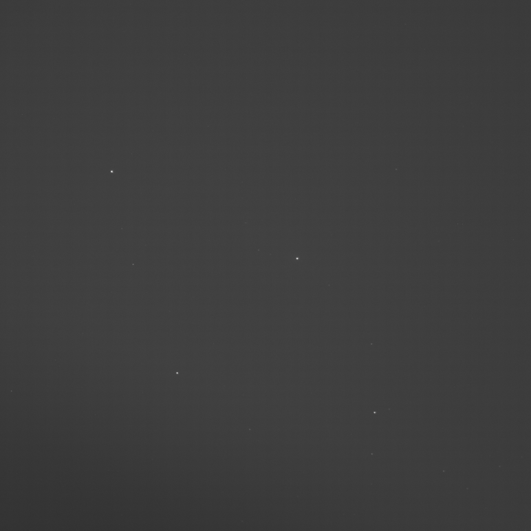

offset? New to the hobby how do I determine ? I appreciate you help Chris The camera has an offset setting. It determines the value of the reading on pixels where is no signal on the sensor. If you do not set it correctly you clip off all low values. To check if your offset is set too low check for the lowest pixel value in a single image. If it is 0, then the offset is probably too low and you loose signal. Check the histogram of a dark or bias frame (frames with no light on the sensor). There should be a peak around reading of some tens ADU. If the peak is cut off on the low side at 0 then the offset is too low. I guess that the offset should be some tens or a few hundred. The optimum value is different for each individual camera und you have to determine it by taking dark or bias frames.
Andrea calibration pipeline in Siril? Your OAG is partly obstructing your FOV. The top left dark patch is caused by the prism which is a bit too far in. You should rotate the OAG so that the prism side is parallel to a side of the frame. Then the obstruction can be reduced to a minimum or even avoided.
And from that image, I guess your offset is ok.
