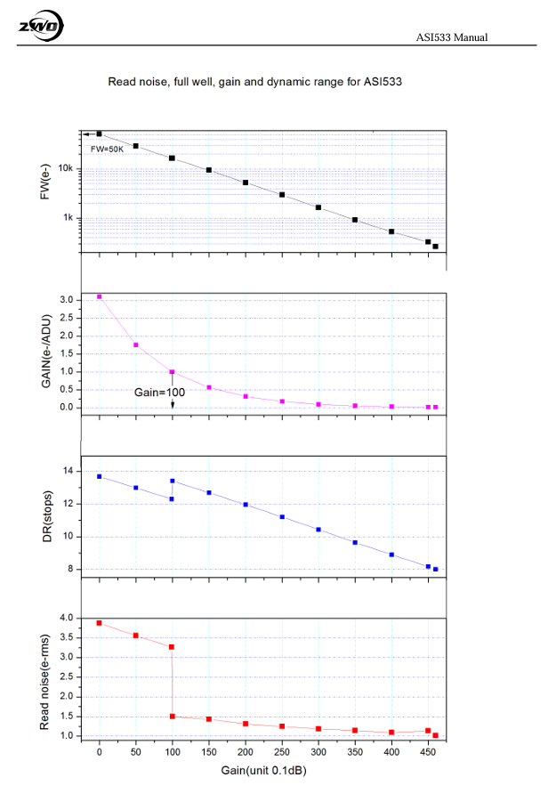

I am doing a competition with 1 second exposures, and am still learning about the Gain settings.  I typically run 100 as the recommended setting for my longer exposures.  I somewhat understand if the gain is adjusted from 100, it impacts the dynamic range and read noise.  But I am not sure what the setting should be on lower exposure times.  Thanks for any suggestions/input.
dkamen 7.44
For one second, it should be the highest possible that gives you a meaningful reduction in read noise. I would say 350 to 400.
Gain 100 (or some use 101) is where you have the most significant gain in reduction of read noise while preserving dynamic range and decent full well depth on the 533MC Pro. You could go higher in terms of gain, but you'll lose quite a bit of dynamic range and well depth, while not gaining much otherwise (presumably your SNR would increase), so it depends on what your goal for the competition ultimately is I guess!

I typically run 102, but with exposures ranging from 180-300 seconds.  1 second is a challenging concept, and I did not know if the gain should be turned up with such short exposure lengths.
dkamen 7.44
It should.
Todd Tucker:
It should. There is no way you will exhaust the available dynamic range with such a short exposure, while read noise is the dominant type of undesirable signal. I would actually be tempted to recommend cranking it up at the maximum value (450+) where you get minimum read noise with plenty of dynamic range available, but don't like how the sensor appears to behave above 400 with the RN actually rising somewhat just before that final drop. Best play it a little safer

Ah I see what you mean now. Yes, I think you could certainly crank it up like others have mentioned.
