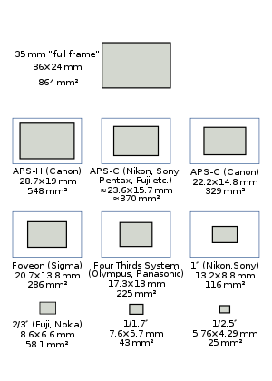

Checking Andy's picture……………so anything under 36x24 is crop ?
dk94041 1.20
Yes, you would need the ASI6200MC for a full frame sensor (~$3.5K)

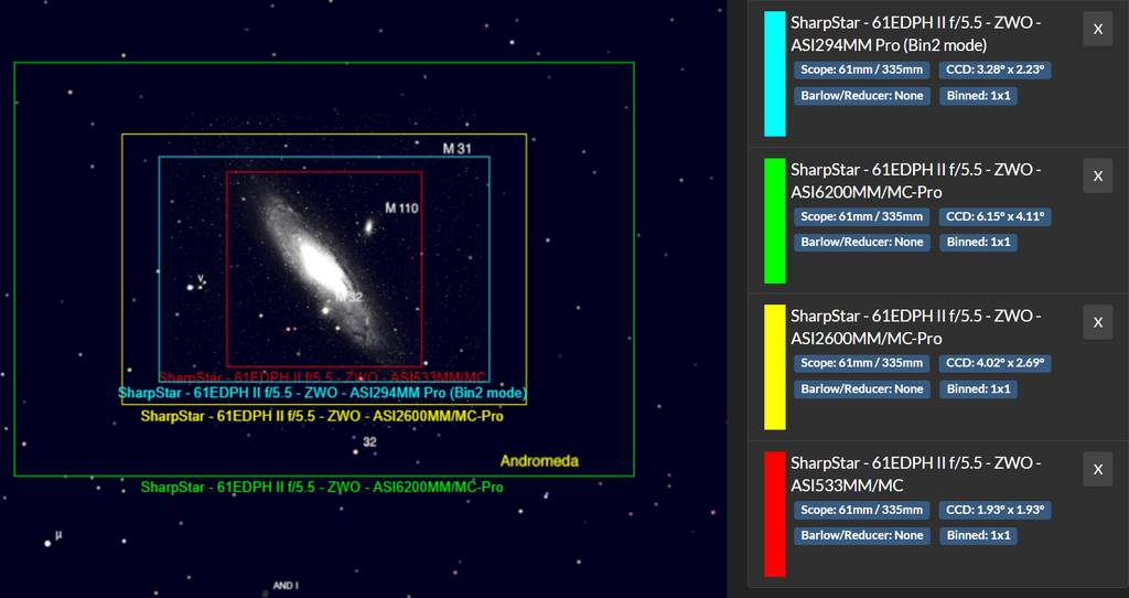

geeklee 3.91
Here's a comparison with the typical sensor sizes used in some ZWO cameras (the 533 sensor is the smallest).  Not sure if the scope you're looking at is identical, but the relative sizes will be the same.
The ASI2600 is APS-C and the ASI6200 Full frame.
