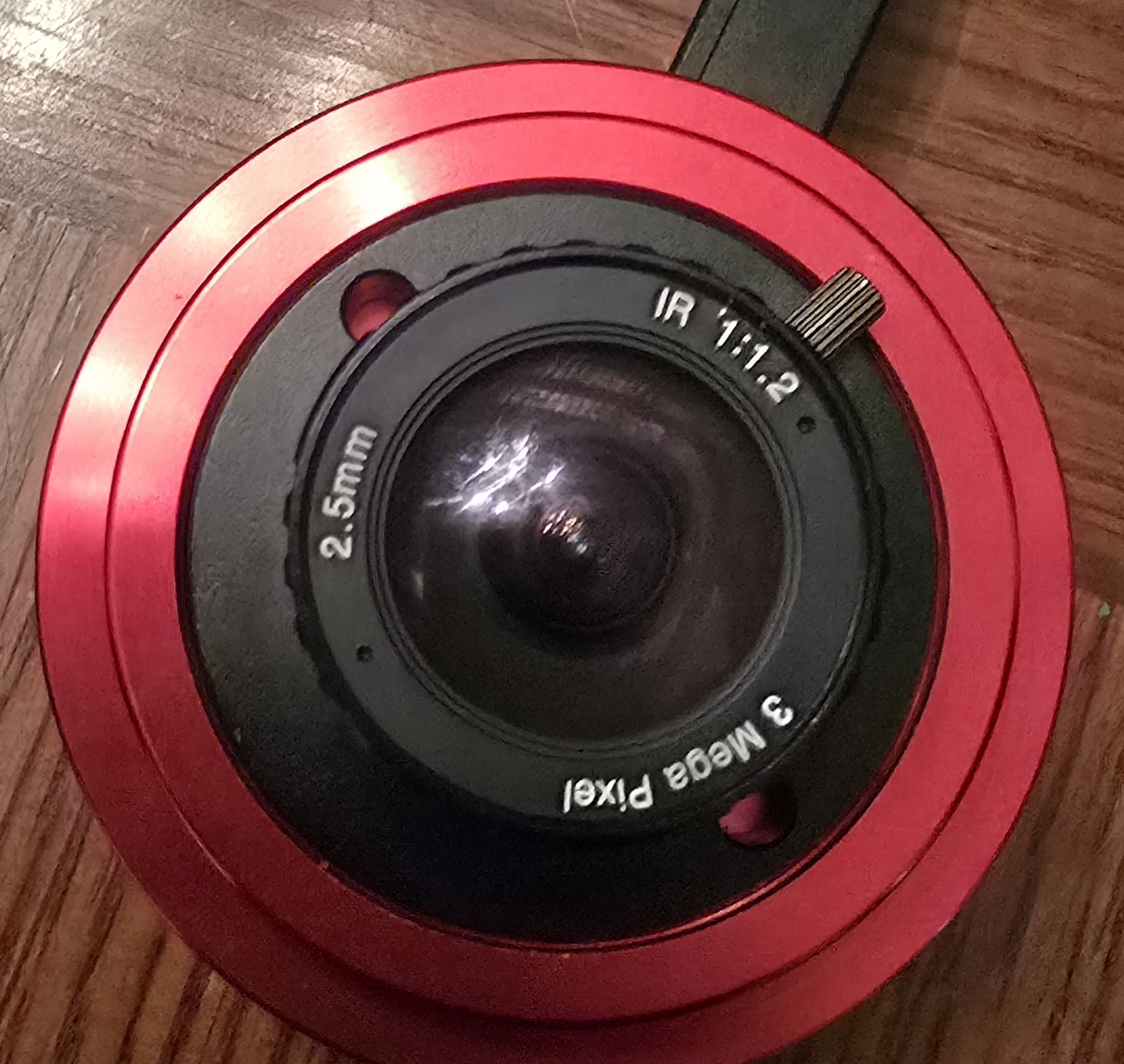

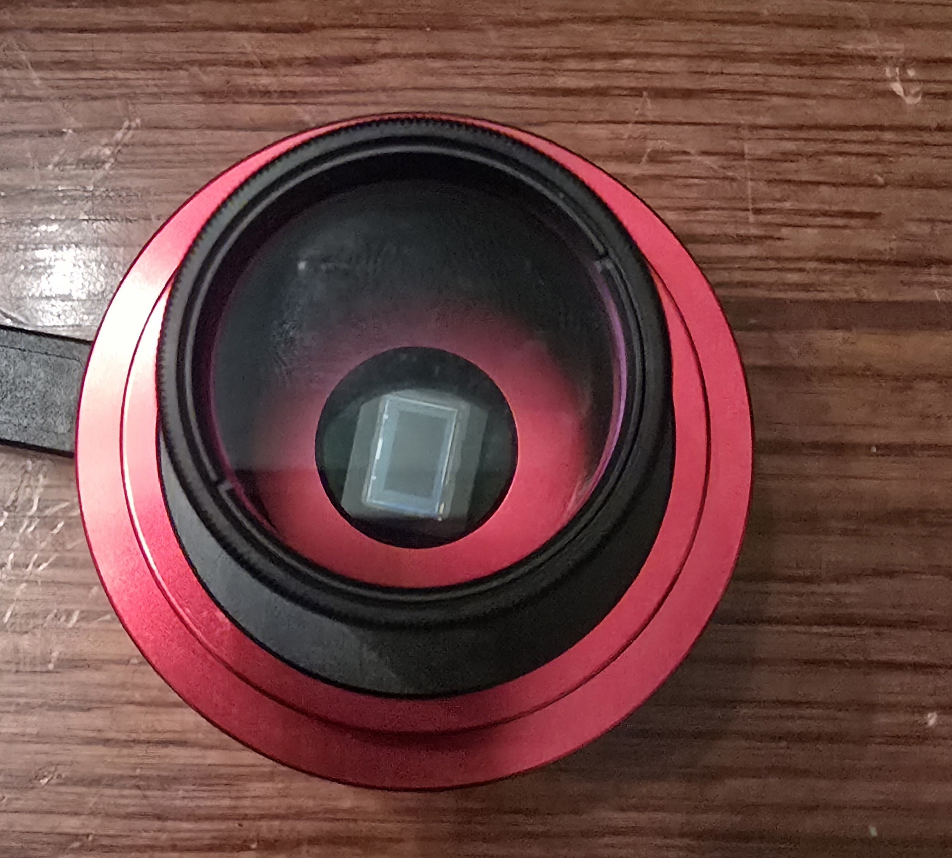

Can we see what is attached to the camera, if anything. I mean, just the camera not the barlow or the scope, just the camera and whatever else is screwed onto it?
*** Sure. I see the 'small dot of light as pictured above without the 1'25 adapter 20250202_183215.jpgon, and with it on, I see nothing. 20250202_182951.jpg***

Can you see anything when the lens is on (2nd pic)? Point it to the ceiling and move the lever to focus, if anything appears on the screen.
avilla54 1.20
*** Yep, I get a very clear imagine with the lens on outside of the telescope. ***
So the camera is working all-right. That's a start. So the main problem for you is focusing. Ignore the barlow for the moment being. Do you have an adaptor to fit the camera with 1.25" adaptor onto the scope (1st pic)? You should have been given one with the scope.

je vois vos photos elles ne sont pas de bonne qualité l'objectif n'est pas propre ou ça vient de moi,
votre adaptateur 1"25 est équipé d'un filtre ? qui n'est pas non plus propre à mon avis
pour la lune vous voyez bien le croissant uniquement  donc vous devez avoir la même chose sur l'écran

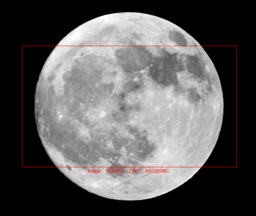

*No way. First off, remove the barlow. The view of the moon (in this case full) is shown here below with your scope and camera:
