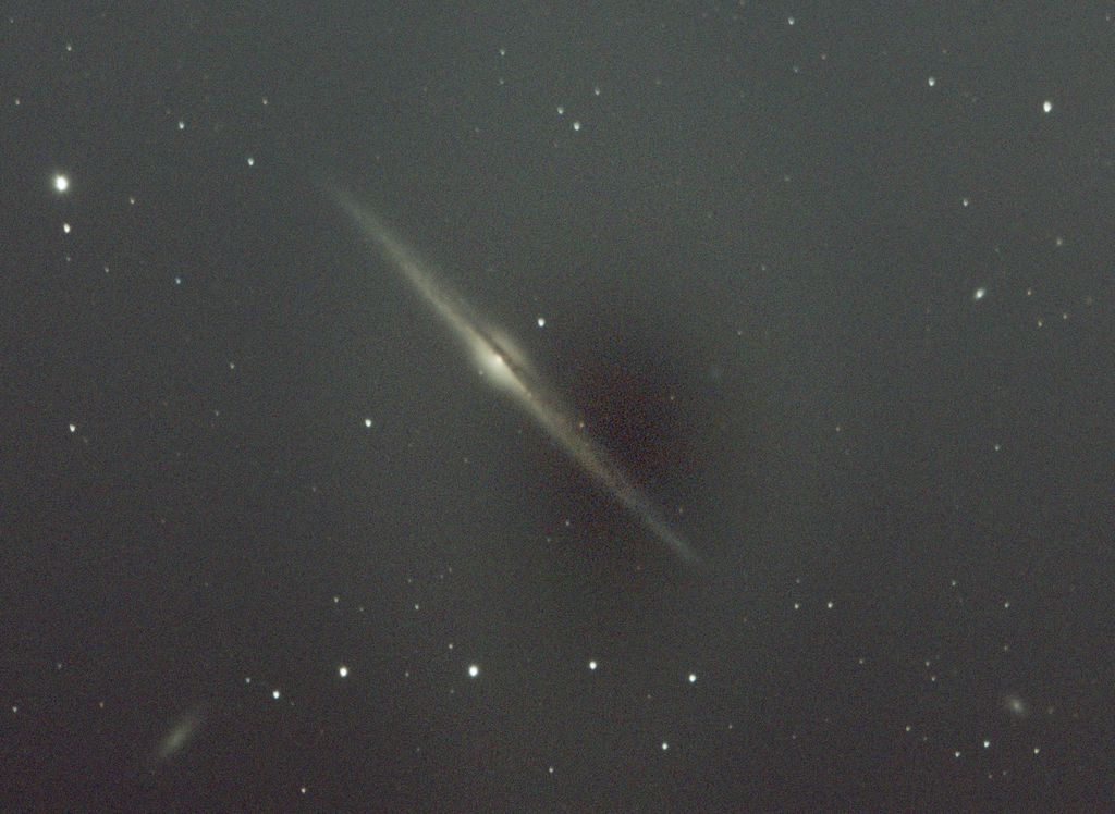

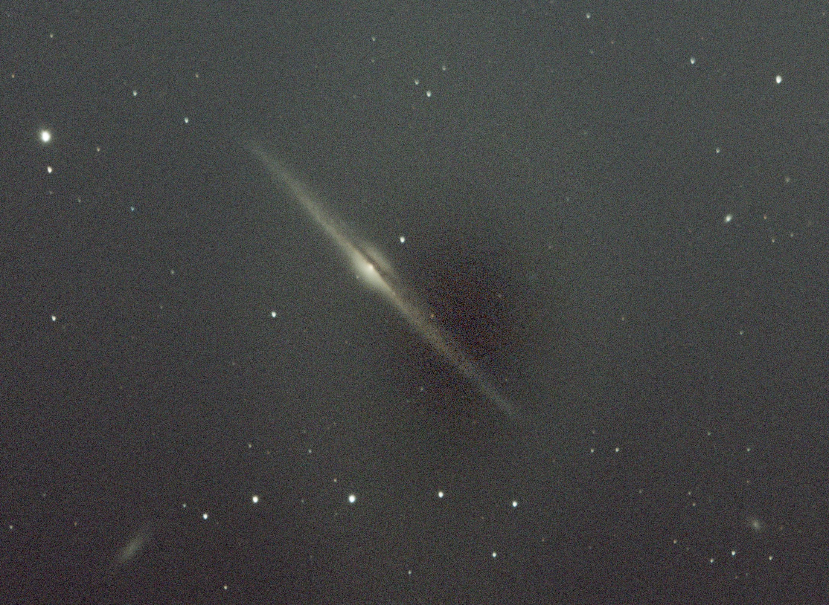

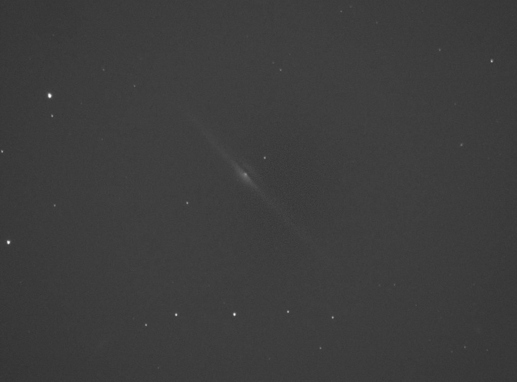

Has anyone seen this before?
C8, ZWO ASI294MC Pro, Starizona Corrector, Optolong L-Pro, NINA Software
C8 Optics are exceptional clean, imaging train has been disassembled and each glass surface absolutely clean.  I see nothing on the camera sensor. This just started showing up. Sensor gone bad?
Single 120 second sub
5 subs stacked and no darks or flats
Mike
