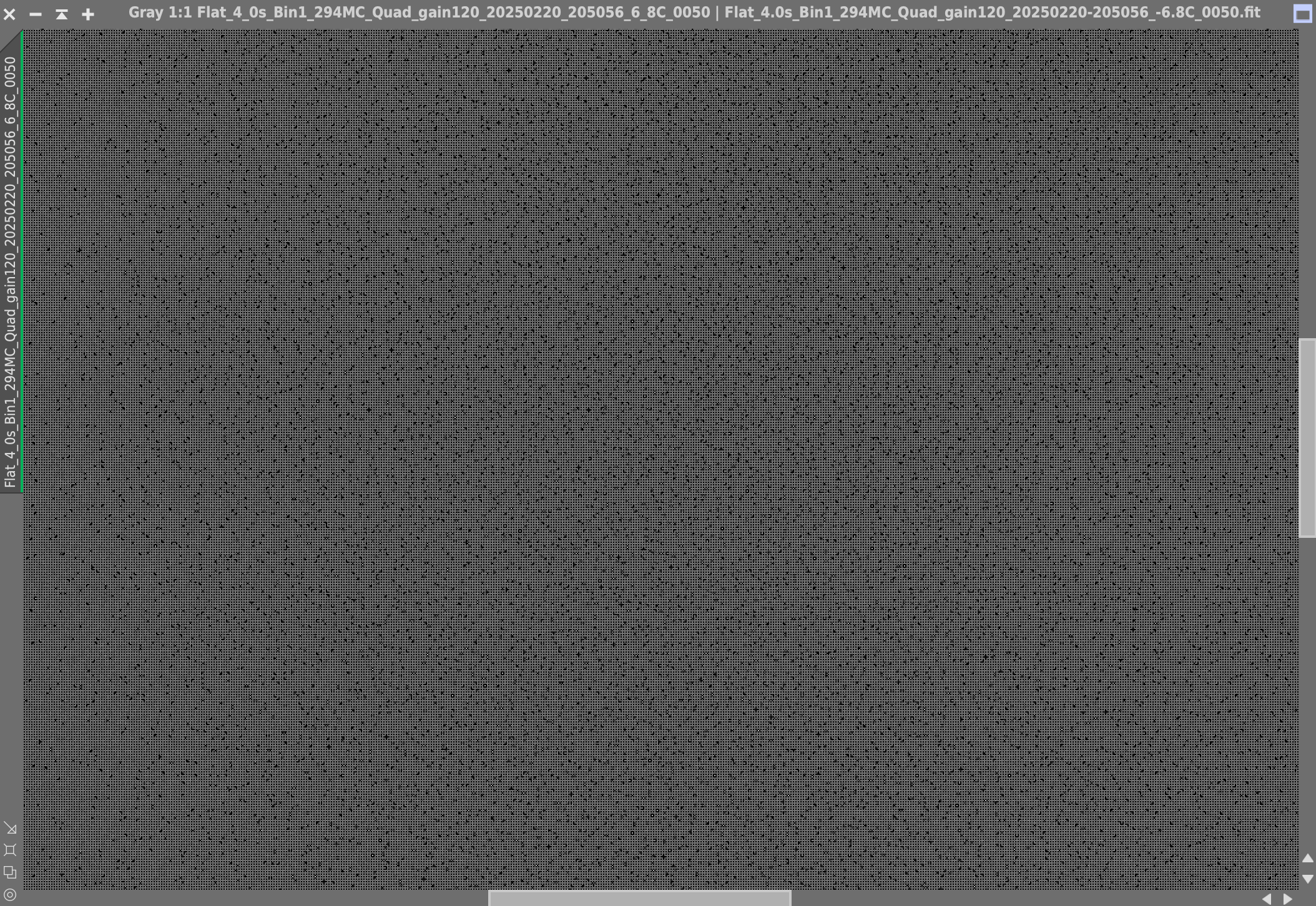

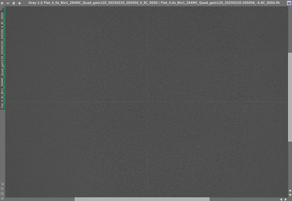

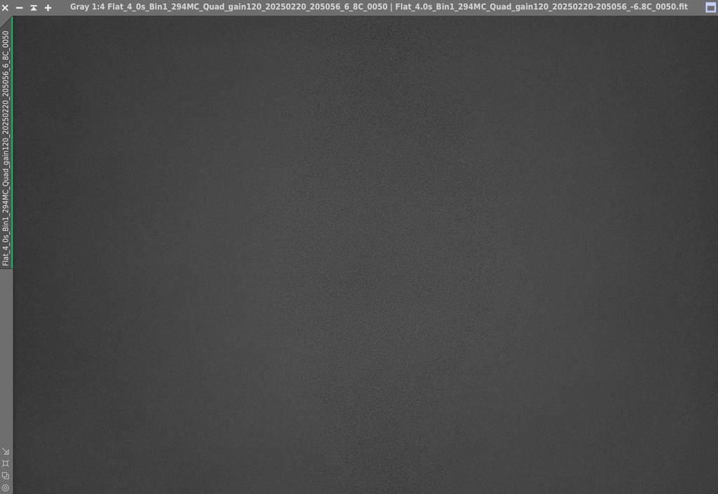

Below is an example of one of the flats at -6C with a STF. First is full flat image, second zoomed in somewhat, third on pixel scale.
Full image:
Zoomed in:
Pixel scale zoom:
