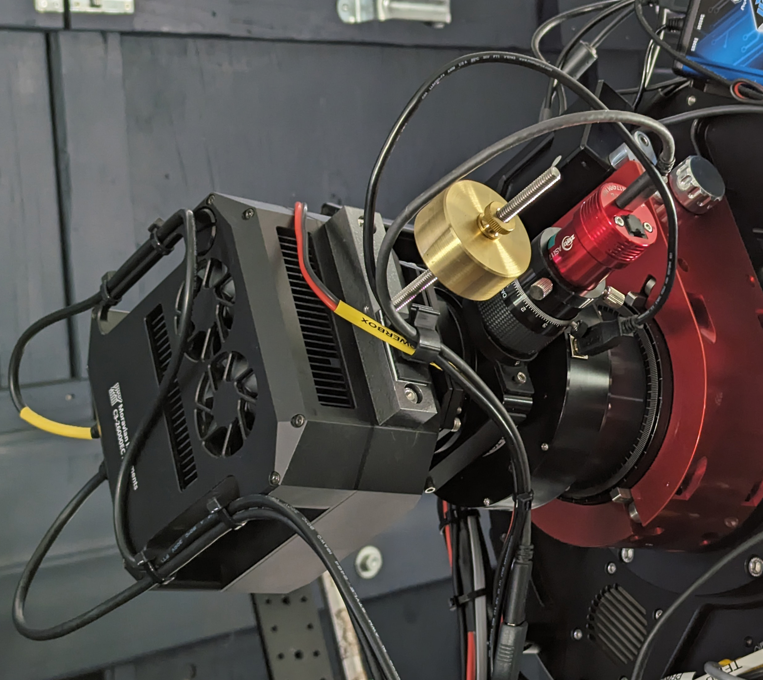

The only things to be aware of with the Moravians is that they are a lot heavier and the weight is off center ( I made an adjustable counter weight). You also have to order the industrial sensor and the enhanced cooling when you place the order if you want those..... Mine is the IMX 571 sensor so can use the internal style filter wheel. The 455 version uses a separate larger FW, of course...
The enhanced cooling pays for itself the first hot summer night!
