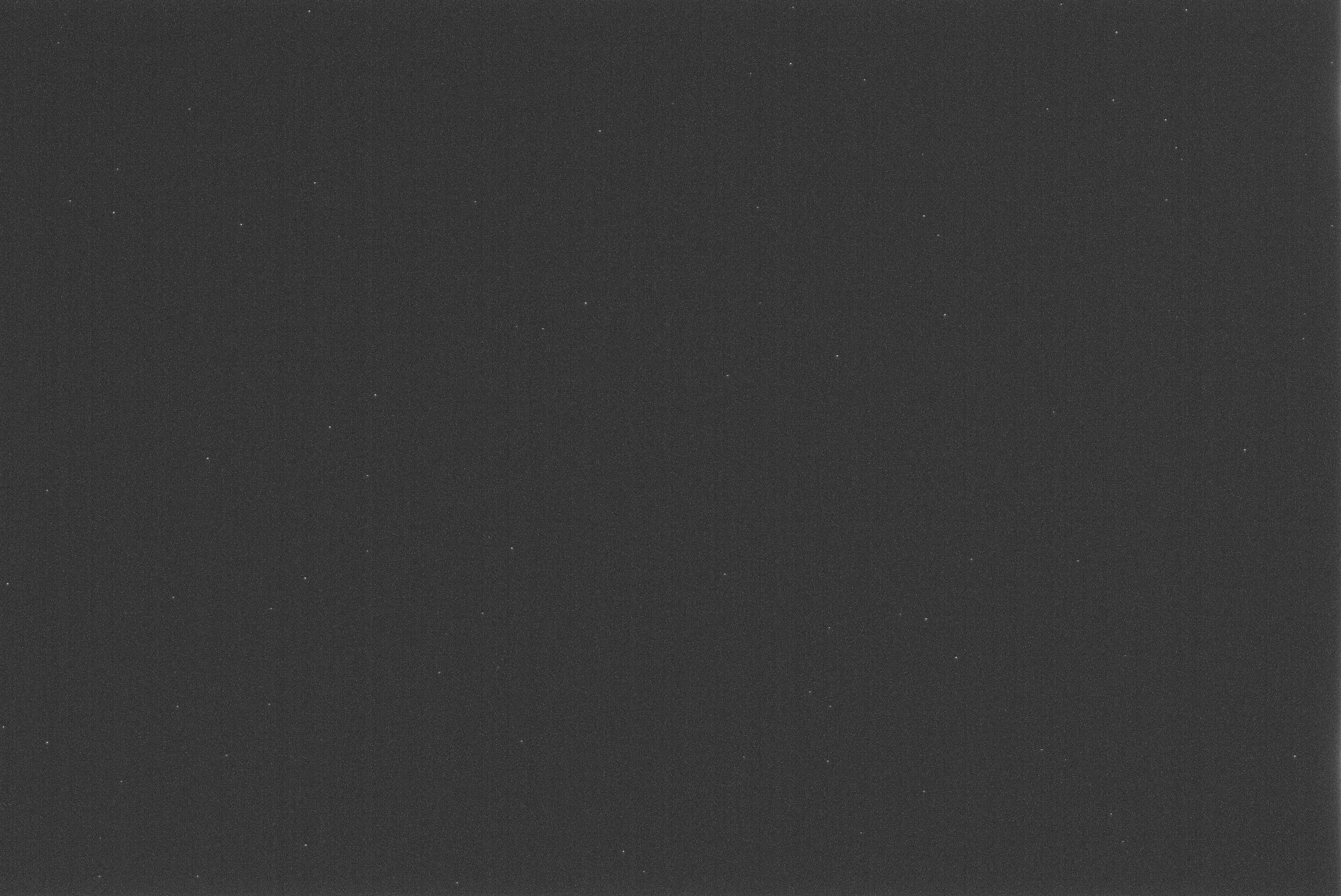

Hi All
I have recently made the switch to N.I.N.A. - and in that process also rebuilt my DARK library.
When I looked over my new 300 sec. master dark made with N.I.N.A. I noticed a, what I believe is a very faint amp glow on the right-hand side of the image.
I thought it was a light leak - check all my other master darks, and notice the same on all of them - growing clearer as the exposure time increased and mostly visible in the stacked final master dark.
Made sure that I test in a completely dark room, with something covering that camera etc. to make sure that there is NO light coming into the camera.
I can find the glow in a single 600 sec. frame as well.
I then checked my old ASIAIR master dark as well - and found it there as well.
Have uploaded both the ASIAIR and N.I.N.A. 300 sec. master dark here: https://drive.google.com/drive/folders/15uA7q9029i0Uk8YklYKOmxQ_uK3_XgiQ?usp=sharing
Has anyone seen something similar?
It's more a coincidence that I notice it - so it has no practical influence on my images.....I think.

It's normal. The IMX571 keeps glow to a minimum but it isn't Non-existant. The longer the exposure the more it'll show. It'll calibrate out of your light frames easily (not that you'd notice it in a light frame anyway).

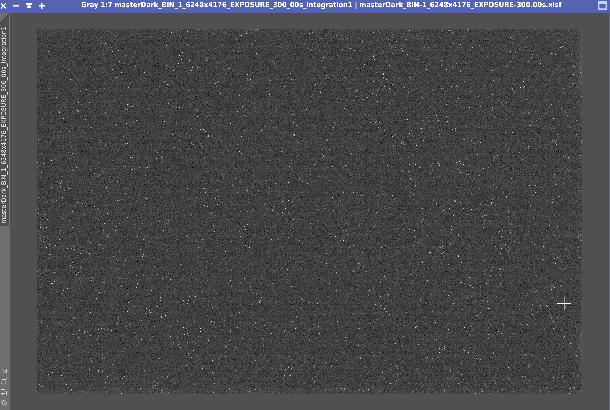

Gary.JONES 6.90
Hi Christian,
I just checked all the 300s darks Ive captured for my 2600MM - I might be one of the lucky ones, but there is so sign of amp glow in the darks at all.
Here is a (normalised) master dark.
Don't forget that your screen shots are of a normalised dark, so anything even a few bits brighter than total black will be stretched to look much brighter than it really is. If you look at the average brightness in your dark, it's about the same as the amp glow, so the amp glow will be swamped by the background noise of the sensor.
Try opening the dark without normalising it, and check the histogram - measure the brightness value in the amp glow regions, it will be very close to 0, 0, 0.
As others have said, the impact will be immeasurably small if your lights are well calibrated.

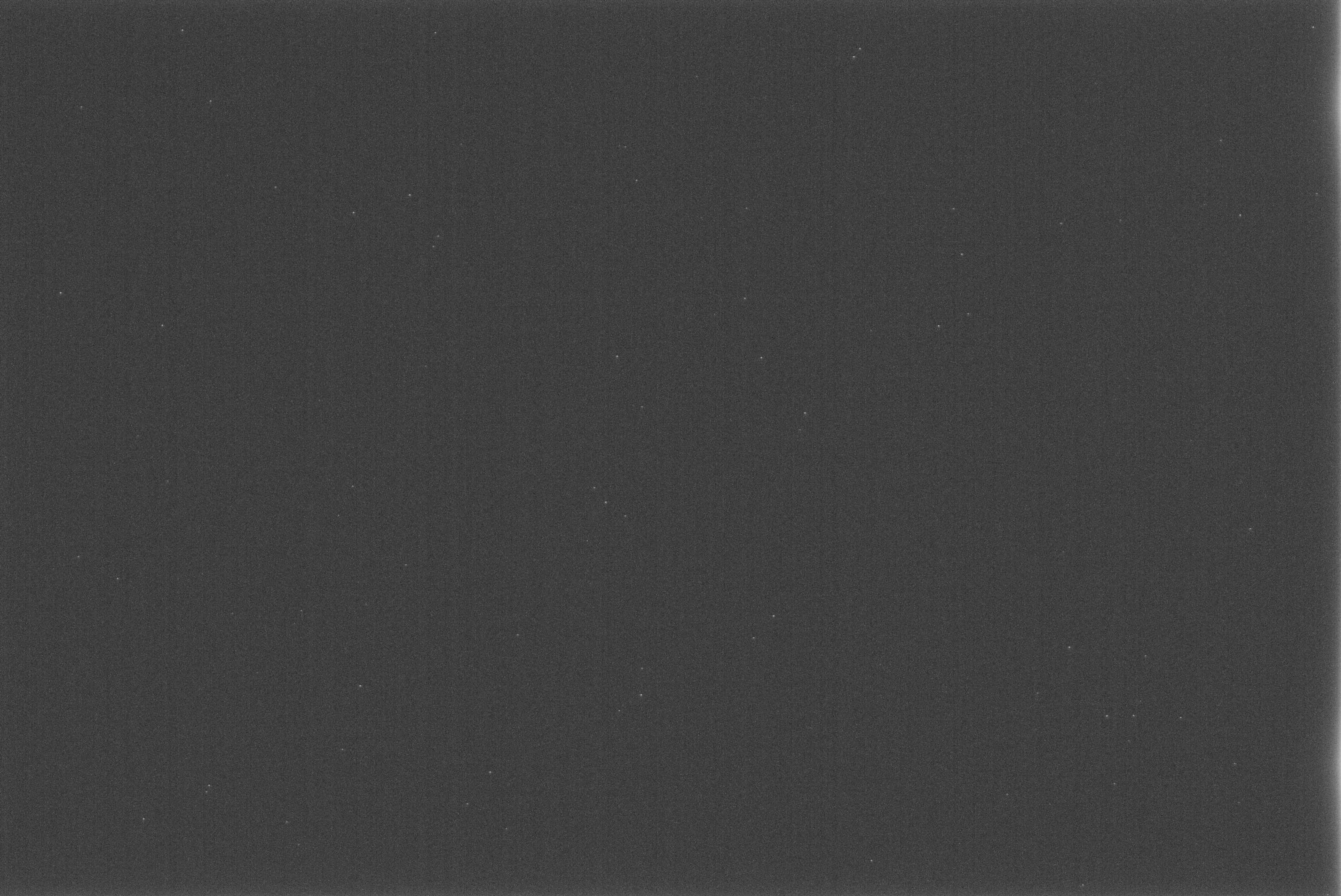

JohnAdastra 1.81
Seeing the same thing in my 2600MM, 300s dark @-15C. Never noticed this until you mentioned. Have not seen any residuals in my master lights so not problem . CS!masterDark_BIN-1_EXPOSURE-300s.jpg

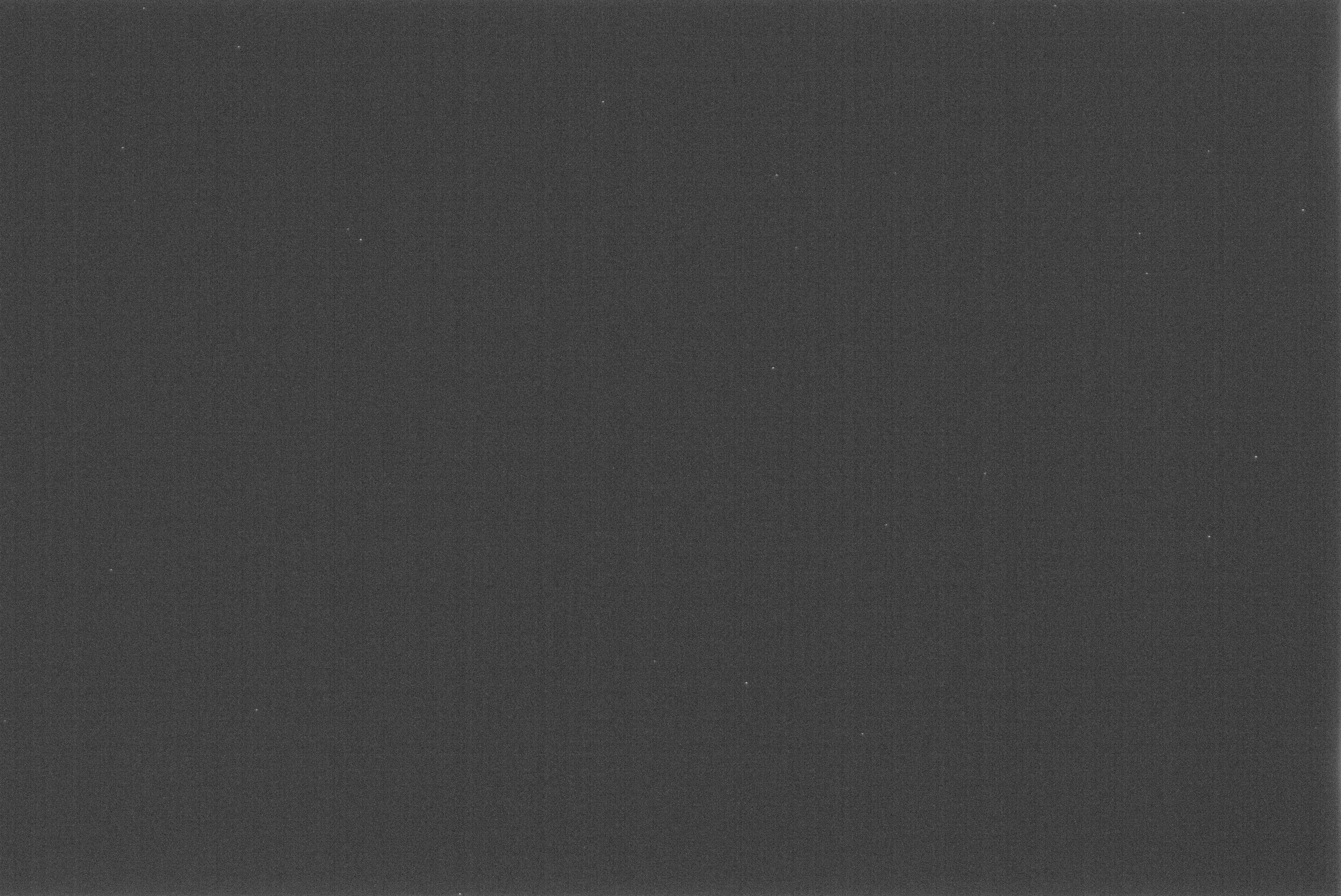

mchersich 0.00
