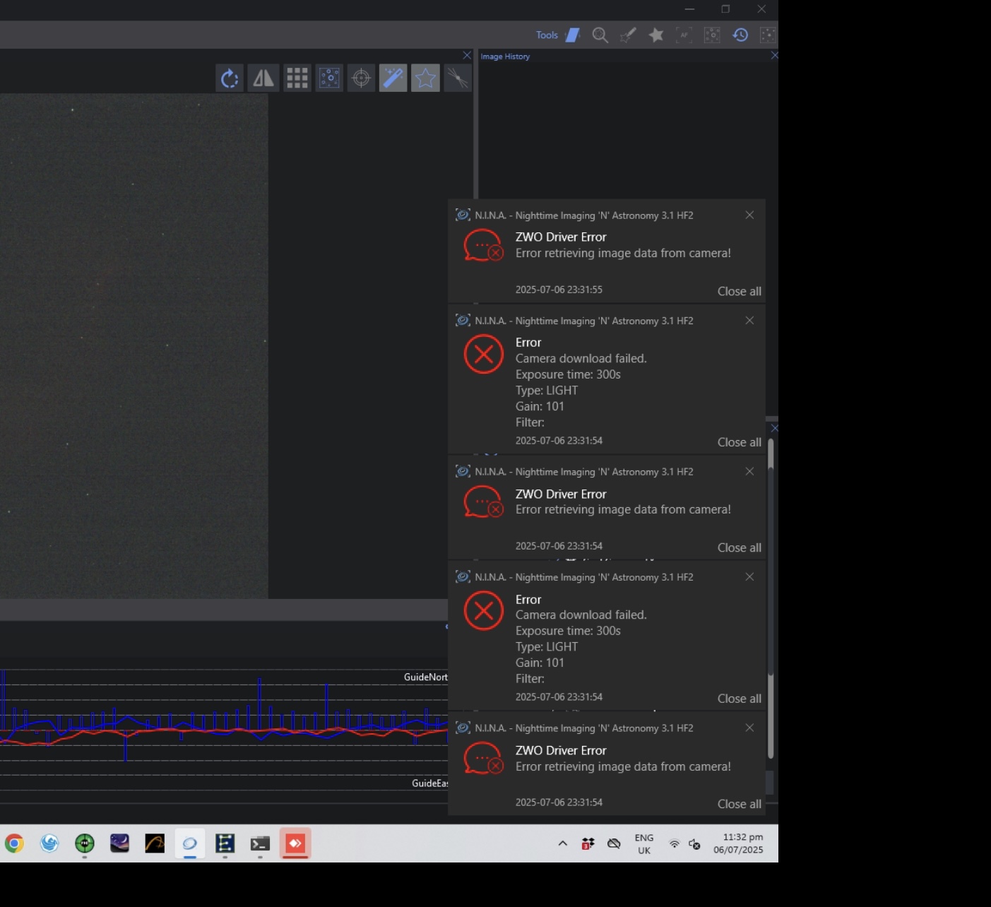

Menelaos 0.90
Any one else experienced this? I am using an ASI2600MC PRO I tried changing the usb port and the usb cable, i also updated all the drivers and i still get the issue. The camera connects for a couple minutes and then disconnects all of a sudden, and it will not connect again unless i unplug the usb and plug it in again. The cooler is also kind of unstable and looks like it is struggling but it gets to the target temperature eventually. It happens when it finishes an exposure i think. It happens during short 1-5s exposures and longer up to 300s. When it happens the camera seems to still be detected by the pc but it just doesn’t communicate. I am using mele quieter 4c mini pc and i connect the EAF on the camera. I tried the ASI AIR and it looks like it has a stable connection over there. Any ideas?

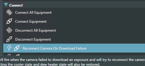

I don't know if this helps, but if you use NINA, use the Connector plugin and it allows a trigger if it fails to download it will reconnect.  My ASI cameras all do this as well, multiple across muitple setups, powerboxes, etc.  Maybe once or twice a week during an evening and this has solved it for me by reconnecting once it fails.  Sorry if this was already suggested.
