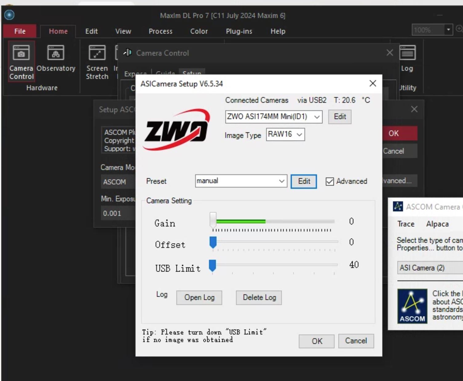

Hi, Found this thread and am trying to optimize my guiding with a new version of Maxin DL (7 versus 6). I am using a C11 and their large chip OAG. Generally worked OK with V6 of Maxim and ACP, but now the stars are too bright and the guiding has gone south. I want to use the new version of Maxim which is 64-bit to better handle my large ASI 6200 images. ZWO support suggests: RAW 8 Gain 189 Offset 90 USB limit 48 I have not been binning. Do you experienced users suggest 2x2? Thanks in advance for any help.... BTW... how do you read the gain # precisely????  |
