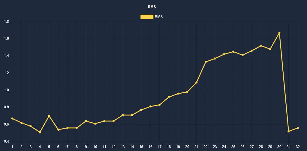

Hi All,
I have an AM5N mount with no counterweight and a payload of 17 pounds. I have attached a screenshot of guiding RMS error versus subframe number from last night. Each sub is 600 seconds. The target (SH2-114) starts low in the NE and rises toward the meridian. As you can see from the plot, the guiding errors steadily increase until frame 31, which is the first sub after the meridian flip. My guiding is usually 0.5" - 0.6". Any ideas what is going on? I should also mention that the majority of the error is in the RA axis.
I have never seen this behavior before and it has only appeared in the last few sessions. My first thought is some sort of mass imbalance, but it is hard for me to verify that since my scope is at a remote observatory.
Jim

From the graph you provided it does seem that something has come out of alignment. If it were me, I'd try guiding on a target in a different part of the sky and see if the behavior replicates. Of course, I'd also want to visually inspect the rig to make sure that the guide scope hadn't been moved (think flexure and how that can impact guiding).

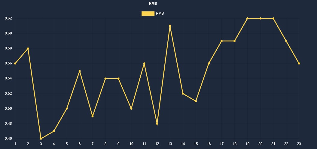

I ran an experiment last night. First I tracked M51. I selected this target because it already had crossed the meridian by astronomical dark. As expected, the mount tracked normally (<0.6"). The plot shows guiding RMS vs. subframe number for M51. Each subframe is 10 minutes, so nearly four hours of tracking data.

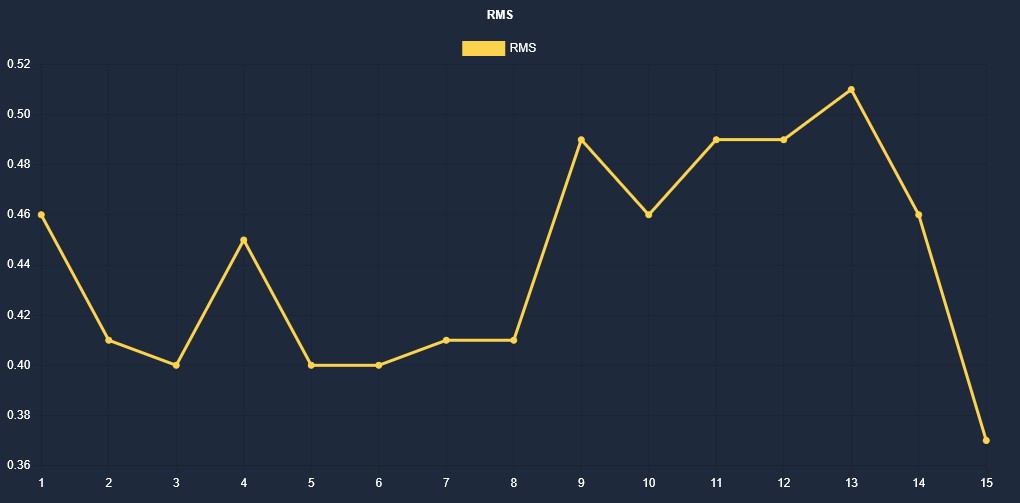

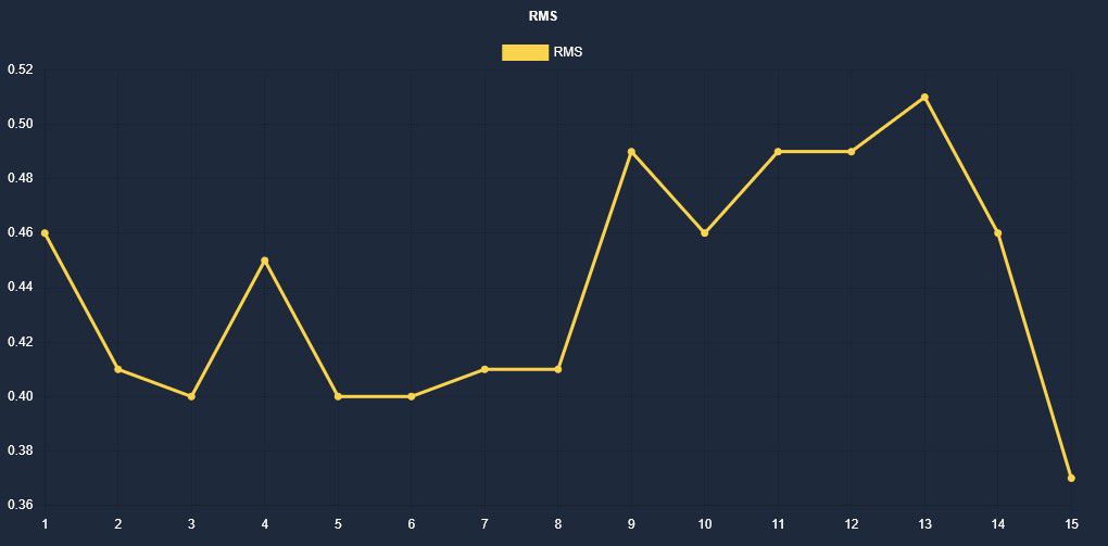

Next I imaged NGC 7380, which was still rising in the east and had not crossed the meridian. I figured that once again the guiding errors would increase as the target approached the meridian, but that is not what happened! The mount tracked just fine with errors typical of what I have experienced in the past (<0.5"). The plot below shows this. This about 2.5 hours of tracking data.
