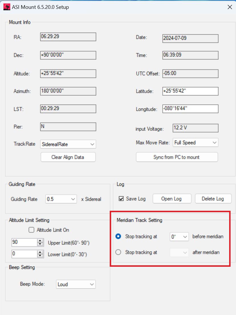

i come from asi air pro plus , and it is my first time configuring the meridian flip in NINA  and ZWO ASCOM
the point is with the zwo firmware 1.5.2 we have this setup inside the red frame
 what should be the approximate values and also in NNA
yesterday i used this configuration  ( inside the red frame) and  minutes after meridian  1 min and max, minutes after meridian 6 min  in NINA
 worked  but i did it inside the  house , so im not sure yet

It should be the other way around. You need to set your AM5 to track 4-5 degrees past the meridian, and try to get NINA to flip at 0 degrees. The reason is becaue if the AM5 stops tracking before NINA issues the Meridian flip command, then it won't flip. NINA refuses to issue a meridian flip to a mount that is not tracking for some safety related reason. Also it is important to make sure you sync your mount and PC times. IF they are off by a few minutes it can cause confusion and problems.
As Brian said, Harmonic drives will destroy your gear if they crash. I just don't risk it and just flip at 0 degrees after I made sure to test it before letting it run.

You do NOT want to run a harmonic into the pier/tripod legs.   They will destroy your gear due to the massive torque they have.  ZWO claims to HI
thank you ,Brian for you answer
i connected two laser sensor to the am5  power unit , for temporary security while i playing  with NINA meridian flip
if the OTA Or any parts of it cross this line ( 3 inches ) before to hit the  tripod legs , cut the am5 power main and stop
thank you for you advice
 clear skies , Brian
HI  , thank you for you answer
so you recommend to setup   stop tracking at  4-5 degrees ( around 16min to 20 min) after meridian
thank you so much
clear skies, Brian

Not exactly. I recommend that you set it up to flip at 0 degrees past the meridian inside NINA, with maybe a max of 3 minutes, and then in the AM5 set it up to track 4-5 minutes past the meridian. You have to make sure it is safe to track that far.
The idea here is to have NINA issue the command to perform a Meridian flip BEFORE the AM5 stops tracking.
thank you so much
clear skies, Brian
thank you , i will try today
