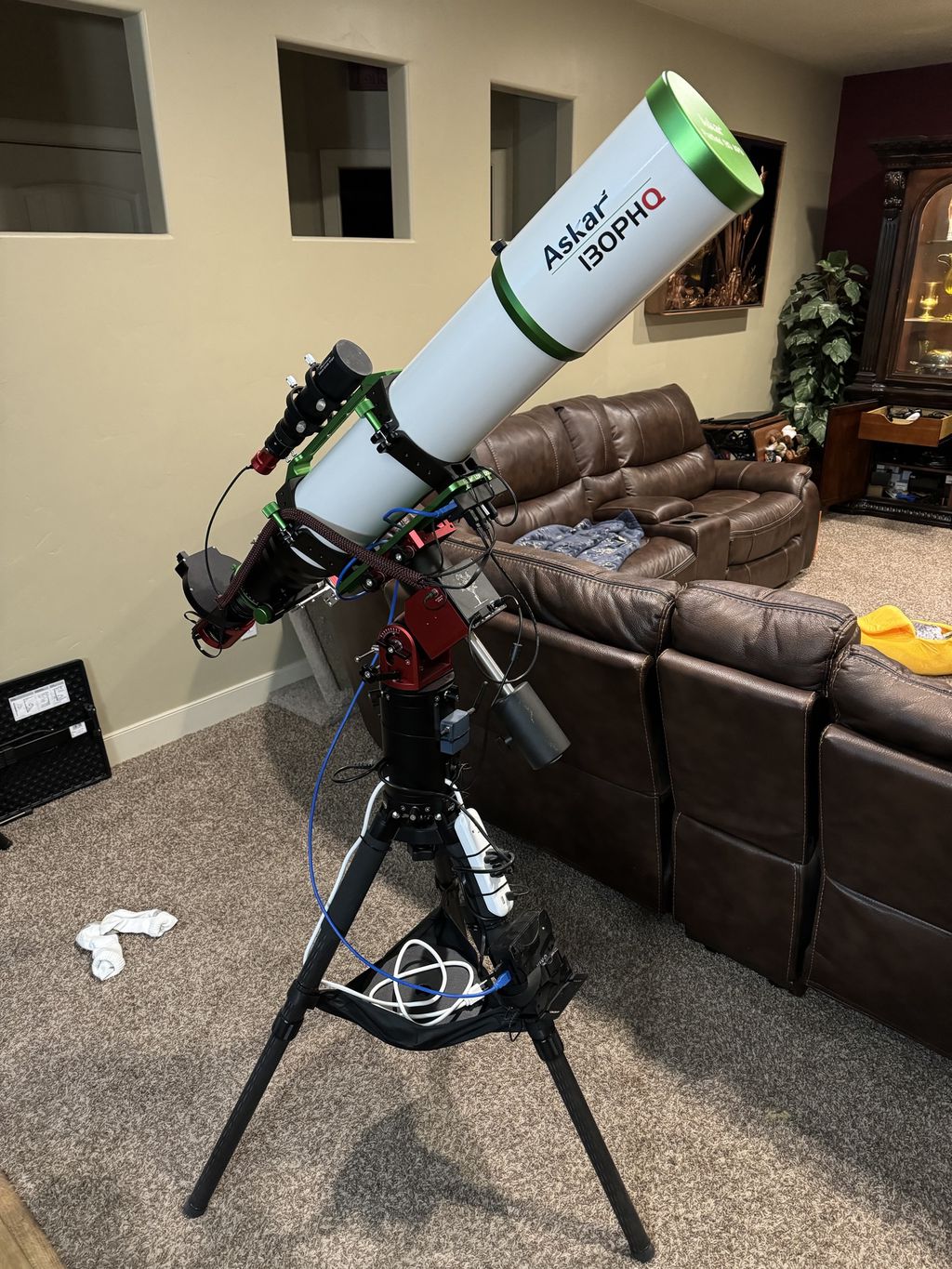

I'm considering buying an AM5N soon and am looking at the Starfield Tri-Pier 1000, which comes with a 3/8" mount adapter. Currently, I'm only putting my Redcat on it, but eventually I'd like to put an Askar 130PHQ on this setup.
Two questions:
1) Can this setup manage the weight of this Askar (or ZWO FF130, they are the same) astrograph?
​​​​​​2) Do I need to buy the ZWO PE200 pier extension?

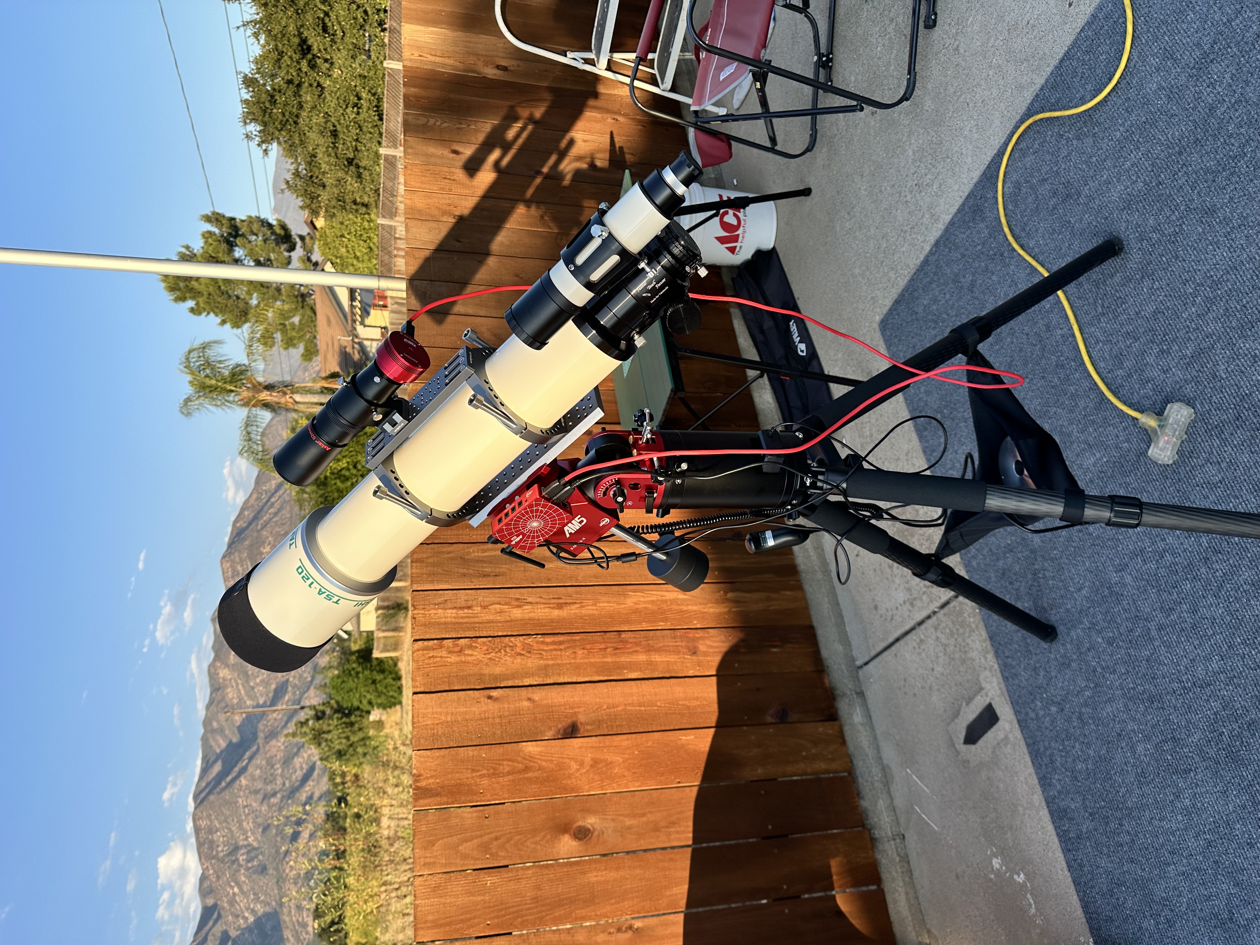

My configuration includes an Askar 107PHQ (a few cm's shorter than your 130) on the AM5 with the ZWO TC40 tripod and the PE200 pier extension. I operate from a hi-rise apartment balcony and travel to an observatory site 45km distant… so this configuration works well for me.
The AM5 will  cetrtainly manage the Askar 130PHQ however you will most likely need the PE200 pier extension; I need it with my OTA and ASI2600MC-P attached - without the pier extension, my OTA/cam would hit the tripod leg while imaging higher altitude targets…. also allows for comfortable vertical slew to take my flats calibration frames.
There have been incidents reported on other forums of tripod-OTA collisions without using the pier - be safe-not sorry…. and enjoy your 130PHQ.

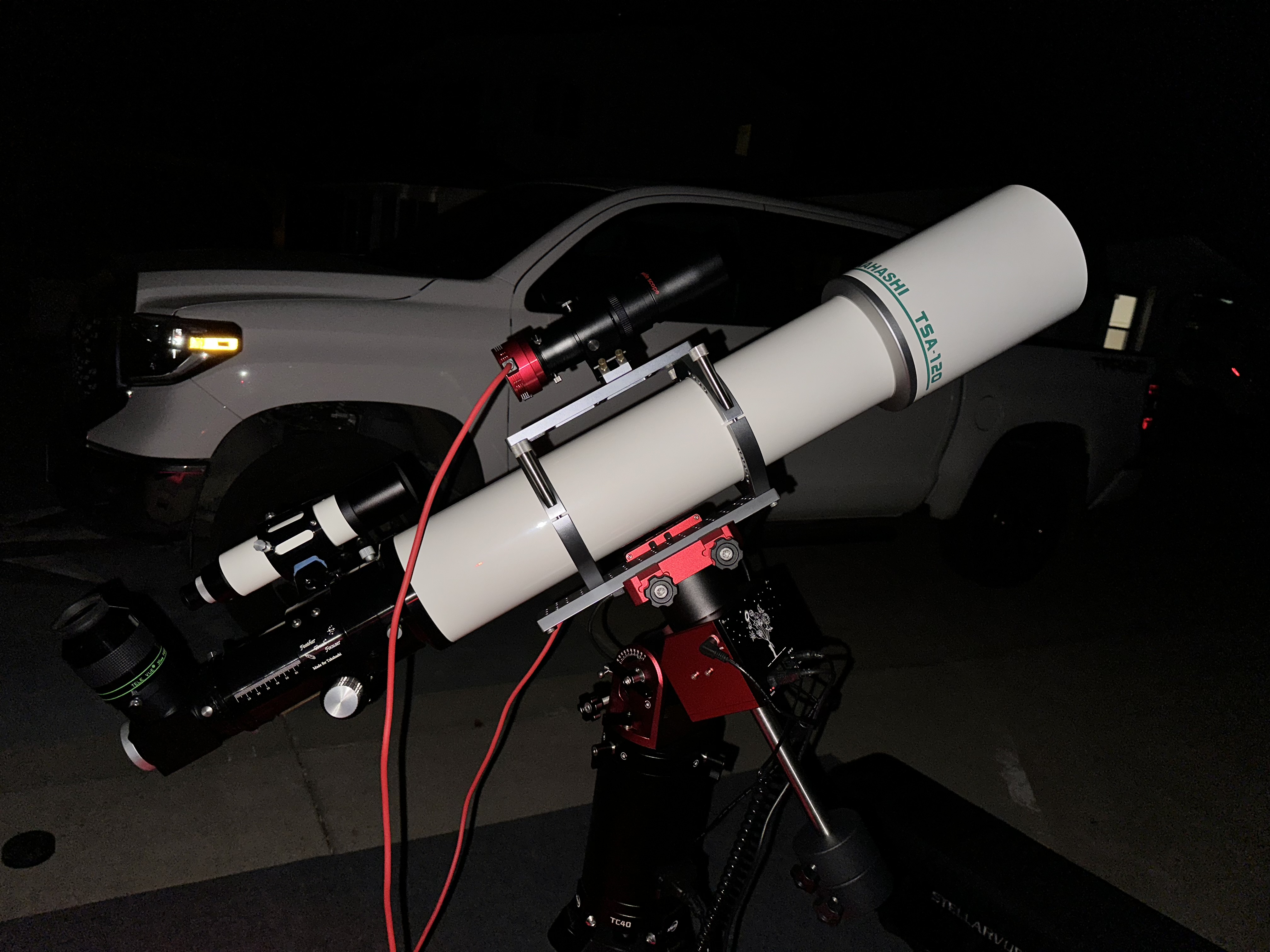

I mount a Tak TSA 120 with feather touch focused , D plate, rings, and visual appliances( diagonal, eyepiece etc) on my AM5. I use two small counter weights on the shaft. I have the pier and extension. It all works perfectly all night, or all day when solar viewing.

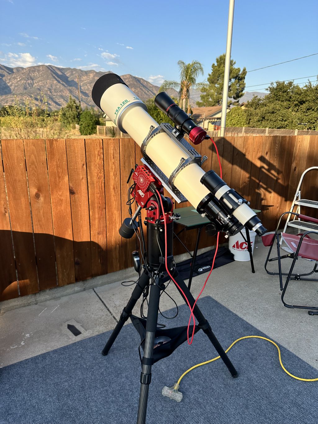

I wouldn’t hesitate to just use just the 3/8” bolt with something small like an 80mm scope or redcat but there is no way I would risk it for a scope over 100mm… (I frequently use my AT130EDT with my am5)

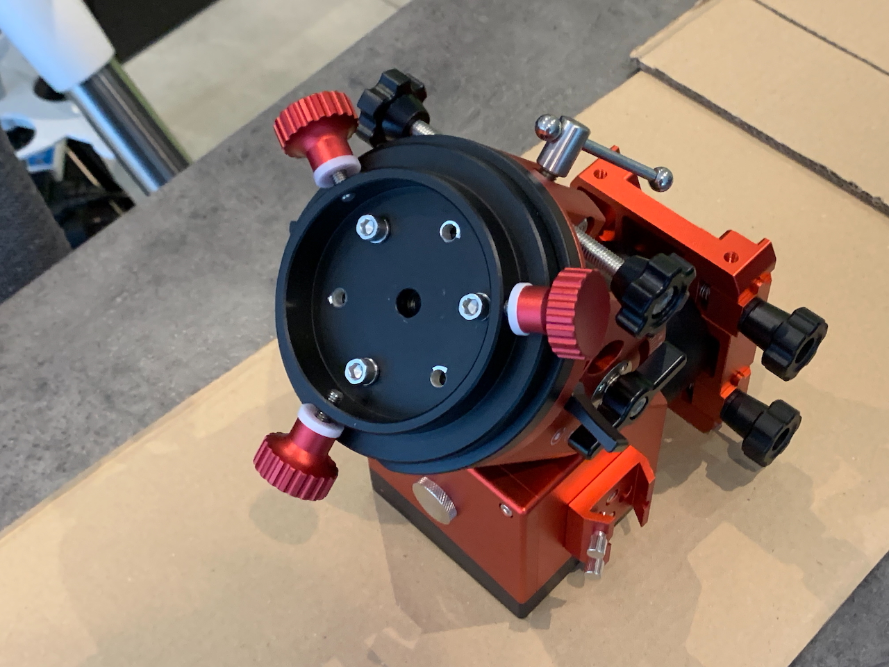

For what it’s worth, I’m upgrading mine to a cq350 on the SW tri pier. This just doesn’t feel solid enough.IMG_2149.jpeg

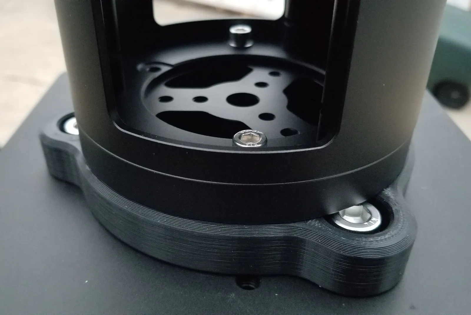

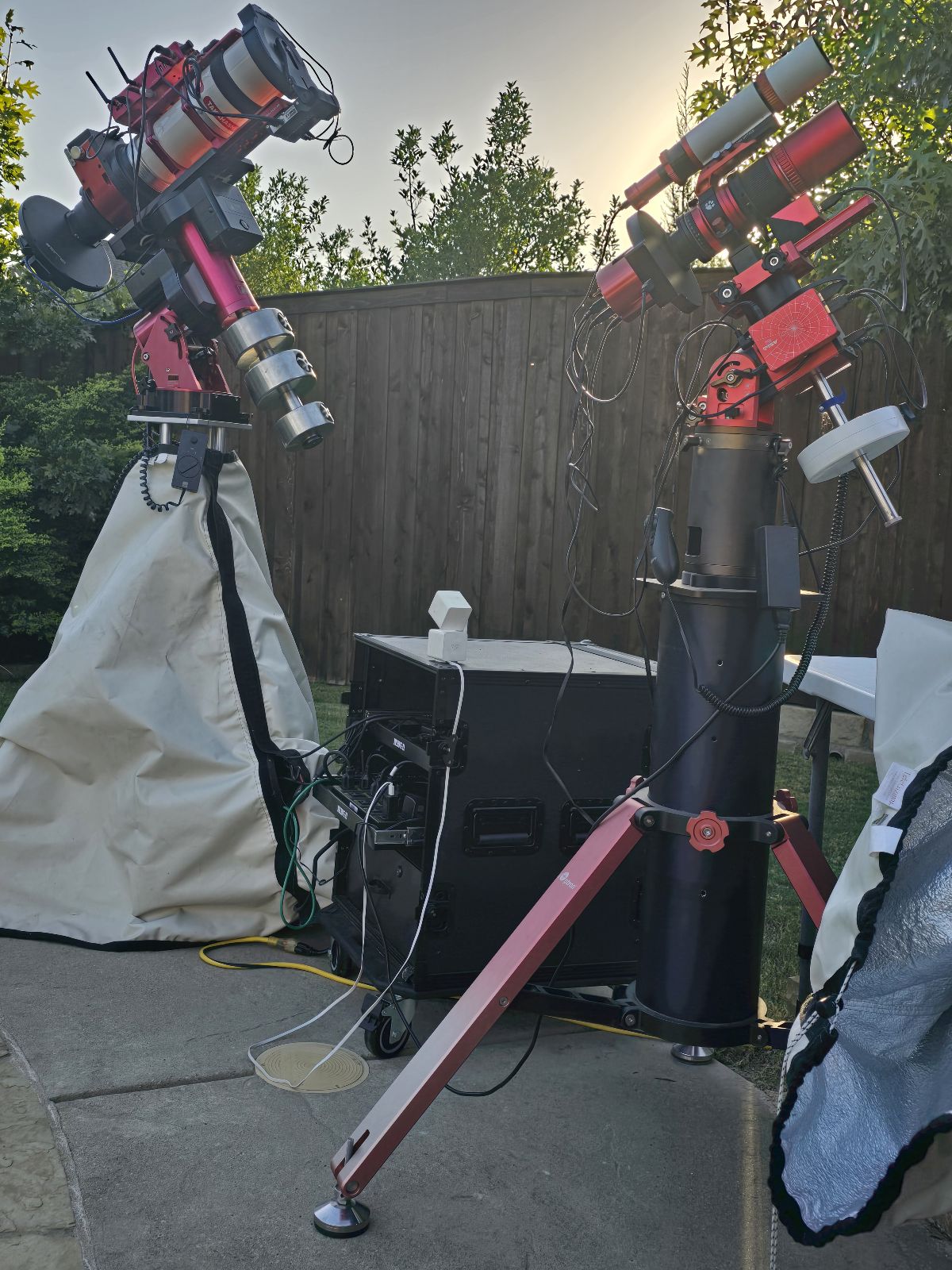

I think I know where you are coming from.  While the TC40 tripod is a wonderful, light and easy to carry in tripod, I was getting sick of having to polar align my scope everynight after I took my telegizmos365 off.  I decided to try and find something more sturdy and found a Ioptron 360.  Here is a picture of it (on the right) with the P200 pier extension and my Redcat 51.  I havent had to polar align again since the night I set it up....
P.S. I have also mounted my Tak FSQ106 and EdgeHD 11" on it with no issues.
ojaigsguy 2.41
Scotty, very nice set up.  I already have the P200 extension, if I bought an Ioptron 360, what additional adapters would I need to mount my P200 on the Ioptron 360?  Thank you. Jeff
Scotty_Maxwell 0.90

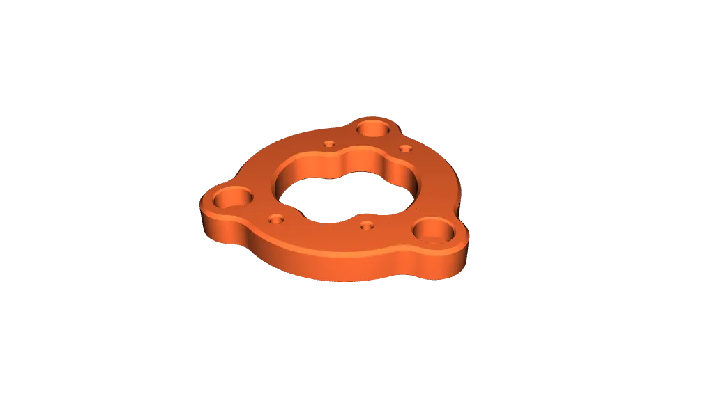

I used this Jeff:
https://www.printables.com/model/329484-zwo-am5-pe200-pier-adapter-for-ioptron-piers
Took about 1.5 hours to print.  If you don't have a printer there are places like craftcloud that you can get to do it for you.
https://craftcloud3d.com/
if you aren't comfortable with that... I could be persuaded. ;)
-Scotty

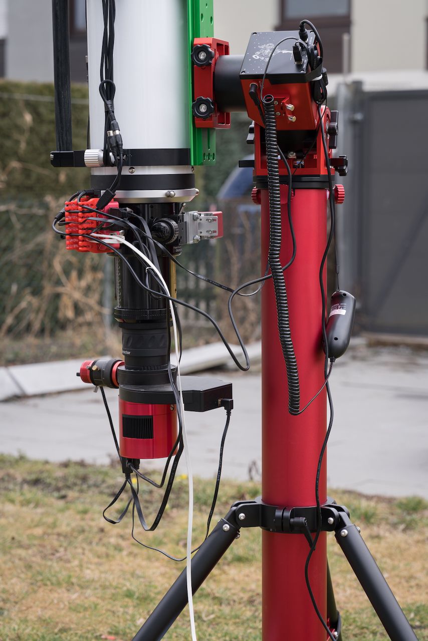

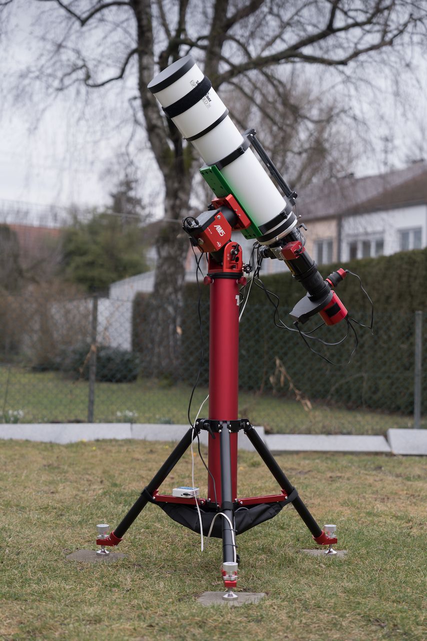

dweinbrenner 4.79

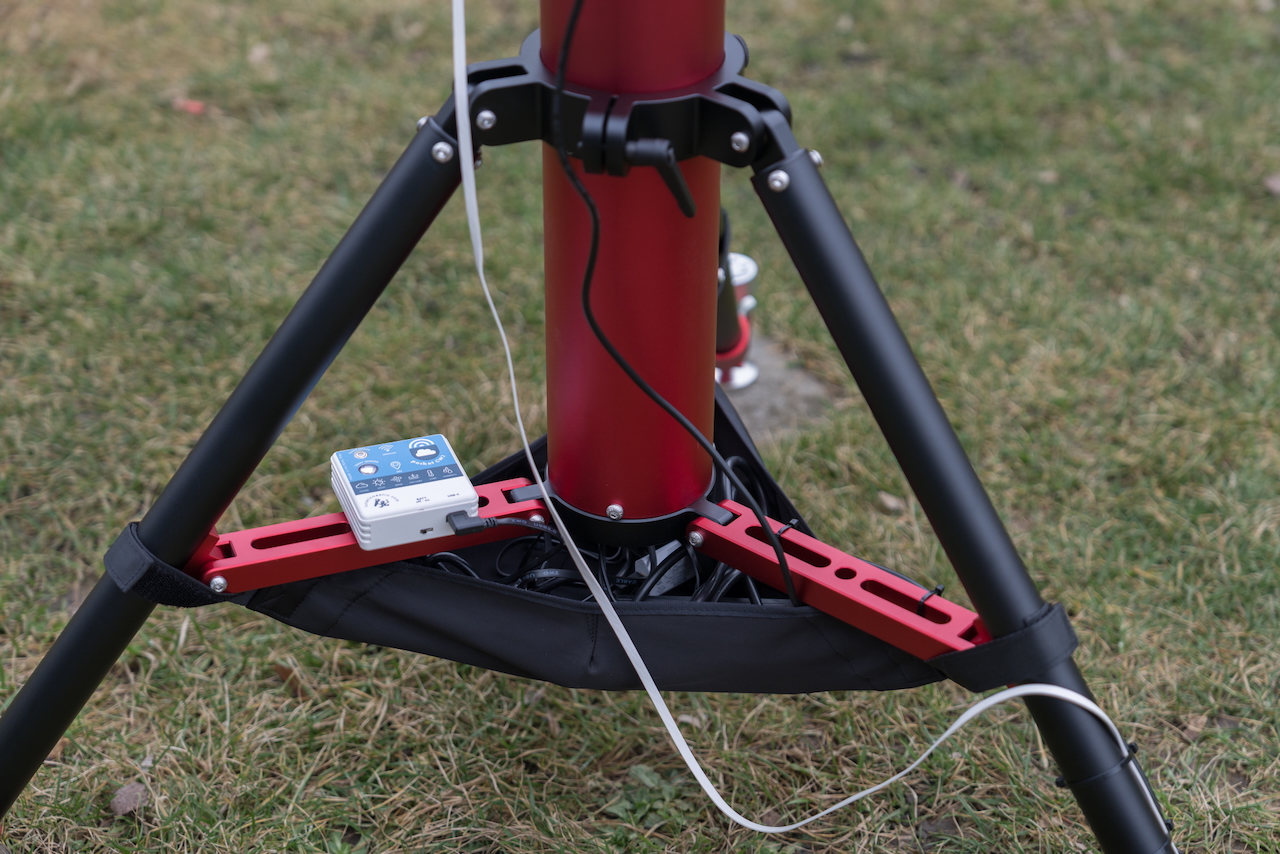

I use the TS TriPier with a customized 3/8 adapter plate. I drilled out holes in the plate to mount the AM5 using its three bolts.
The tripod bag of the TC40 is placed underneath the leg spreaders for the power and cable stuff.
No more collision risk at zenith.

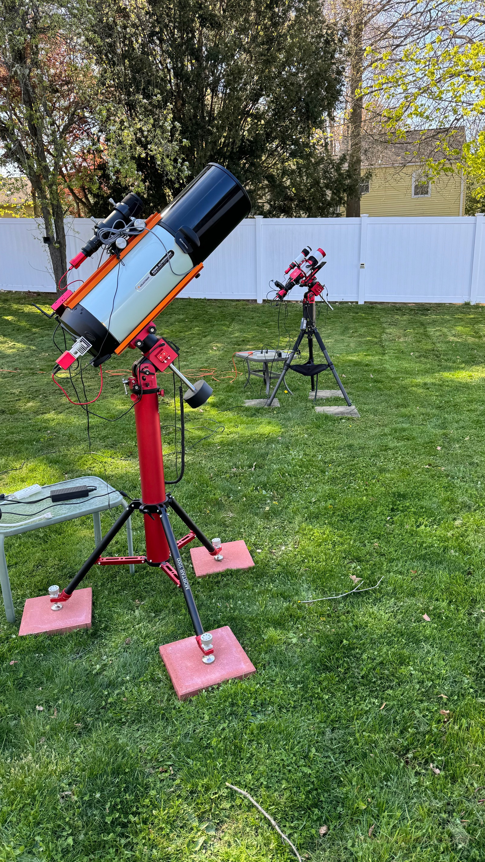

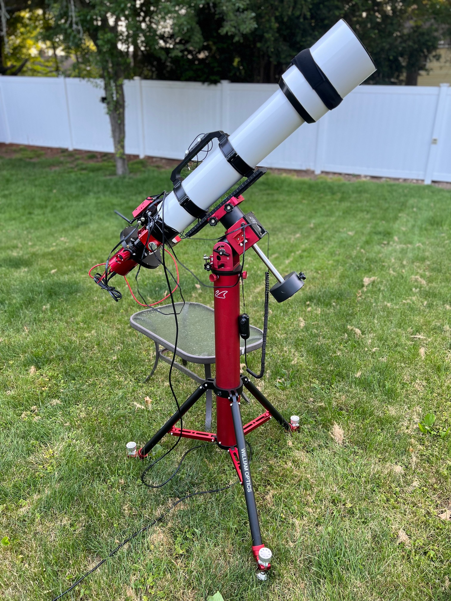

Nkefalas 1.51
Here are some pictures of my WO Mortar 1000. I dont know why WO stopped making these. I can only assume that the timming was off in terms of marketing since the AM5 had not yet been released. I actually picked mine up at a discount. Picture below with my RASA 8 and ES127 FCD100.
Solid mount. I also have an Ioptron tripier that i use with my new AM5N and Edge 11.
dweinbrenner 4.79
The WO pier is the same as the TS one. They're all from the same OEM manufacturer, just branded differently.
