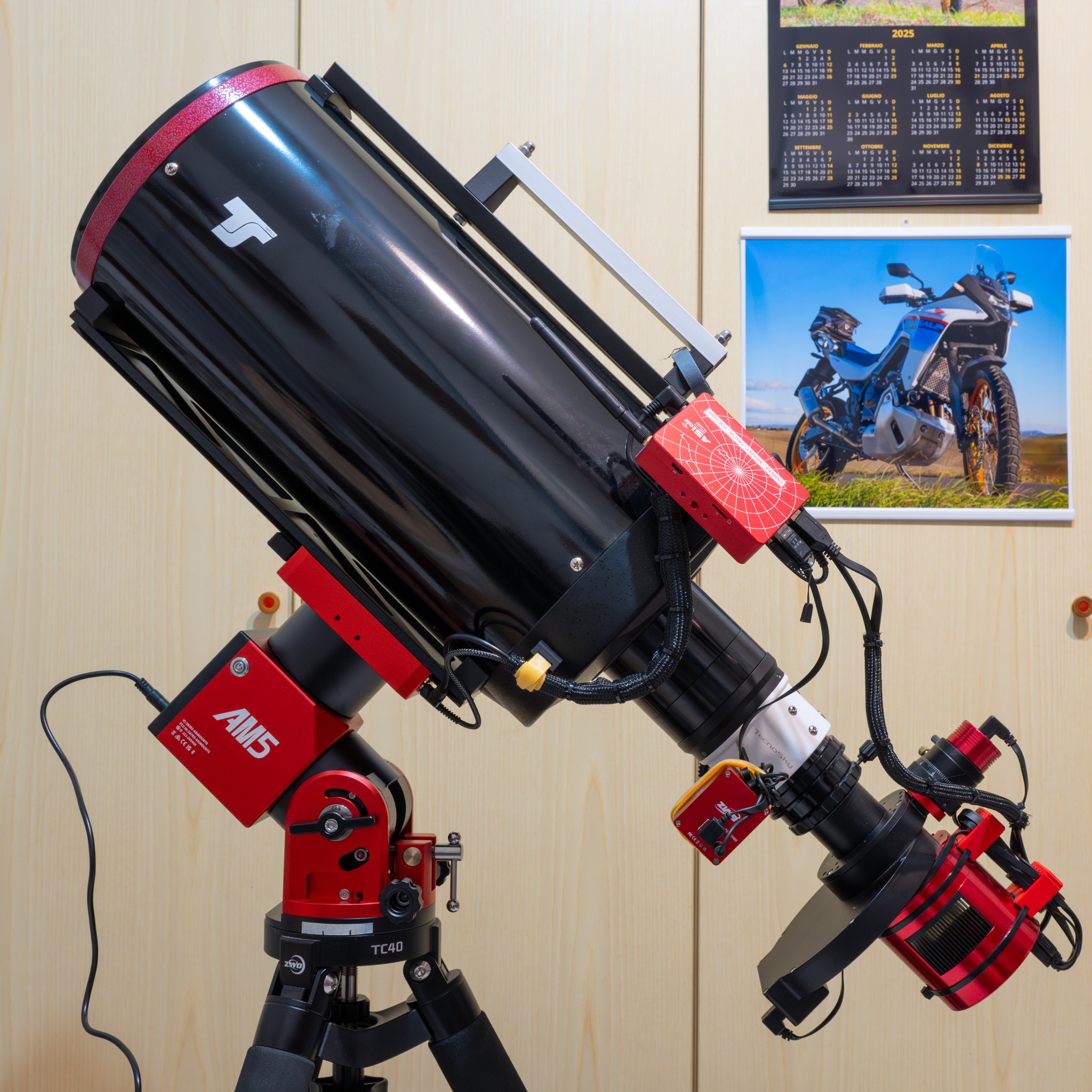

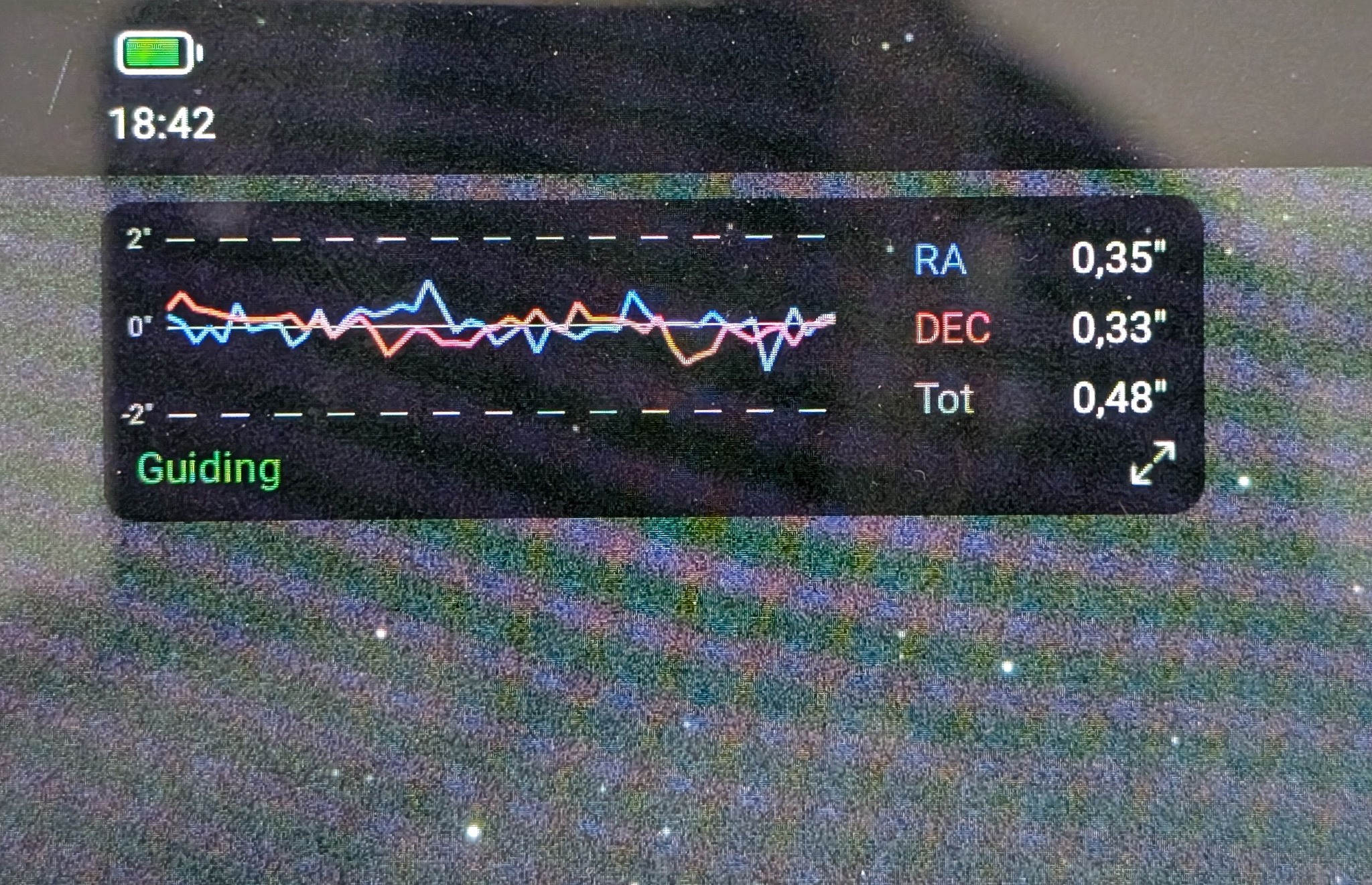

mc0676 1.91
Here:
- AM5N
- RC8 full lenght (1624 mm)
- ZWO EAF
- ZWO EFW 36
- ZWO ASI2600mm
- ZWO OAG-L
- ZWO ASI174mm
_ ZWO ASIAIR+
about 12.8 kg (28.2 pounds)
Usually use a 4.5 kg counterweight but it has no effect on driving, I only put it there to avoid the risk of it tipping over.
Guiding at 0.4-0.5 costantly. Before i had the AM5 and with the same setup was 0.6-0.7.
