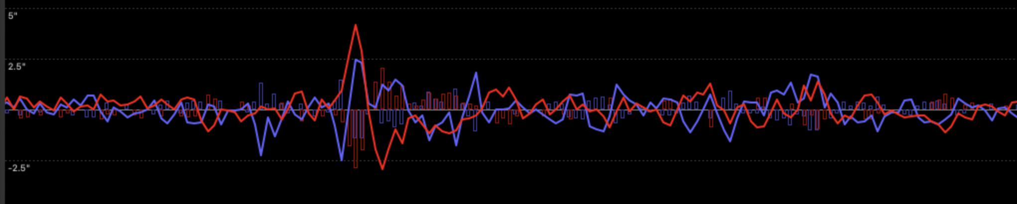

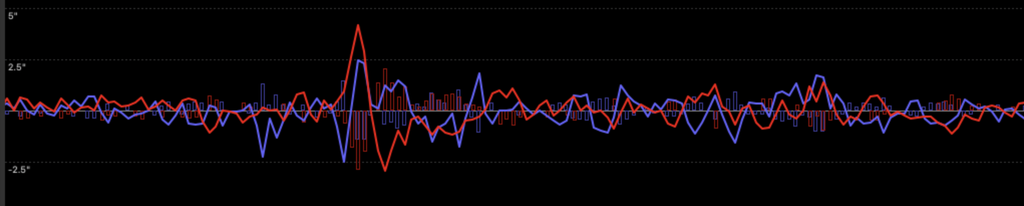

My last two sessions with my (new to me…) AM5 haven't gone as I'd like.  I mostly image with an NP101 and use a 120MM Mini hooked to a WO 32mm Uniguded (120mm FL).
I used to have the following defaults:
Guide rate = 0.5X
Guide exposure = 1 sec
Calibration step = 2500 ms
Max Dec = 2000 ms
Max RA = 2000 ms
I've always set up on a hard surface with this mount using the TC40 tripod.  I used a 3D printed pier extension because, well, it's much cheaper than the ZWO version.
I would get these weird, random spikes simultaneously in RA and DEC.  I can understand a spike in one direction but not in BOTH and of considerable magnitude (>4", lasting a few seconds).  The guiding otherwise was ~0.5" and really good but that's enough to screw up subs.
Last run I dropped the calibration step to 1700 ms but still had the *&^%$#@ spikes, costing me ~10% toss rate on subs.  I then adjusted the parameters to:
Guide rate = 0.5X
Guide exposure = 0.5 sec
Calibration step = 1700 ms
Max Dec = 400 ms
Max RA = 400 ms
I still get spikes, but they're more muted (typically <2") and resolve MUCH faster (<1 sec), apparently fast enough that I'm now getting nice, round stars.  So that's good.
But what's up with spikes that are happening in both DEC and RA at the same time?  Should I send my mount in for repair?

What are your RA and DEC Aggr(essiveness) settings?  Typically, the AM5 likes fast exposures (around 0.5 s, like you have) and low Aggr settings (around 25-30%). Just something I played with to improve my guiding. Not sure about your <quote> *&^%$#@ spikes <quote>.

That might be one of my issues.  I think I was 50-60% aggression on both RA and DEC.

apennine104 3.61
I had similar (4 arc-sec) random RA/DEC spikes not as a result of guiding impulses or periodic motion on my AM5 utilizing a 120mm guide scope and 220MM camera. I reached out to the PHD2 Google Group, and one of their developers immediately called out how my guide scope was mounted to my telescope, which was two set screws holding it within a shoe. To me it seemed sufficient with my short focal length (~400mm). However, with my guiding ratio, they equated a 4 arc-sec spike to 2.6 microns of movement of the guide scope relative to the main scope/mount, a human hair is 50 micron.
With that said, I switched to an OAG, and the spikes went away. I could have also looked to more firmly mount my guide scope to my scope.

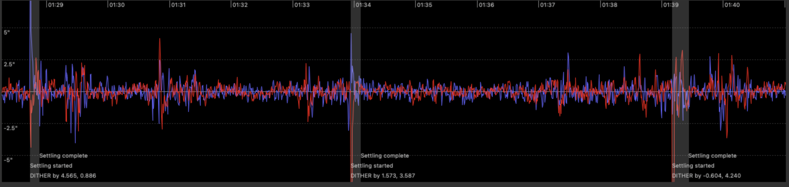

xxao 3.61
Honestly I'm struggling with some kind of spikes since I purchased the AM5. I even returned one, since I was unable to get below 1.3" total RMS. The new one is better so I still have it (about two years), but far from those steady lines posted by other people. In average it guides around 0.7". There are some nice periods for maybe a minute of 0.3" and suddenly there is a spike/shake. Sometimes DEC and RA are in sync, sometimes not. It is typically reversed very fast, but then it must go other direction again. Aggression has no effect on that nor any other settings. I have no idea if this is seeing, the mount, tripod or maybe a mole under our garden. I tried different tripod, pier extension, better guiding camera and better guide scope. Those regions in-between seemed to be improved by those changes, but not the spikes.
Most importantly, the stars are still round and mostly I don't need to reject frames because of bad star shape. Even with 300s on Askar500 with 533MC PRO. So I gave up and I'm slowly learning to live with that :-)
Alexn 12.25
ummm.. Ok.. so the graph literally tells you what the 'problem' is… Between every exposure, your system is dithering. This is where it moves the guide star a sufficient amout so as to make each sub exposure ever so slightly misaligned. this results in better colour correction for one shot colour cameras, and results in reduced fixed pattern and walking noise in the final stacked image (for mono or osc)
These are intentional, and configured by you.
The reason you're not seeing elongated stars is because this happens at the end of each sub exposure, and the guiding system waits until it is sufficiently settled before telling your imaging software that it is time to commence the next sub exposure.
This is PERFECTLY normal - and there is absolutely no reason to return your mount or be concerned at all..

Rustyd100 5.76
Some of what I’m seeing is consistent with wind spikes. Mid-priced mounts are more susceptible to this, but otherwise, properly adjusted, can rival premium mount performance.
Harmonic drives benefit from a different approach to guiding. Some responses above allude to it but their suggestions need to be modified further. For some reason, the industry does not mention this often, and I don’t know why.
I have an old AM5 at Starfront, in Texas, and regularly get 0.3 to 0.6 guiding all night long with the following numbers:
Max RA/DEC: 140ms/140ms
Guide speed: x0.75
exposure: 0.5sec
Aggression: 25% (30% in more turbulent skies. As always, adjust to taste as conditions require)
These settings prevent the guide adjustments from riding on top of the periodic error, reducing guiding errors significantly. It’s visible in the graph, with the fluctuating corrections moving together in a straight line, the PE sine wave almost completely subtracted. Stars are smaller and perfectly round.
The dithering spikes will continue and contribute to lower noise in the final stack. It’s just a slight repositioning of the image and completely normal. But some of the aberrations you have been getting should be greatly reduced.
Secret tweak: RA guide results are usually higher than DEC. Try shortening the RA Max to 135 or even 130. Leave DEC at 140. You’ll see the RA guide number drop immediately…equaling DEC much of the time.
With these applied to my AM5, the guiding is equal to my home traveler ioptron harmonic…and it has encoders!
xxao 3.61
Just to be clear, I am aware of what dithering is and I do it intentionally. My problem clearly is the crazyness between. The zoomed peak is not dithering but a random spike during exposure. I gues I will try adding some weight.

Dave,
Hope you don't mind me asking...
Question 1 -- what benefit does setting the guide speed to 0.75X reap vs. 0.50X?
Question 2 -- what would likely result if I used all the above settings, but maintained a 1.0-sec guide exposure?  I'm pondering a Duo / Air and I'm worried about short guide exposures when using dualband filters.
To all -- thanks for the feedback.  There's a lot more variables than I thought to optimizing guiding performance and I really appreciate it.  Just another why I feel there's no hobby on earth better than amateur astronomy (...but I might be sliiiiightly biased!)
Clear Skies,
Phil
WhooptieDo 10.40
I just want to toss in here my 2 cents.
When you see spikes in BOTH axes at the same time, these are indicative of external forces acting on the mount, such as wind or something bumping it.    In most cases I would completely ignore those spikes.     Also, guiding is only as good as your seeing conditions.   Some folks don't ever see good guiding, particularly those in turbulent mountainous areas.
In Martin's screenshot above I do see one glaring issue however.    His MnMo for his dec is set too low, causing oscillation in the dec axis.    Relaxing this setting will iron most of that error out.
Rustyd100 5.76
Hey, Phil!
the x.75 just makes it easier for the mount to accomplish the intended correction on such a short time.
you can change any of the values as you wish. The approach is designed to avoid creating oval stars that are generated by longer correction times and harmonics’ larger PA curves. If you try 1sec and like the results, fantastic! On my gear the total guiding number dropped noticeably with 0.5sec, but I bet either time would lead to usable results.
