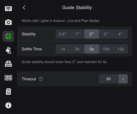

Chris wrote: I didn't see where I could change the amount of time between dither settling and shooting in the ASIAIR however. To configure the settling time after dithering (on the ASIAir Plus), go into 'Guide' menu, then select 'Guiding Advanced Settings', then choose 'Guide Stability' to call up this screen...  I have my AM5 set to wait for guiding to settle to within 2 arcseconds for a period of 5 seconds before continuing to shoot more subs. This works well for me and the AM5 settles very quickly (maybe 7-10 seconds total). My guess is that re-calibrating your guide setup and adjusting the dither settling will correct this problem.
My guess is that re-calibrating your guide setup and adjusting the dither settling will correct this problem. Thank you!! Will definitely try this next time out
