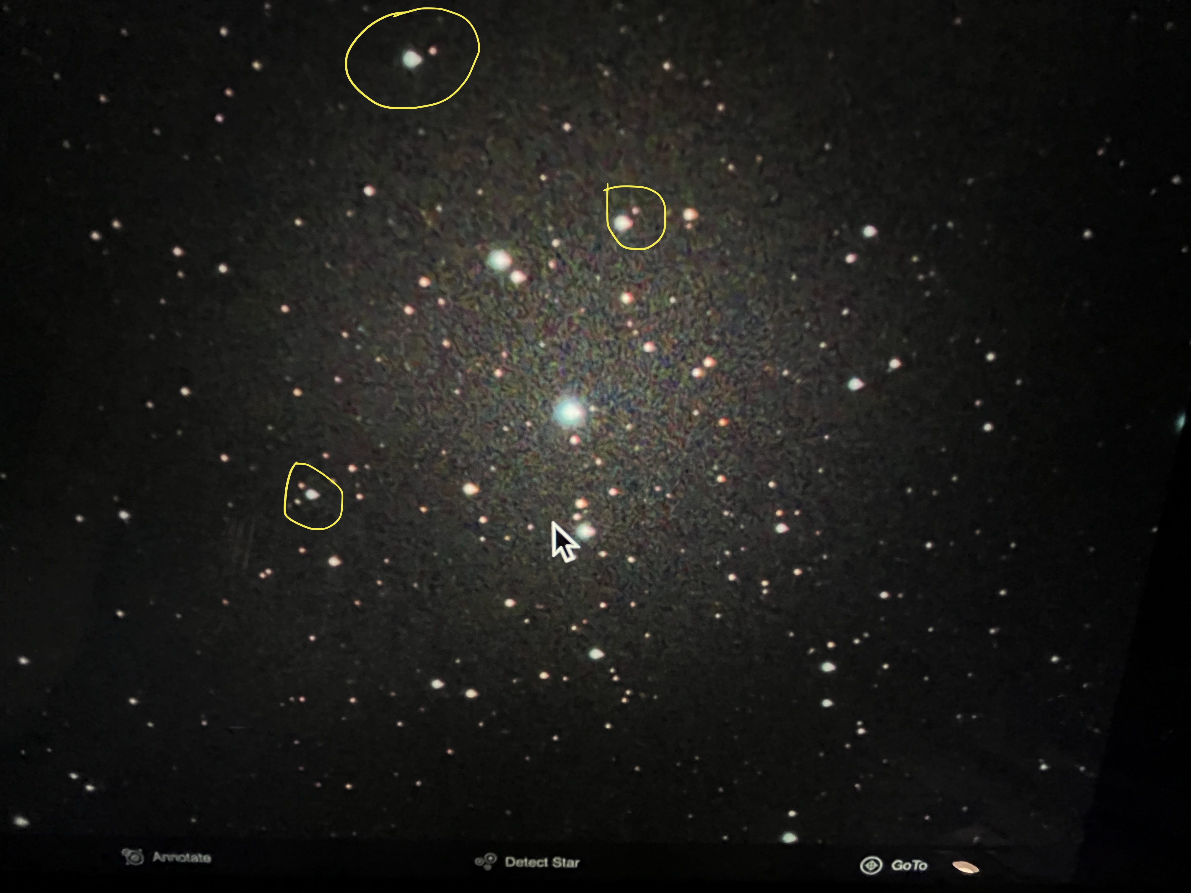

Hi All, I've been imaging for a year now and noticed a weird tracking error on most nights...usually before the Meridian flip. It self corrects either frame to frame or sometimes after a few frames. It manifests as a small nodule, nubbin or bubble next to the imaged stars...tried to take a pic of it below (sorry for the bad iPhone picture). AM5 tracking error? I've been deleting these frames but was curious if it was correctable. Mount AM5 Cam 2600MC Guide scope Orion 60mm Guide cam: ZWO 224  |

This dont look like guiding error at all.

I agree that this does not look like a guide error at all. Is this "print screen" coming from the guide or the main camera? What is your imaging scope?

AM5 typically requires 1 second of exposure time. Thx mate...this super crappy iPhone pic was taken on a zoomed in pic on one of my subs from last night's imaging...I tried to find a few representative stars that showcased the error...but obviously this occurs across the image. The stars come out with small "nubbins" (for lack of a better word)...always to the right of the star...and only before a flip.

What is the clearance between your camera/cables/EAF thermometer probe/or whatever else might be hanging down from the lower end of your telescope just before the meridian? If one of these starts touching the tripod, it can cause all kinds of interference with tracking and guiding. This woud be more so just before the meridian than after because afterwards the tension is getting less and less whereas on the opposite side it gets worse. Do you use a Pier Extension (like the PE-200)?
Also the nubbins are all reddish (the other part of a star is bluish), which is a sign of chromatic aberration, and then maybe the proximity to the meridian plays some role in causing the reddish "nubbins" to appear.
