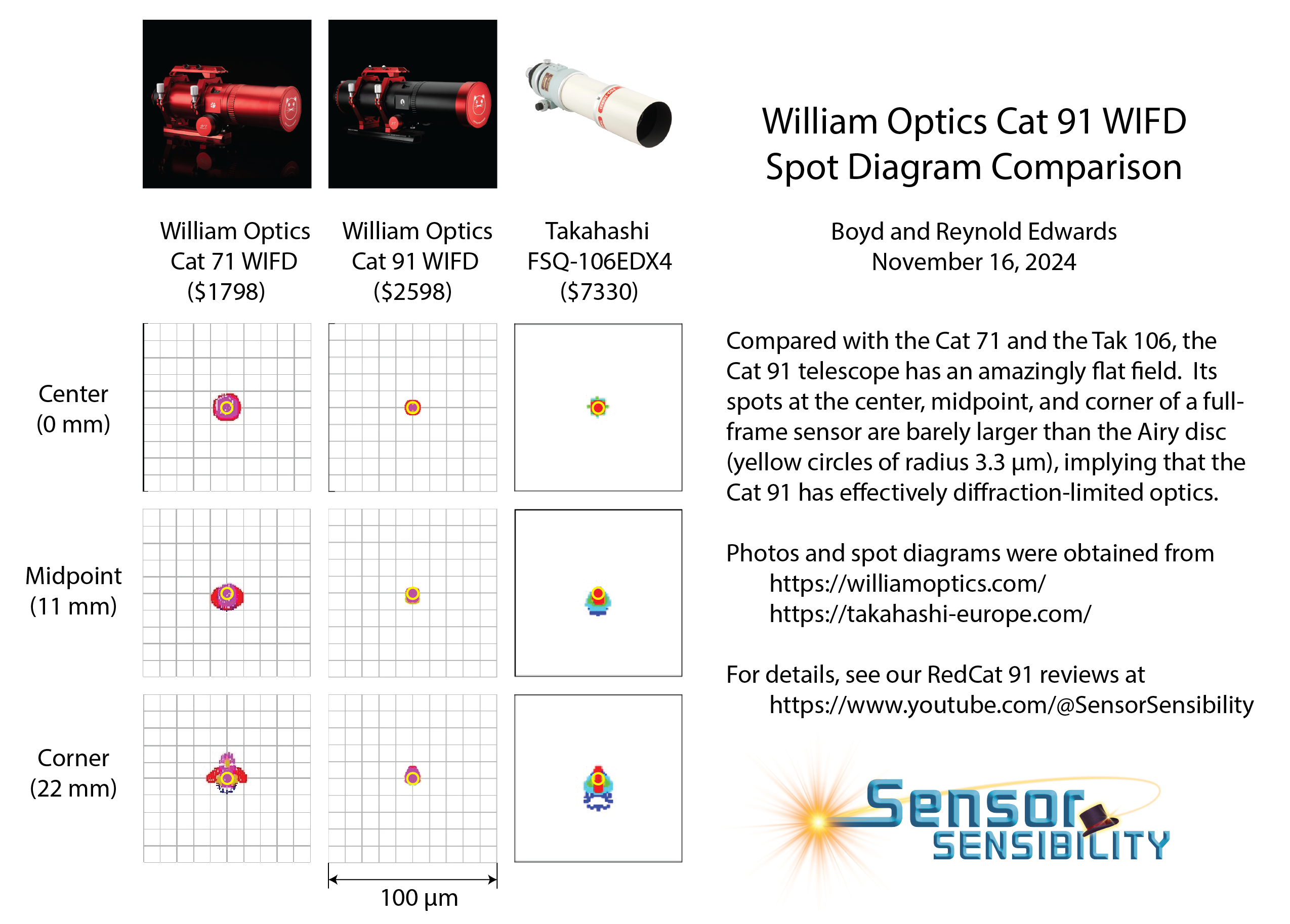

The William Optics Cat 91 WIFD telescope has an amazingly flat field, as shown in the attached spot diagrams. Its spots are smaller than the Cat 71 and the Tak 106, and are just barely larger than the Airy disc, meaning that the Cat 91 has effectively diffraction-limited optics. See our video short and unboxing video for details: https://youtube.com/shorts/U5-3OE1IOaghttps://youtu.be/6CY6tjgaBWMWe're excited for the clouds to disappear so we can get this scope under the stars! I see in this forum that a few have already taken images with it. By the way, the William Optics website is listing this telescope as the "Cat 91 WIFD," not the "RedCat 91 WIFD." The same applies to the other cats, they're now called the Cat 51, Cat 61, and Cat 71. spots.png |

Using the ASTAP Aberration Inspector, Ren and I tested star shapes and sizes on the Cat 91 in this video, using actual images that we took of the night sky using our Cat 91 telescope and ASI6200 MM Pro camera: https://youtu.be/45oKJdrK0JQThe stars are tiny and round all the way to the corners of a full-frame sensor. This scope's a winner! Boyd
Spot diagrams are cool - but I would never buy a scope based on marketing 'data' the manufacturer provides to sell the scope…
Lots of people are saying "oh but its spot diagrams are better than a Tak FSQ106EDX4…." and sure. That's what William Optics is saying… But William Optics want you to buy the scope… They will say anything they can get away with saying in order to make that happen.
Until I see a side by side comparison of the Cat 91 vs FSQ106N (N, not EDX4, the N is the better scope) that clearly shows the WO scope is better, I'm going to believe that this is marketing hype, not factual data.
Its definitely a known thing that people with Tak refractors will believe until the end of time that their ridiculously expensive telescope is the be all and end all of optical perfection - and I honestly feel that they are generally over priced and only a few select models are really stand out, incredible telescopes. The FSQ106N, is one such model, along with the TOA130 and TOA150. The newer FSQ106's (EDX models) are not as nice as the N. Almost all Tak scopes come with garbage rings (clamshells), the focusers are generally rubbish and require replacement…
Do I think the WO Cat 91 could be, dollar for dollar, an all round 'better buy' than the FSQ106? yep… I think so… Will it outperform an FSQ106 optically in the real world… I doubt it.

Do I think the WO Cat 91 could be, dollar for dollar, an all round 'better buy' than the FSQ106? yep... I think so... Will it outperform an FSQ106 optically in the real world... I doubt it. Alex, our new video compares actual star shapes in images that we took of the night sky by the Cat 91, not spot diagrams, with the Cat 71. It would certainly be interesting for someone to compare star shapes of the Cat 91 with a Tak, but I don't own one. If you do, please contact me so we can arrange for an image comparison. Boyd

Those of you who have bought one, do the actual pictures live up to the spot diagrams? I would like to get one of these this summer but I want know if the hype is real.
Jim Bishop: Those of you who have bought one, do the actual pictures live up to the spot diagrams? I would like to get one of these this summer but I want know if the hype is real. I was thinking that if it is really that good as the spotdiagrams I would very likely buy it. However, from what I have seen on CN, it looks IMO horrible. The posts of December 13th by w7ay. Might be a day more or less depending your timezone. https://www.cloudynights.com/topic/941228-william-optics-redcat-91-wifd-f49-petzval-refractor-telescope/page-7 |
https://www.cloudynights.com/topic/941228-william-optics-redcat-91-wifd-f49-petzval-refractor-telescope/page-7 What looks horrible about it? A spot diagram just shows what in-focus stars should look like across the frame. Someone’s raw results right out of the box will never be perfect. Especially with a FF chip tilt correction will need to be done. In the photo there it looks like that is the case.
Jim Bishop: Those of you who have bought one, do the actual pictures live up to the spot diagrams? I would like to get one of these this summer but I want know if the hype is real. Yes. The pictures live up to the spot diagrams. See https://www.youtube.com/playlist?list=PLbjxJx_E7x9DHPj-LW6lxDFzRPa5e8bmNand https://www.astrobin.com/users/SensorSensibility/ |
