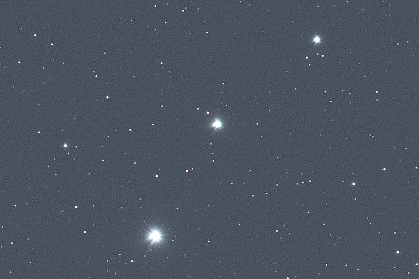

hello Redcat71 users, are you happy with your stars? Are your stars round all over the field , or are they elongated at the corners of the field when observed at high magnification? I have tried different cameras and back focuses, from 55 to 60 mm,  but the problem persists. Maybe an optical issue or maybe a flattener issue. Have you had a similar experience?

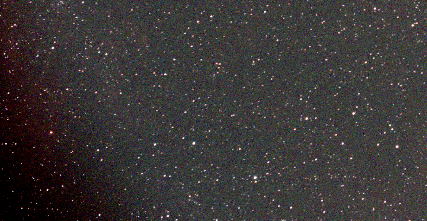

Here is 1 5min shot off the RedCat71 using the full frame ZWO ASI2400, flats take care of the vignetting but stars can look a little strange in those areas. BlurX will fix those stars with strange spikes along with TVGDenoise if using PixInsight

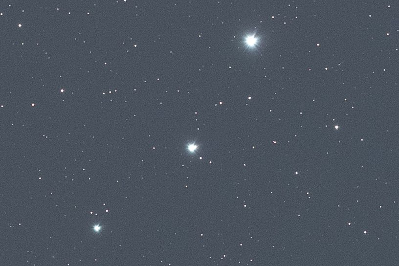

Below is an AberrationInspector image of  a sub of M45 using an ASI2600MC Pro APS-C camera.  The stars around the edges are out of round somewhat.  I guess I could have asked for a replacement but it was quite a while before I got to use the telescope due to weather.  Its the luck of the draw.   Thank heaven for BXT.
