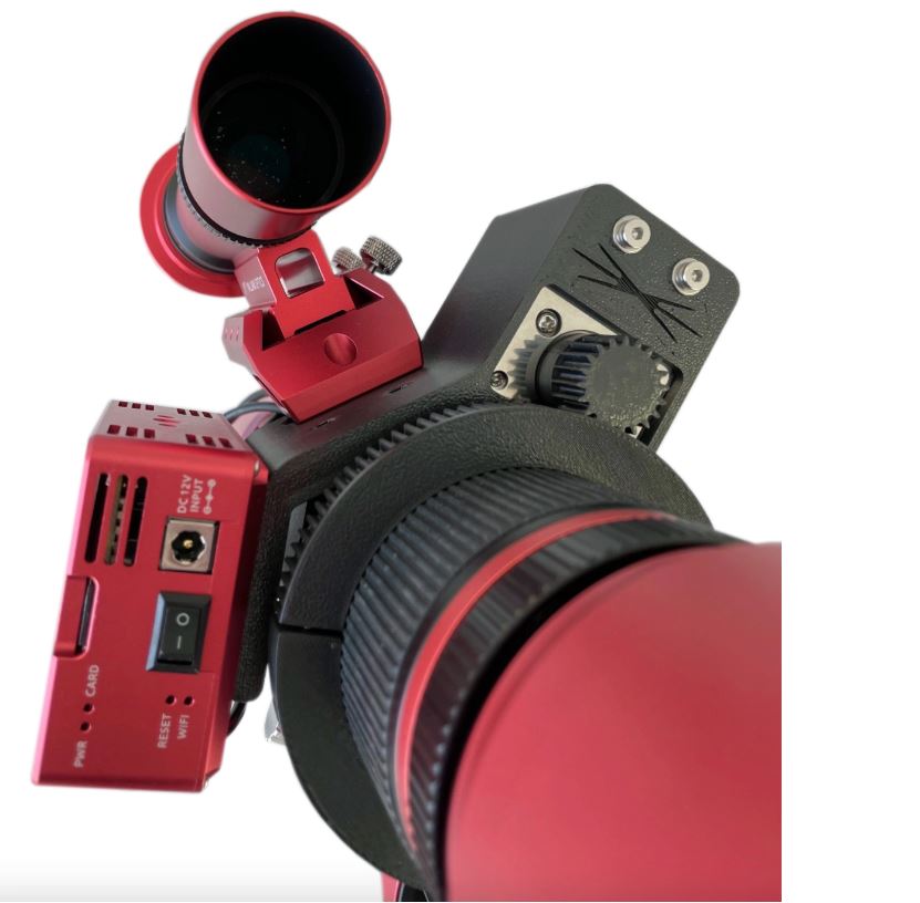

Supro 4.37
I used this one "Pro AstroGear's "Big" Black-CAT Mount # BCM71" while I had my Redcat71. I've since sold the redcat, but the mount kit did exactly what was intended. When installing it's important to zero out the EAF and match that to the farthest position of the helical focuser. I imagine this is the same for any of the EAF+Helical Focusing scopes though.
D-Rider 0.00
I have the ProAstroGear on my Cat71 which is superb. It holds EAF, and ASI air and leaves room for a guider. As the EAF is mounted to the side there is no need to raise the assembly with inserts to fit it underneath which moves everything away from the RA axis. The focus ring setup is really accurate.

RichAstro 0.90
I too, use the Big Black-Cat Mount BCM71 on my RedCat 71[b]. [/b] It is a nice clean 3-D printed piece of hardware and very easy to install and use. Everything fits together nicely and at a price point is hard to pass up.
