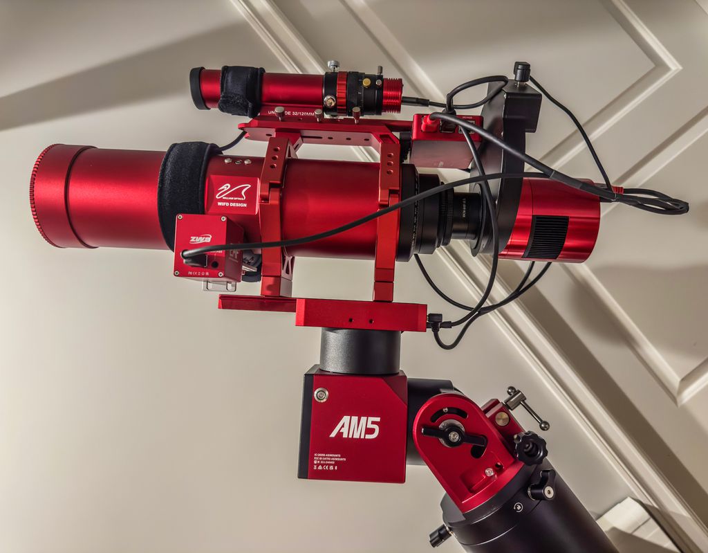

 Yes I use the riser blocks from William Optics that color match the scope. Here’s a picture of my Rig. Redcat 71 WIFD ZWO AM5N William Optics 32mm Uniguide Guide Scope (with ZWO Helical Focuser attached) ZWO TC40 Tripod ZWO PE200 Pier Extension ZWO ASI2600MM Pro (Imaging Camera) ZWO ASI220MM (Guide Camera) ZWO EAF ZWO 5x2 EFW ZWO ASIair Plus (Gen 2) Dew Control brand Dew Straps - Custom size straps, custom cord size and DC connections to work with ASIair

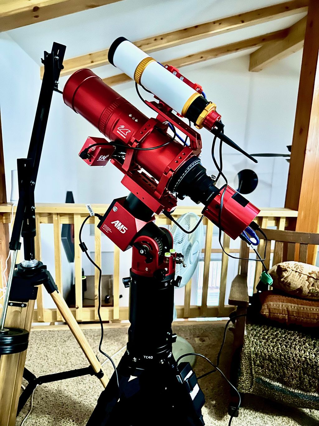

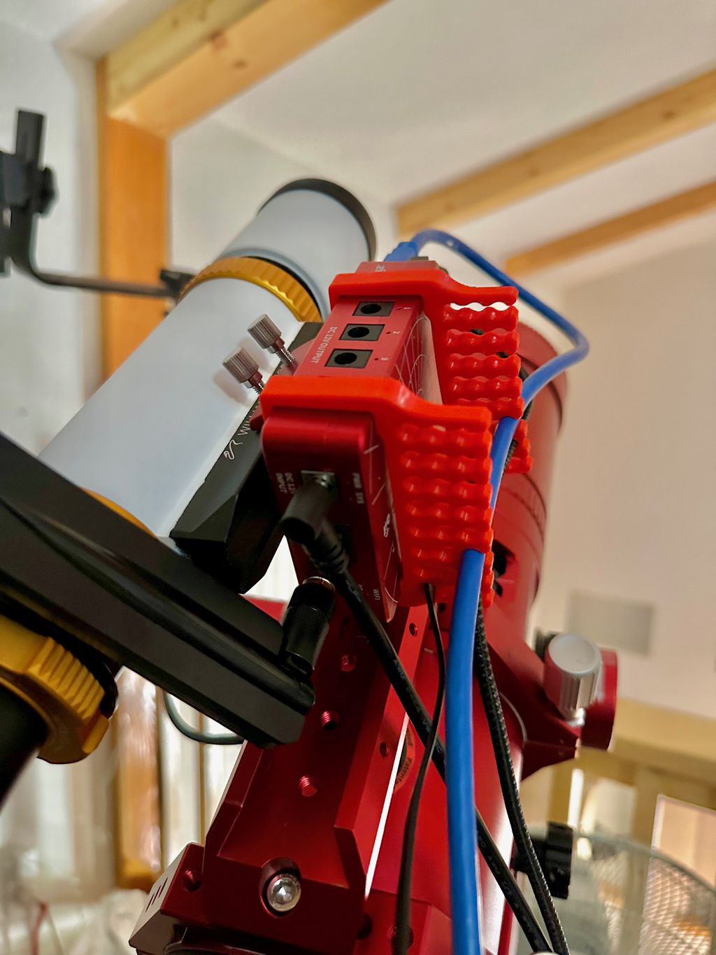

Here is a picture of my setup. I have the Redcat 71 WIFD, ASIAIR Plus 256, ASI2600MC-Pro, WO 50mm guide scope, ZWO EAF, and ASI290MM mini guide camera. The total weight of the scope and accessories is 14.5 lbs. I have not seen the need for the riser blocks yet - the focuser knobs are in front of the saddle. The second photo shows how I attached the ASIAIR Plus on top with the WO 50mm guide scope. f you get the TC40 (which is very light and great for handling), be sure to get a 15-20 lb weight to put in the hammock that comes with the tripod. This will may the tripod and mount very stable and secure. I would also get the pier extension (PE200) - it will increase the height and help avoid collisions with the tripod legs.   |

Redcat 71 WIFD ZWO AM5N William Optics 32mm Uniguide Guide Scope (with ZWO Helical Focuser attached) ZWO TC40 Tripod ZWO PE200 Pier Extension ZWO ASI2600MM Pro (Imaging Camera) ZWO ASI220MM (Guide Camera) ZWO EAF ZWO 5x2 EFW ZWO ASIair Plus (Gen 2) Dew Control brand Dew Straps - Custom size straps, custom cord size and DC connections to work with ASIair Thanks very much for the picture. It’s really helpful to see your rig. I didn’t know WO did riser blocks for their scopes. I’ll definitely be ordering those to go with the scope. I use Dew Control straps too. They’re great with the custom cable length and connectors.
Robert Ray: Here is a picture of my setup. I have the Redcat 71 WIFD, ASIAIR Plus 256, ASI2600MC-Pro, WO 50mm guide scope, ZWO EAF, and ASI290MM mini guide camera. The total weight of the scope and accessories is 14.5 lbs. I have not seen the need for the riser blocks yet - the focuser knobs are in front of the saddle. The second photo shows how I attached the ASIAIR Plus on top with the WO 50mm guide scope. f you get the TC40 (which is very light and great for handling), be sure to get a 15-20 lb weight to put in the hammock that comes with the tripod. This will may the tripod and mount very stable and secure. I would also get the pier extension (PE200) - it will increase the height and help avoid collisions with the tripod legs.
