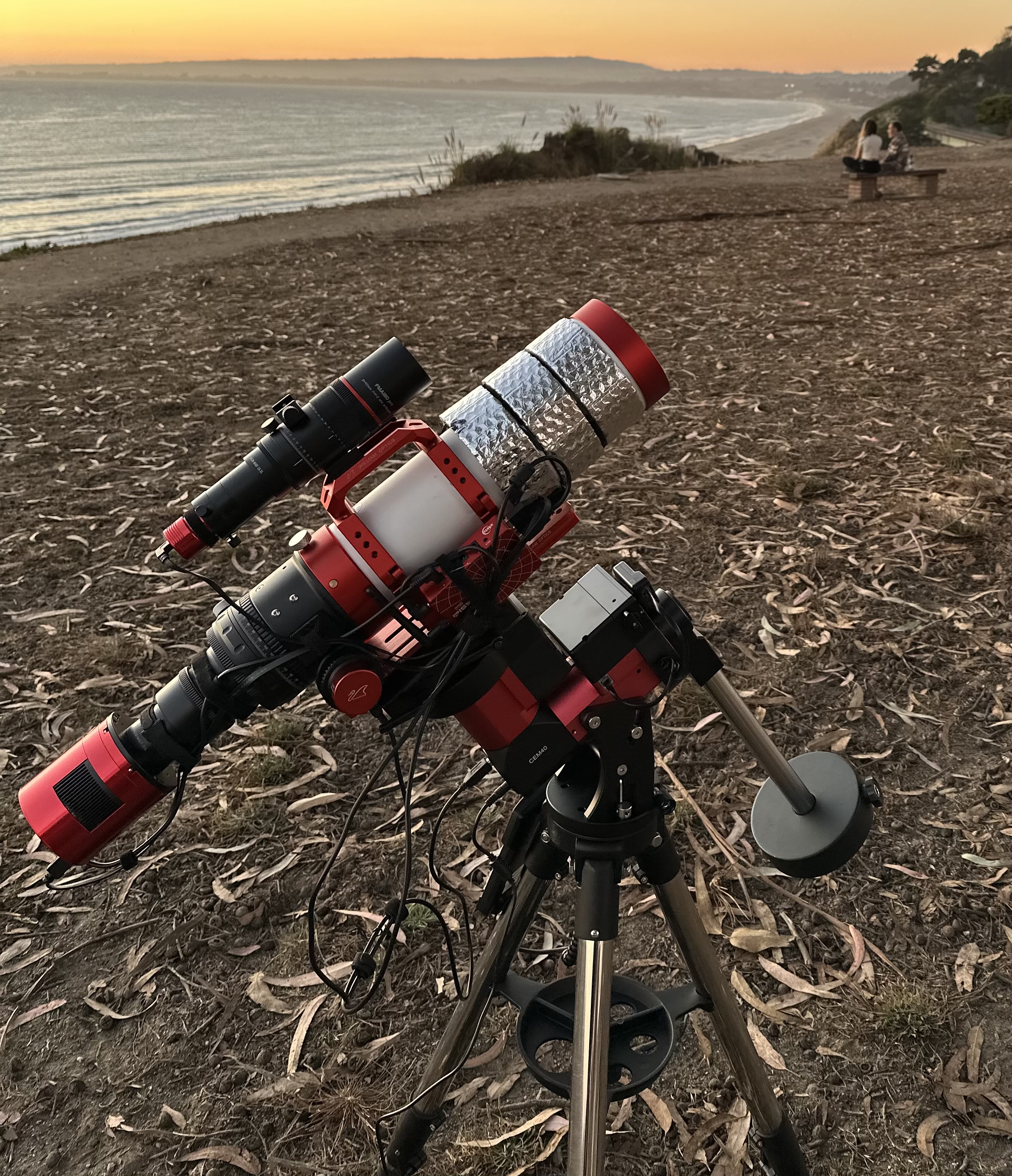

EdDixonImages 3.82
The key things you will want to find include:
Mount
Flattener
AP camera
Guide scope and camera
Computer to control scope stuff
iOptron makes great mounts, and their more recent entries do not usually require a counter weight.  Today I use the HEM27 with my ZWO FF107 (similar to the WO 91) as well as with other bigger scopes.  The HEM27 also has a built-in polar scope, which makes doing a PA much easier.
Get the WO flattener for the 91.
I use a ZWO ASI2600MC camera, which is hard to beat.
WO has some great guide scopes.  I use the WO 50mm model with a ZWO ASI678MM camera.  I also have the WO 32mm guide scope for smaller shorter focal length scope setups.
I use a miniPC at the scope for all control and capture duties.  I have a powered USB hub velcrowed to the tripod, which makes connections much easier.  I used to have a ZWO ASIAIR, but found the miniPC worked better for me (wider range of software can be used).
Being older now, I want to be inside doing all control activities (warm in winter and cooler in summer). I use a WiFi adapter at the scope and a Jackery power model for all power needs.  This means that there are no wires outside the footprint of the tripod.
