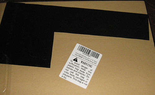

When I make my own rings, I line them with this sticky-back Felt. Works great, very smooth, very thin, very clean, very safe.
But I agree with Andrew, this should not happen in the first place.
