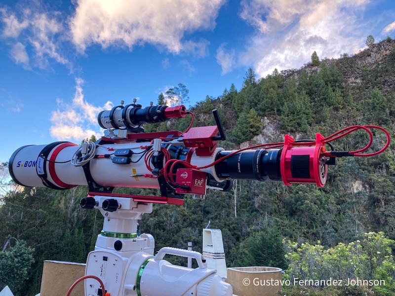

Haggy38 0.00
I used 122mm APO telescope, 10kg all dressed up, no issues whatsoever on my EQ6 R Pro, guiding between .3-.5IMG_4913.jpeg

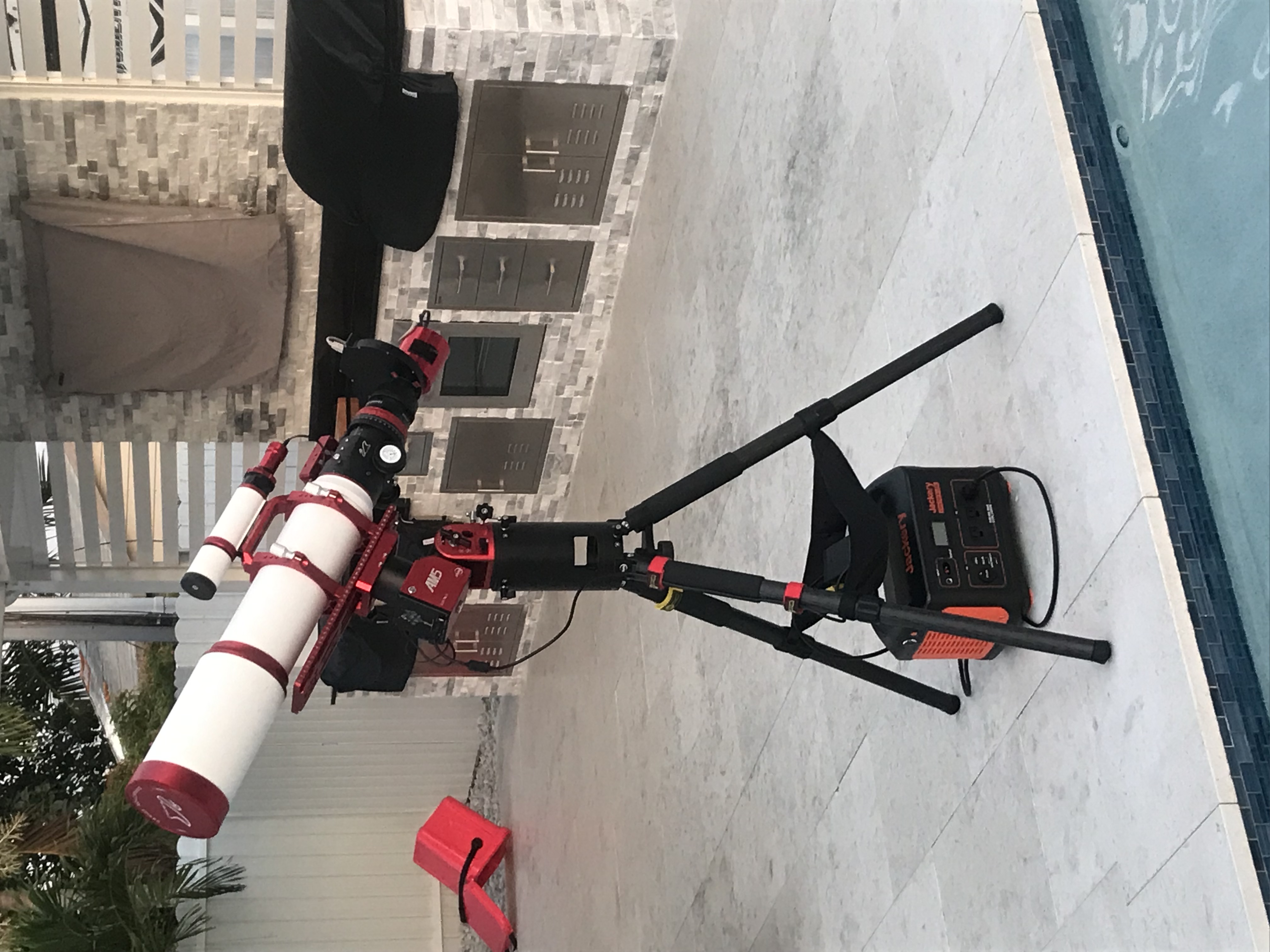

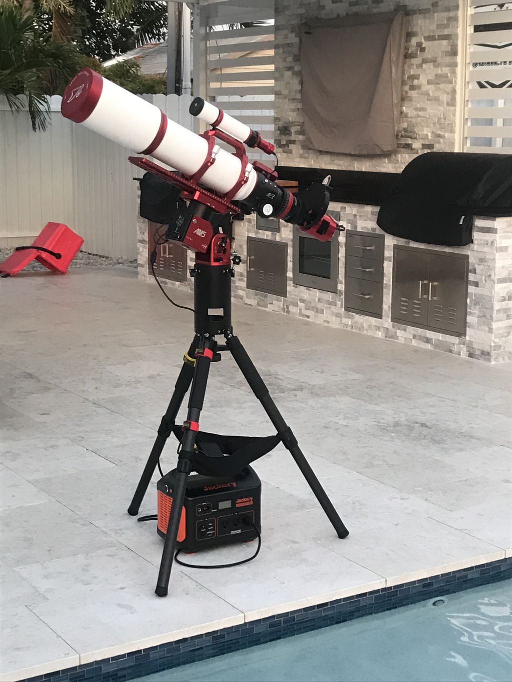

bdm201170 8.64
hi
i used my FLT 120 with my ZWO AM5
CS, Brian
