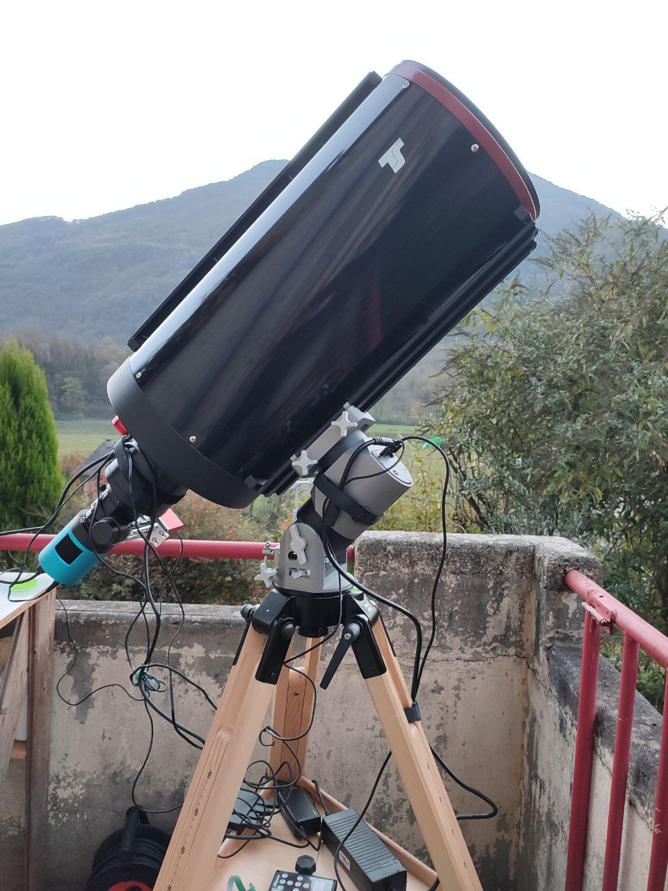

My WD-40 is on a Berlebach UNI18 tripo with a AM5 support.  I used it several time without counterweigth but I finally  put one just to prevent the tripod to flip in certain unbalanced position.
Below my RC10  , 18kg total weigth with guiding and camera.
That's a nice looking setup, but I'm curious why you chose the 10" closed tube RC instead of the 10" Truss.
The closed tube has the focuser coupled/attached to the primary mirror cell and I've heard that it's pretty difficult to collimate since you can't see the laser spot on the secondary mirror with out using some other kind of mirror.
Also how are you finding the stock focuser?  Any tilt, slippage, or other kinds of problems?
Lastly, are you using a focal reducer or flattener?  If that's an IMX571 camera then you're sampling at a pretty small pixel size ... smaller than the guiding error of 0.4 - 0.7 rms reported above?
Thanks for any answers you can provide.  I'm seriously considering the 10" truss version myself and would love to hear feedback from actual owners/users.

*** I see no advantage to a truss tube, it is heavier, you have to put a cloth to close the tube and avoid reflection , it is more expensive.
The RC10 is easier to collimate than let's say a RC8 or RC6 because you see better the circles of mirors and spider alignement . I have added a tilt ring for 100€ so it makes the focuser no attached to the primary cell. You do the collimation of primary, secondary and at the end the tilt of focuser + adjustement to mirors if necessary. I am using the ocal to collimate , that work very well once you understand what you see.
regading the dew , I have a dew tube I made myself, so I have no dew on the secondary miror but the tube is totally wet.
The stock focuser is a cheap toy, you have to change it for astrophotography.
I use a focal reducer with 0.67 factor (focal 1375mm) . I am using an IMX571 , whit the seeing I have here, my resolution is between 3" and 5" of arc, so the guiding error is far less inferior to that.

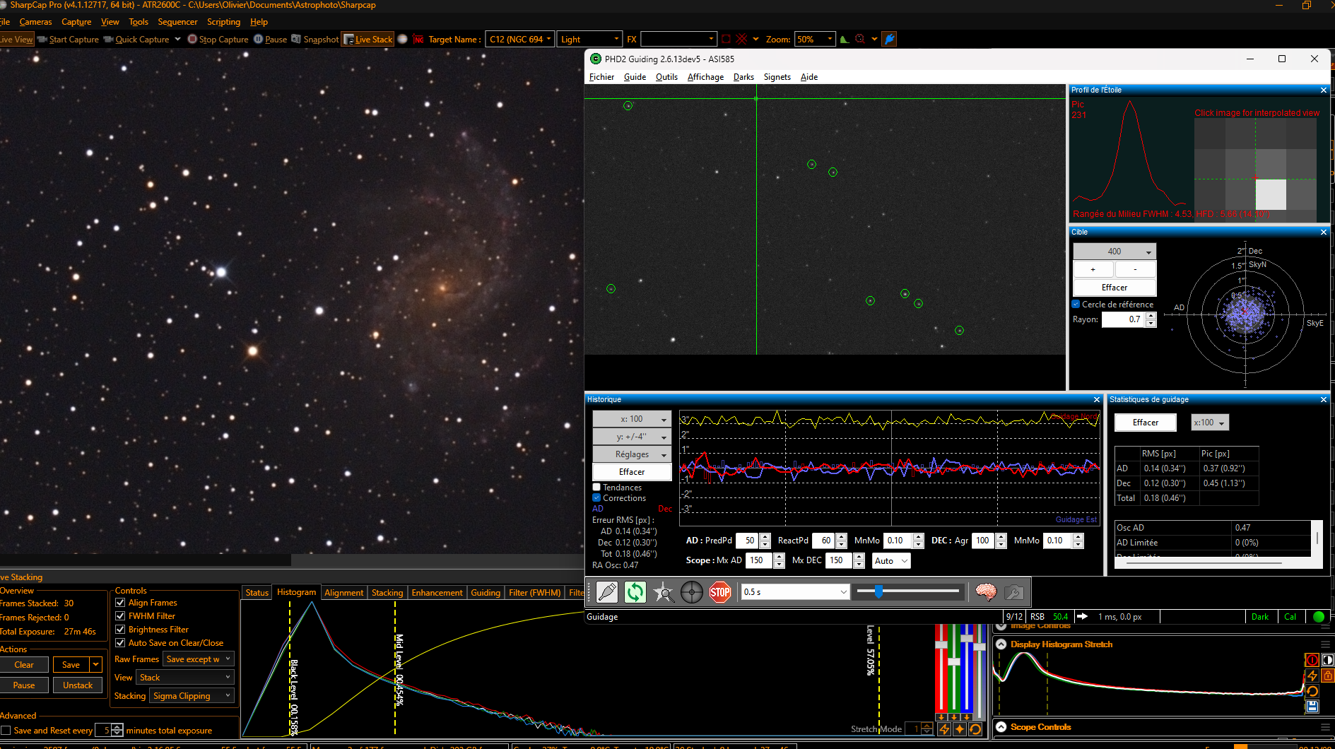

Below the picture I have just done tonigth (no processing, just out of sharpcap "as seen") with the RC10 , imx571 , 34 min .

See below an example of the guiding with WD-20 . I can certainly go further in the precision but I this is suffisiant for my seing at home.

Olivier Constans:
What are you PHD2 settings?
I have an ASI220MM on a PrimaLuce 60mm guide scope on top of an FSQ-106 EDX4 + PL Eagle 5 Pro.  I rarely get anything under 0.7" so I'm pretty sure something is up with my settings.
It's totally stable (mounted on a Berlebach Planet Small tripod).
For comparison, I also have a Tak e-130d on an AM5 with an ASI2600MC Duo and get much better guiding using pretty much default PHD2 settings (steps adjusted for focal length).

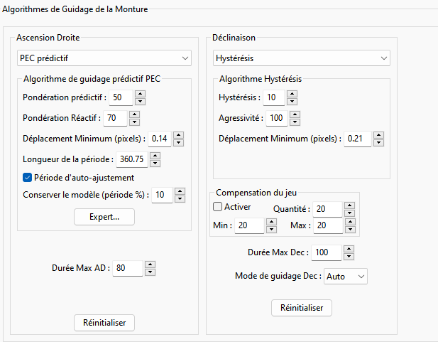

Hello,
these are my last settings .
I generally have a total rms  between 0.46 et 0.6 depending the condition and the direction I am pointing the sky.
I am using most of the time a very short time of exposure (when the seing is good)  of 0.2s . When it is not going I use 0.5s.  I am still experimenting to get something better, but until now I was never abble to go under 0.14 pixel.
I also figured out that it is better to try to balance correctly the scope in the mount , especially in Dec because you have no brake and unbalanced scope may give issue (I have a 20kg payload on that mount).
