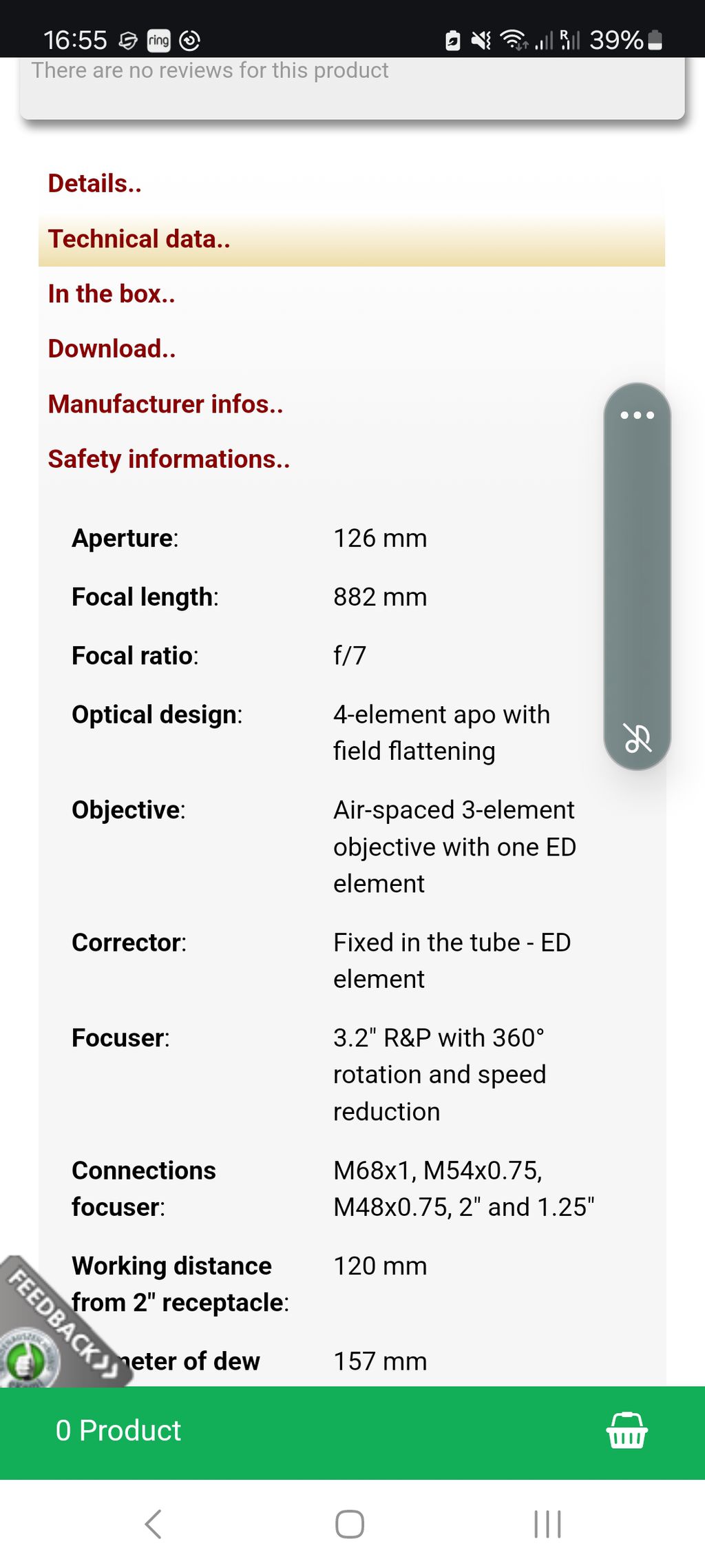

Marco Luigi Tassi: I just bought the TS-Optics 126/882 Petzval quadruplet, I will receive it in June. I have had very positive feedback, the spot diagram is outstanding. It is made by KUO with two ED lenses similar to FCD100.
https://www.teleskop-express.de/en/ts-teleskope-143/high-end-apo-with-3-element-apo-objective-no-color-aberation-288/tsapo126phq-18411 Thanks Marco. I'm not sure that is a true Petzval. Looks similar to the Askars with a triplet and rear corrector, so very sensitive to collimation. Also no name glass AKA Askar style. I'll be interested in your real world first light feedback.
"do you image in cold temperatures?" Not really that cold, at least compared to Finland :-) Night temperatures are roughly from -5°C to +15C, over here in Belgium.
The information I got from KUO is 4 lenses in three groups, front doublet and two other spaced lenses, this is a Petzval configuration. The information from TS and Tecnosky, on the 126/882, confirms. I have had several refractors and I still own three, waiting for the fourth. I have always obtained good products from TS Optics that do not differ much from my current Takahashi and the previous ones. Certainly the sky test will give confirmation quality or not.
Marco Luigi Tassi: The information I got from KUO is 4 lenses in three groups, front doublet and two other spaced lenses, this is a Petzval configuration. The information from TS and Tecnosky, on the 126/882, confirms. I have had several refractors and I still own three, waiting for the fourth. I have always obtained good products from TS Optics that do not differ much from my current Takahashi and the previous ones. Certainly the sky test will give confirmation quality or not. I took mine from the TS page for this scope you linked. It states air spaced 3 element objective. However, if there is no backfocus requirement, perhaps this is a mistake by TS in their data. Anyway, good luck with the scope. It looks like an interesting design. I've never had any issues with TS scopes either  |
I already own a TS Optics quad without the need for a specific backfocus, even the 126/882 is indicated in the same way, I think the description you highlighted is wrong. Anyway, below is the Tecnosky version: Technical specifications: Optical scheme: 4-element Petzval, 126/882mm, F/7 Glass: double ED for advanced color correction 0.8X reducer: optional, reduces to 705mm F/5.6 Focuser: 3.2" rack and pinion with field rotator and micrometric knob Visual/photographic compatibility: 2" adapters, 1.25" and M48, M54, M68 threads Mounting and accessories: rings, Vixen bar, CNC handle for accessories Weight: 7.85 kg https://www.tecnosky.eu/index.php/rifrattore-apo-126-882mm-f-7-quad-series-tecnosky.html |
